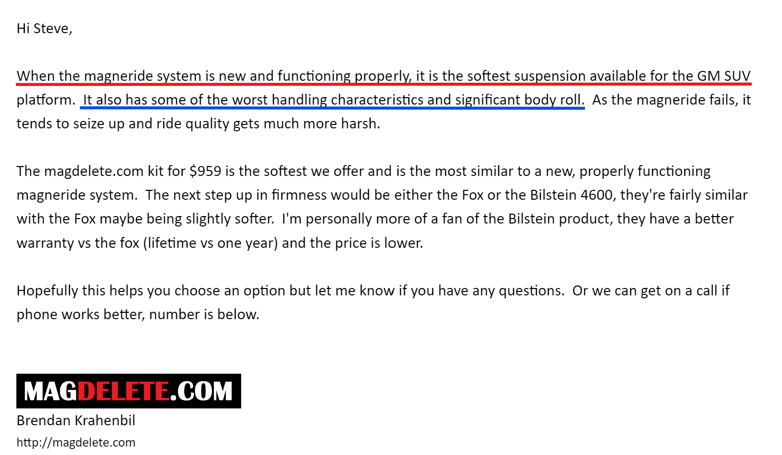

I figured I would write in to MagDelete and ask them directly about what I basically posted in here, which option would have about 75% the stiffness and body roll control as the OEM Magneride. Their response was perplexing to say the least. Is this not completely opposite? The OEM Magneride shocks and springs are much more FIRM than the "premium ride" passive suspension, and the whole point of Magneride is to REDUCE body roll and pitching while having some dynamic adaptability on the shocks. I've always been amazed at how flat the cornering is with this 6000lb SUV, and how little (zero) nose dive there is even in panic stops. It's a night and day difference vs the standard premium ride. What on earth is this guy talking about? The Magneride suspension is super soft and has tons of body roll???? What?
Anyways, totally not helpful and now I'm even more confused. Does not instill confidence in purchasing one of these kits to say the least, even though I've seen some positive reports on them.
