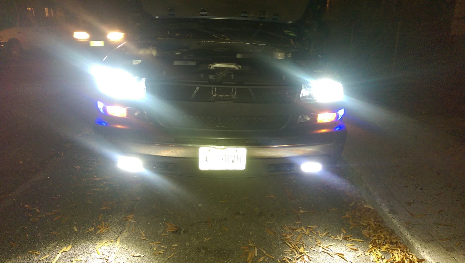

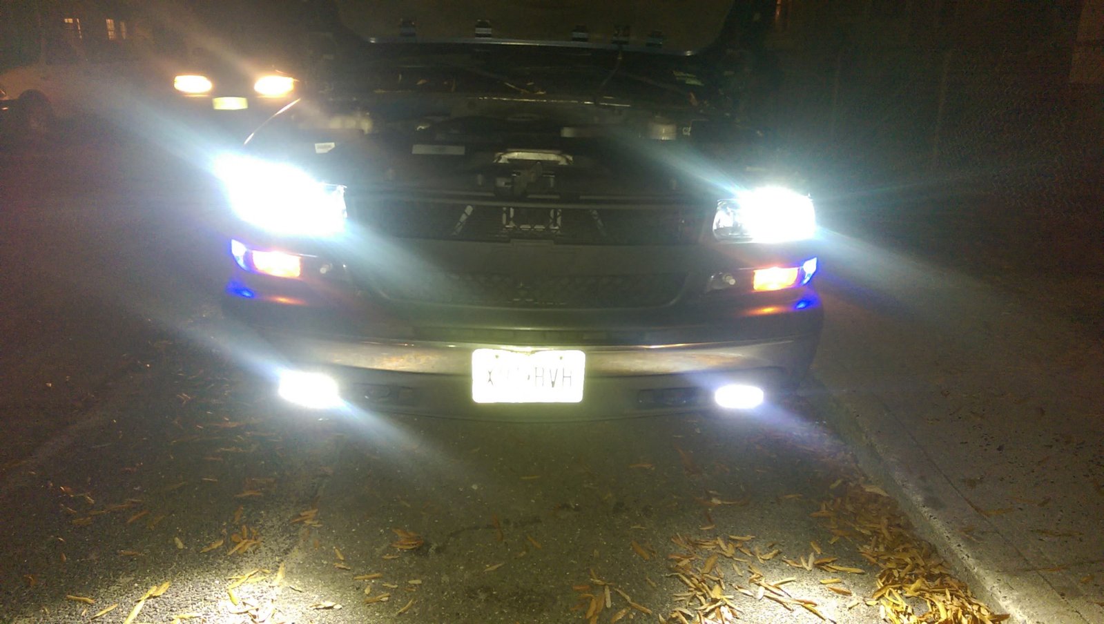

Here's a day shot.

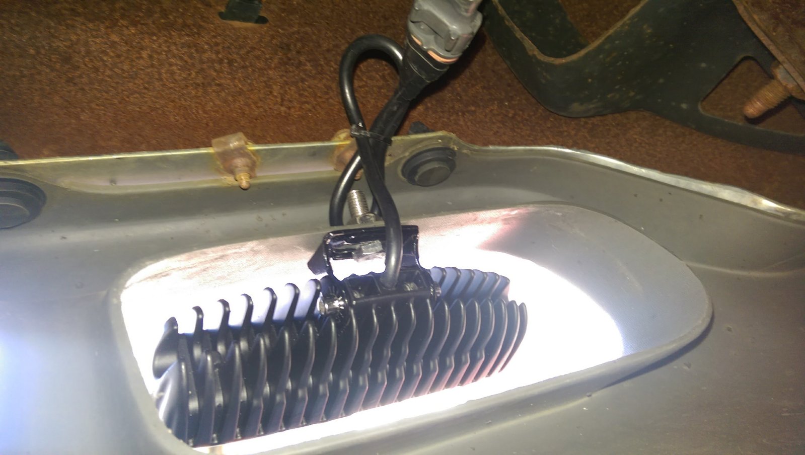

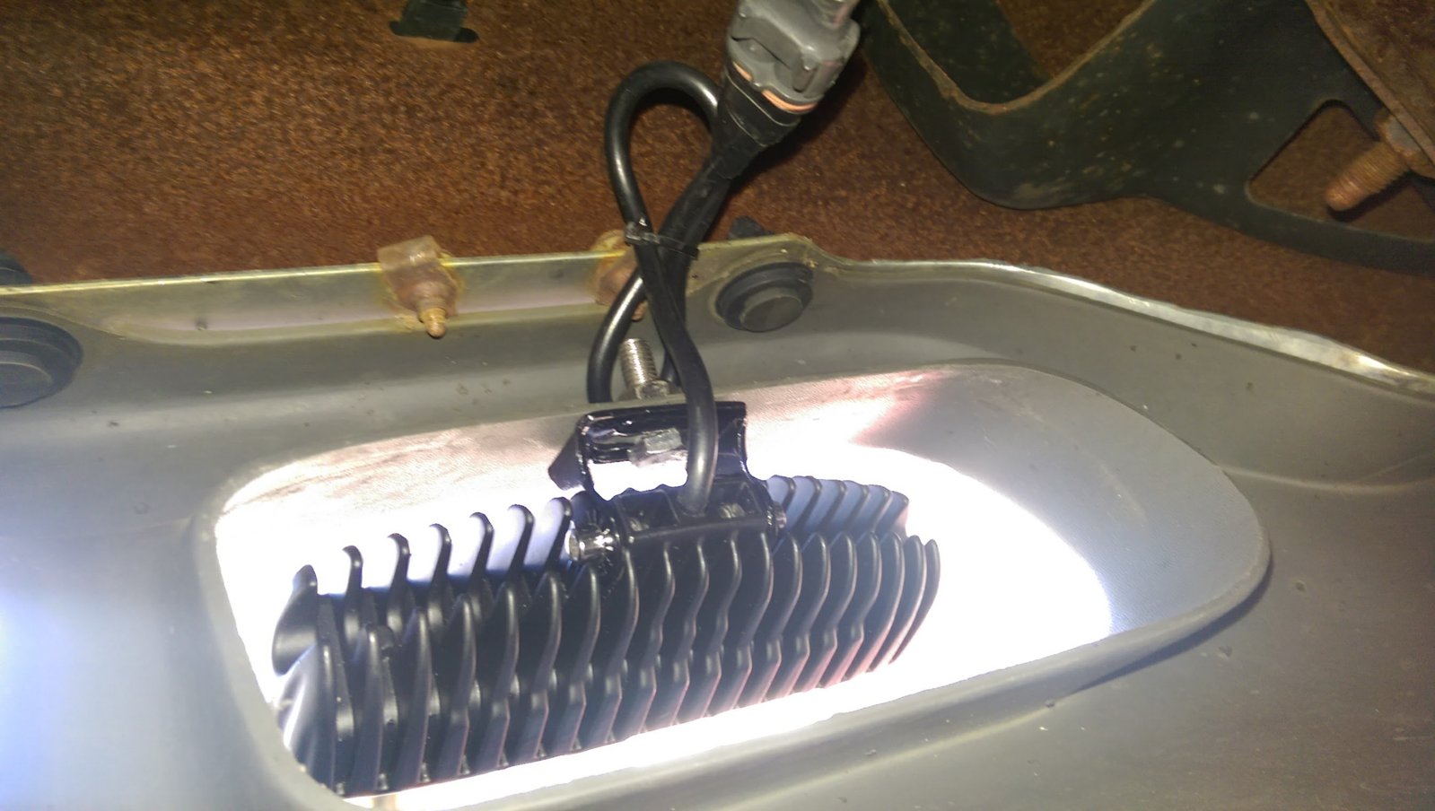

Here's how i mounted mine. I don't use them much, but when I do, I don't notice them shaking/vibrating at all.
Night shot.
Iirc, I added spade connectors to the pigtails coming off the fogs, and plugged them into the factory plug and taped them up really good. It's been 1 1/2 yrs, and no problems yet.

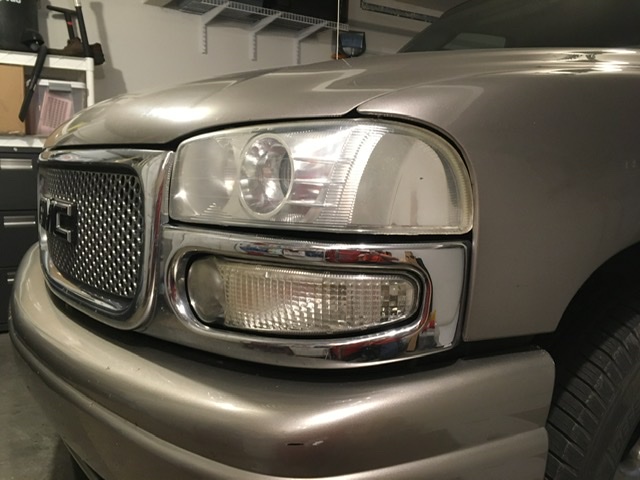

Amber delete. Heat gun, but could be done with an oven, couple pocket screwdrivers, and seemed like silicone was sealing them before, so resealed with silicone. If your bulbs aren’t amber, I guess you’d want bulbs though
