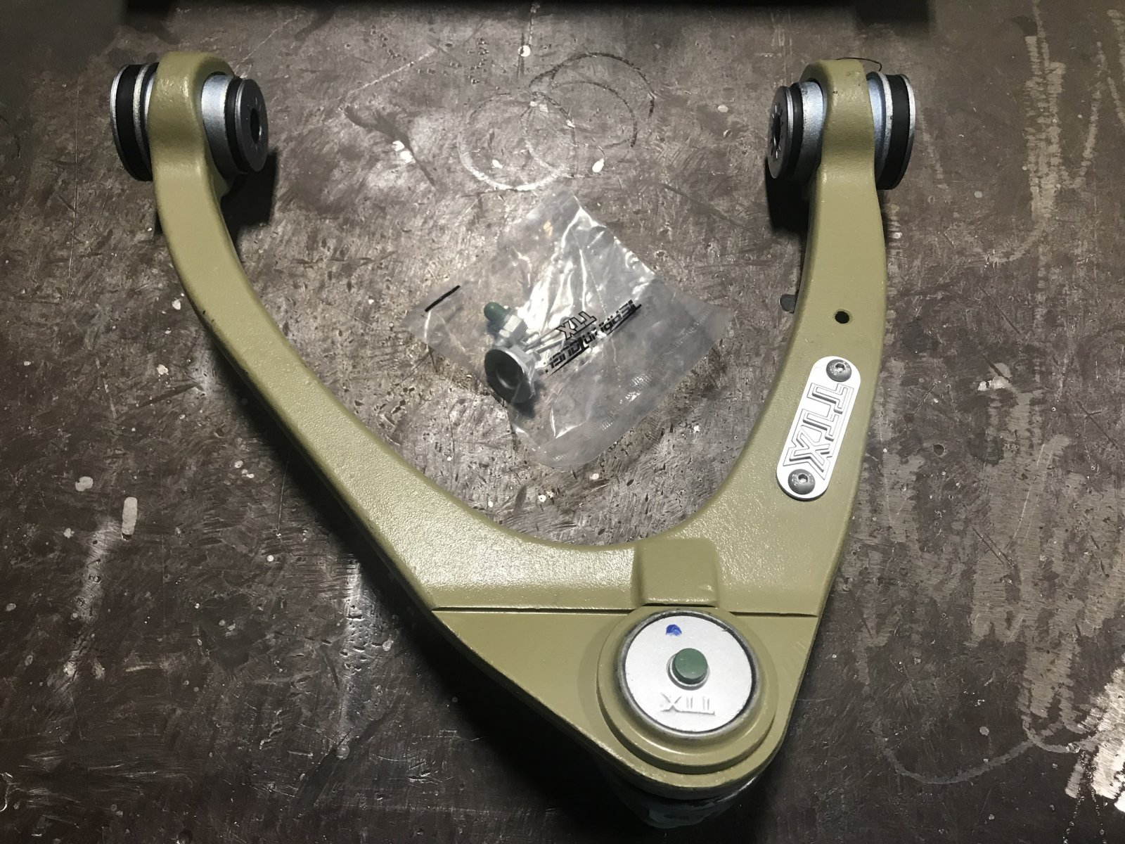

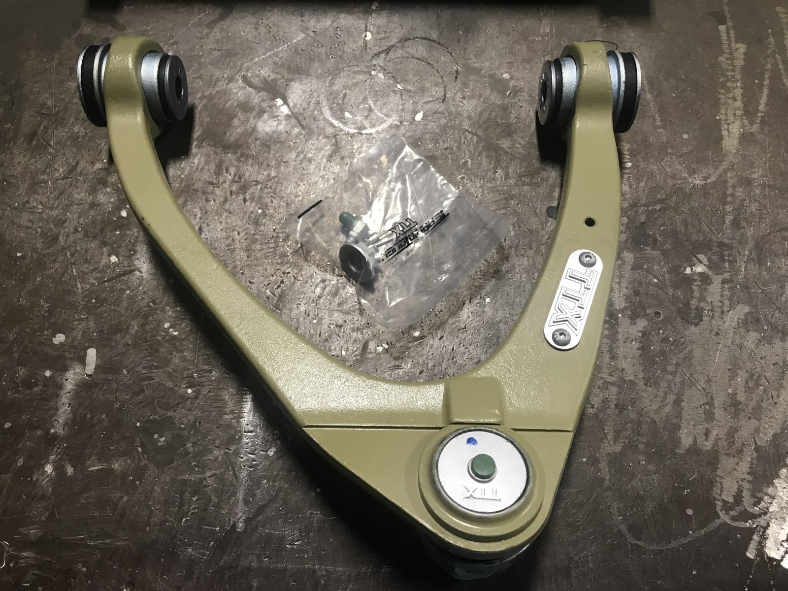

I believe with the drop spindles it is required to cut the ball joint threads for clearance. That shouldn’t be your issue.
only thing that comes to mind that could be a factor causing upper ball joint failure, is the fact that the drop spindle moves the hub bearing closer to the upper ball joint putting more stress on it. It’s always been the lower that takes the brunt of the work and now that’s been changed. I don’t have the drop spindles yet but was curious about this exact thing and wondered why I haven’t seen it mentioned.
I will say, I have these UCAs from Rockauto and they are a very nice beefy unit. May want to try something like this and see if it last a little longer.
I will say, I have these UCAs from Rockauto and they are a very nice beefy unit. May want to try something like this and see if it last a little longer. View attachment 281480View attachment 281481
Those look nice. If I was keeping the truck I'd try it out. Everything is good for now.

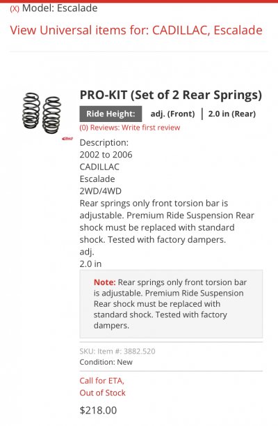

mcgaughys spindles I have also no issues at all 2+ years all moog and Delco parts .. I do keep it greased also every 3-4K miles .. I do have adj keys and eibach springs

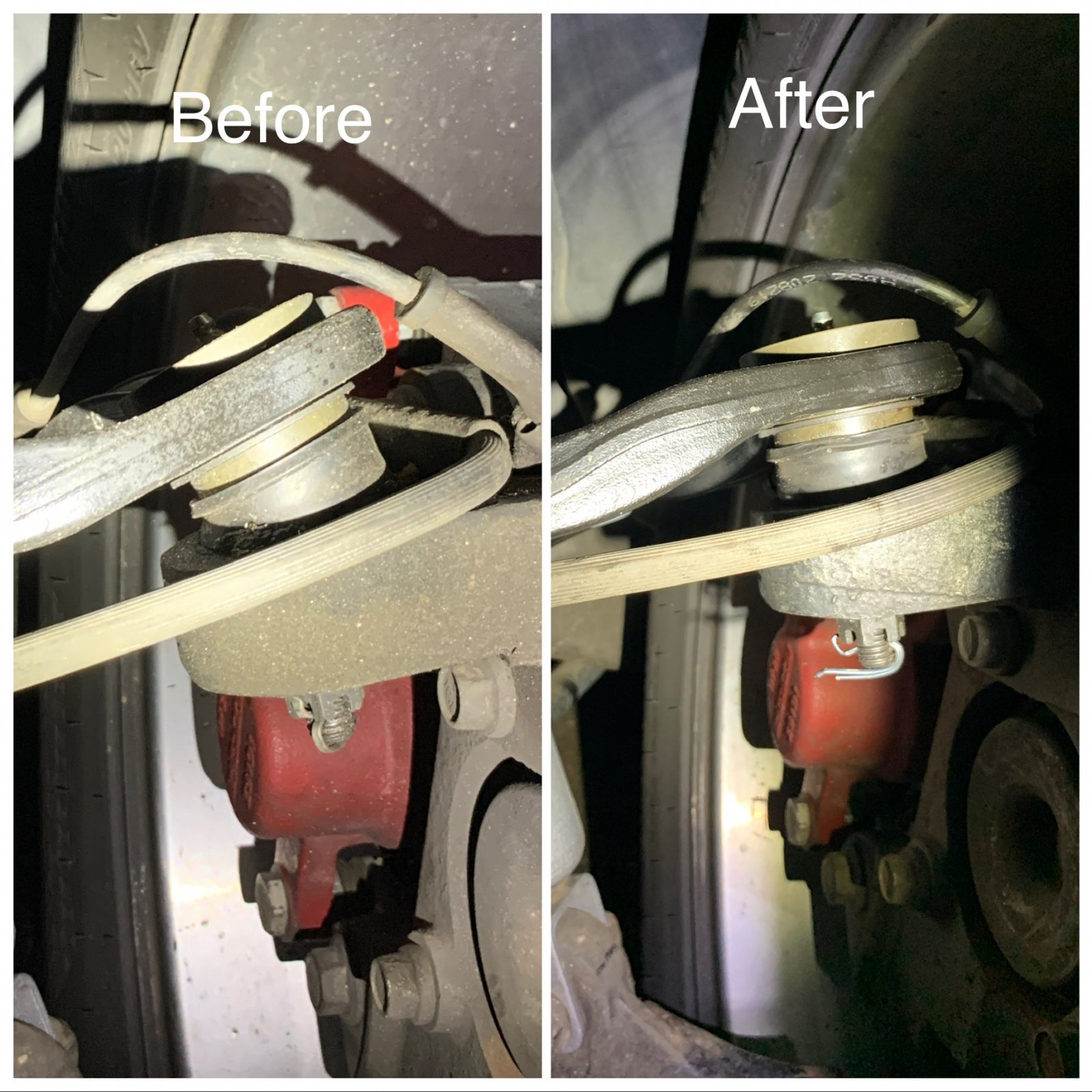

You need to flip your upper control arms over, and press the balljoints out, and flip them over.
here are the results.
I am no longer running stock arms, but here is stock style arms with moog balljoints.
I don’t think you’ll have to cut the threads to clear the axle either.
hope this helps!
