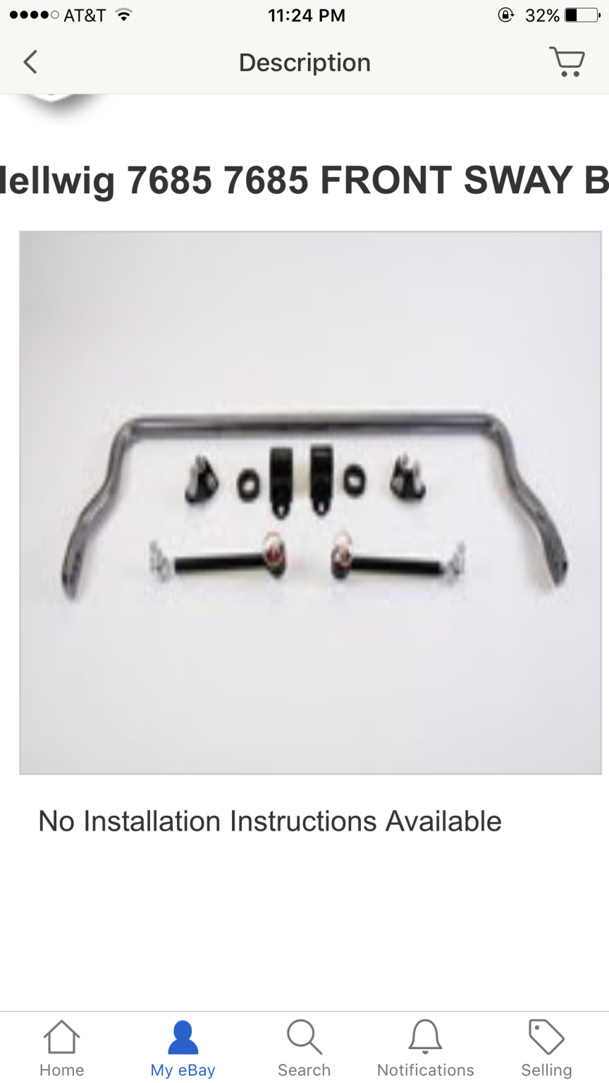

just got hellwig front and back swaybars. i have a belltech 2/3 drop with djm endlinks, am i going to have any issues with these endlinks? btw good deal on hellwig bars on ebay
The DJM will be fine for the rear. I'm running their swaybars front and back and their rear endlinks. They should work good with the Hellwig but you'll need to buy Energy Suspension endlinks for the front, they sell all lengths. You can look in their online PDF catalog, under universal applications. There's instructions on how to measure and get the part numbers. I installed my stockers , then measured and ordered new ones and replaced them when they were delivered.

the ones that come with the swaybar eill not work? this is the one that i got
Unless they're specified for a 2" front drop, then no. Your swaybar won't be parallel with the ground which is necessary for it to work right. You can install them and check to see but I'm sure they're stock length for a non lowered rig.
thank you bery much for the help
