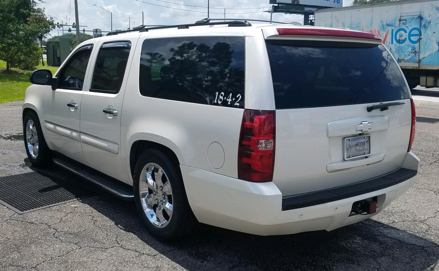

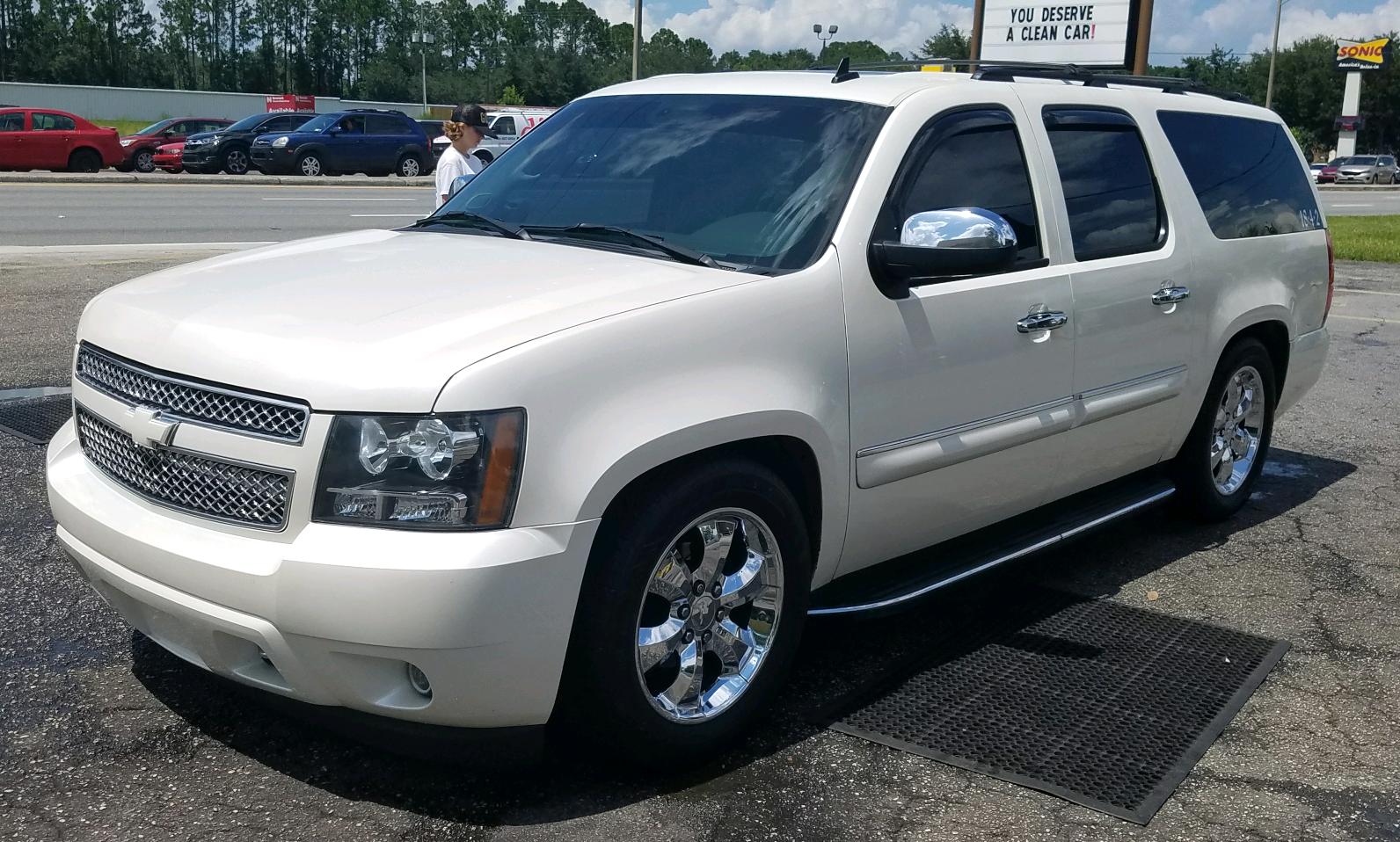

Mine on the alignment rack right after lowering...
And a couple more recent...
Let me know if you have any more questions.
