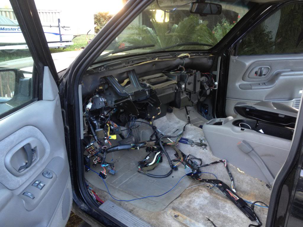

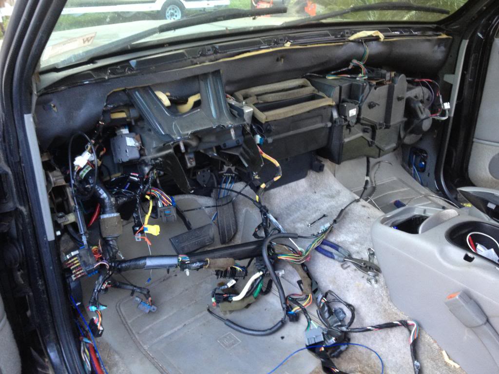

Ok got all the tranny parts ordered and on their way. In the meantime Im taking out the dash to fix the AC evaporator and Ive run into a little problem. I was following another thread on the dash removal and I've got it basically all the way apart, all trim and dash pieces and panels have been taken off and the big piece under the steering wheel is off and the two bolts next to the kick panels and all the vents and gauges. It's loose and ready to come out and from what I've read it rotates forward into the driver seat and but I don't see how that would be possible with the steering wheel and column still there? Do you have to remove those to get the dash out? It feels like the dash is still getting hung up on something but I can't find it. Going to work on it tomorrow so any help is appreciated. Thanks!

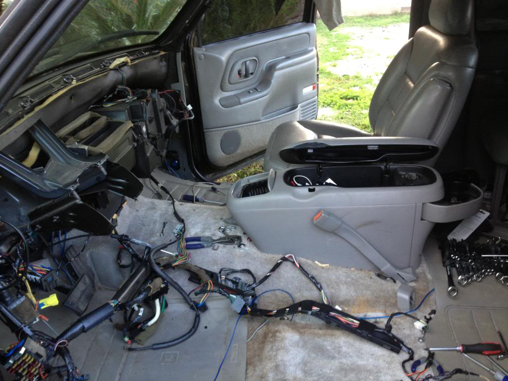

I was able to get the dash removed, definitely had to remove the steering column. I dont see any way around not removing it. I also removed my driver seat for ease of access but not sure thats necessary. It was bigger job than I expected but over all it wasnt too bad for the first removal. Now that Ive got the whole dash, steering column, and all the A/C vents and tubes removed how do I get to the evaporator and go about replacing it? Also, is there anything else that I should replace or check while I have everything apart?
