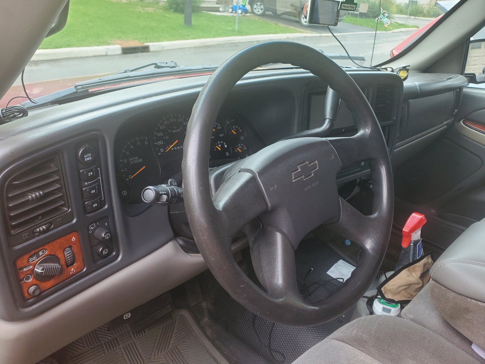

I have a 2006 Suburban 2500. Happy with this truck. I am looking into changing some settings to addin the better steering wheel (Phone/Radio/DIC controls) but I know that unless my BCM "Understands these features are on" it will be just a big pretty useless decoration.
My Dashboard does have the DIC but it of course only displays Odometer, Engineer runtime and a single trip meter.

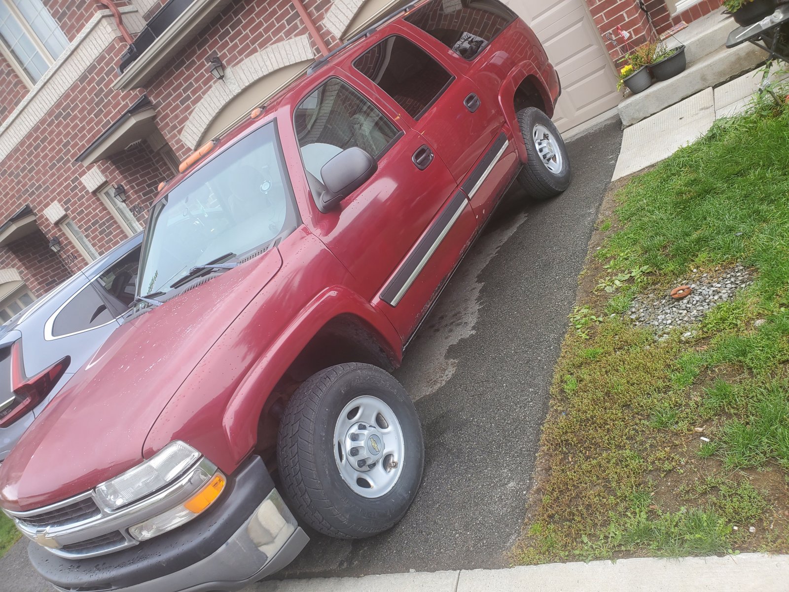

Pics are in my intro but I don't mind sharing again :)

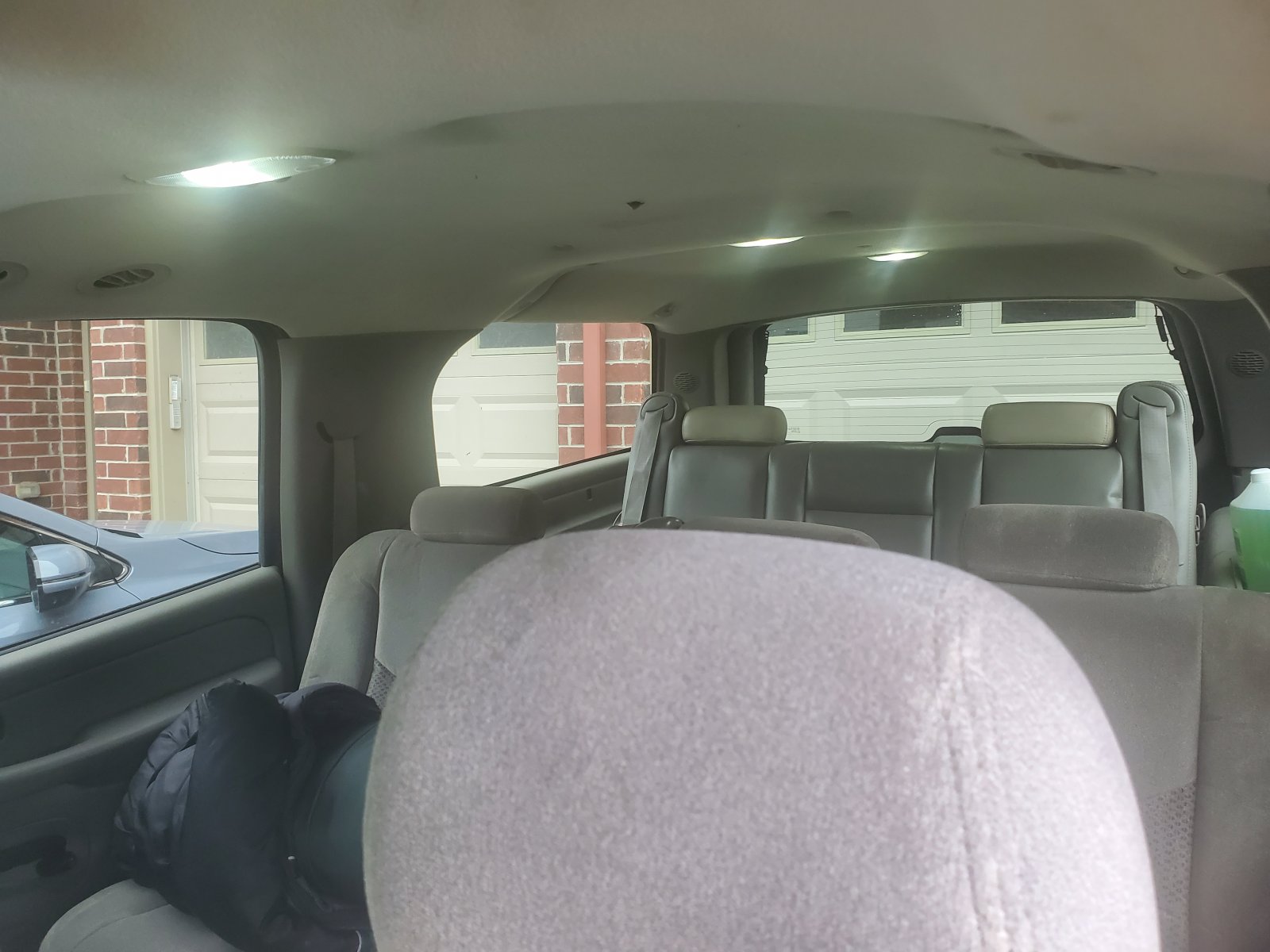

If you look in the back there is the 3rd seat I got for free (Some grey leather thing) that a mouse might have gotten to. Internally it's clean an un-eaten but the original headrest was "snacked on" somewhat. So that will be my task in October, order in the proper covers to match my Greyish Velour seats
...and that little Orange White mixup is one of my two 2006 Smart cars. No I looked, I don't it will fit in the back of the Suburban ;)

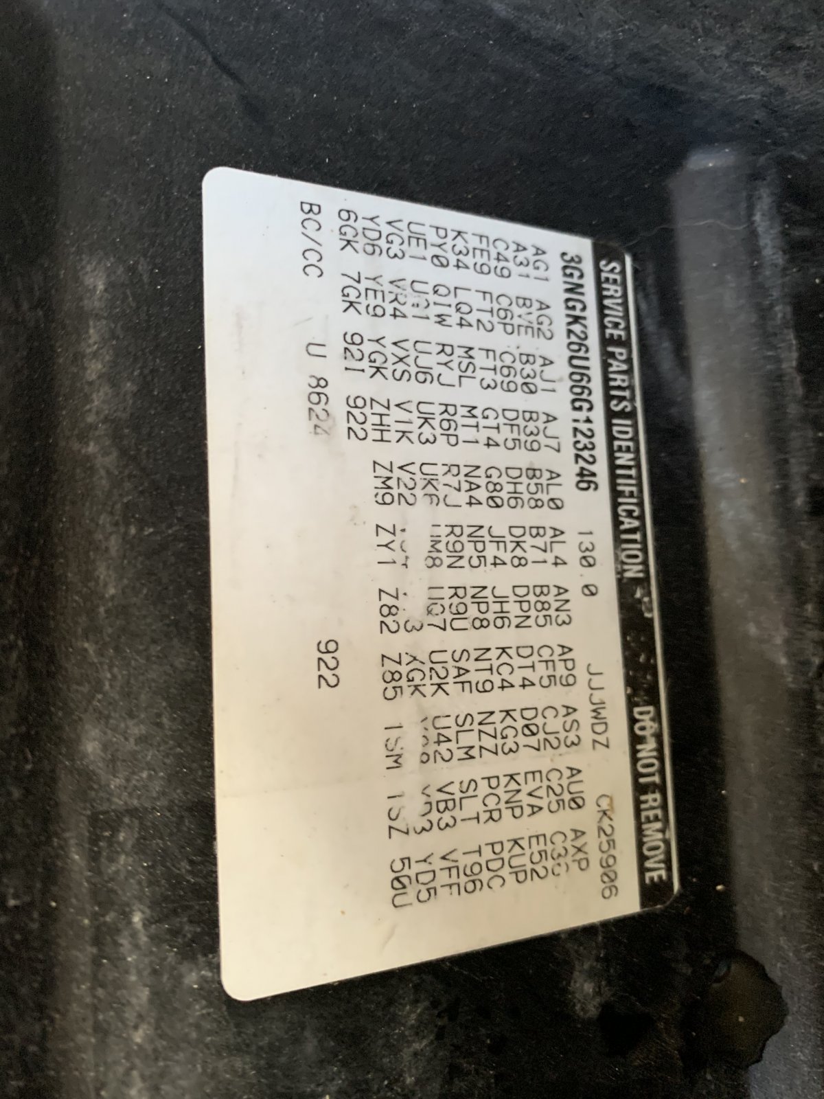

So quick question more specific, if we have a "list" is there a particular group I should ping to find a list of "options" for the BCM? I think I've heard the term PCO or something option codes?

As for options, you must be thinking RPO list. Anyway, to add steering wheel controls there is a procedure as far as programming to the BCM besides adding the controls and changing the clockspring but I’m not sure what it is. There was a thread here recently. Hopefully somebody with more knowledge will chime in, or else do a search.

If this would be useful to anybody in the forum, I translated the PDF file with all the RPO codes into an Excel sheet which allows you to drop in a list of RPO code on the "Source Car Sheet" and translate their options.
I left my truck in their as an example. I thought it might be easier to "snap a picture" of the options from a Glove box to determine what had been enabled in one vehicle vs another to determine what you Might want to turn on

You can’t just “turn on” RPO’s by programming them into the BCM. You need to use a VIN from a vehicle with the RPO’s you want. The Tech2 uses the list of RPO’s associated with that VIN to program the BCM in your vehicle.

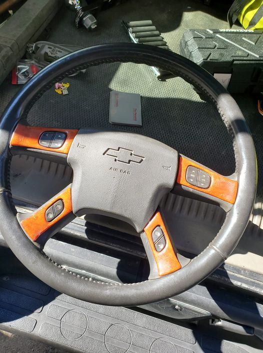

Future upgrade for my 2006 Suburban 2500. Pulled from a 2003 Chevy Tahoe (and yep, I've used some of it's bits to put other woodgrain in the truck. I kinda like it :)

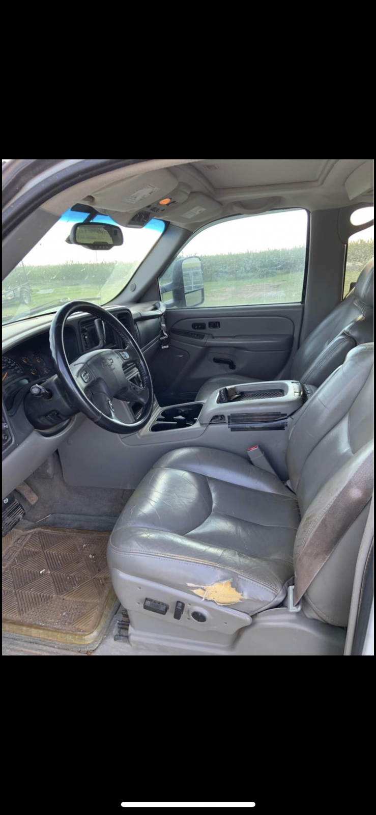

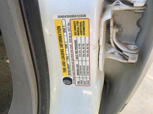

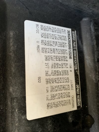

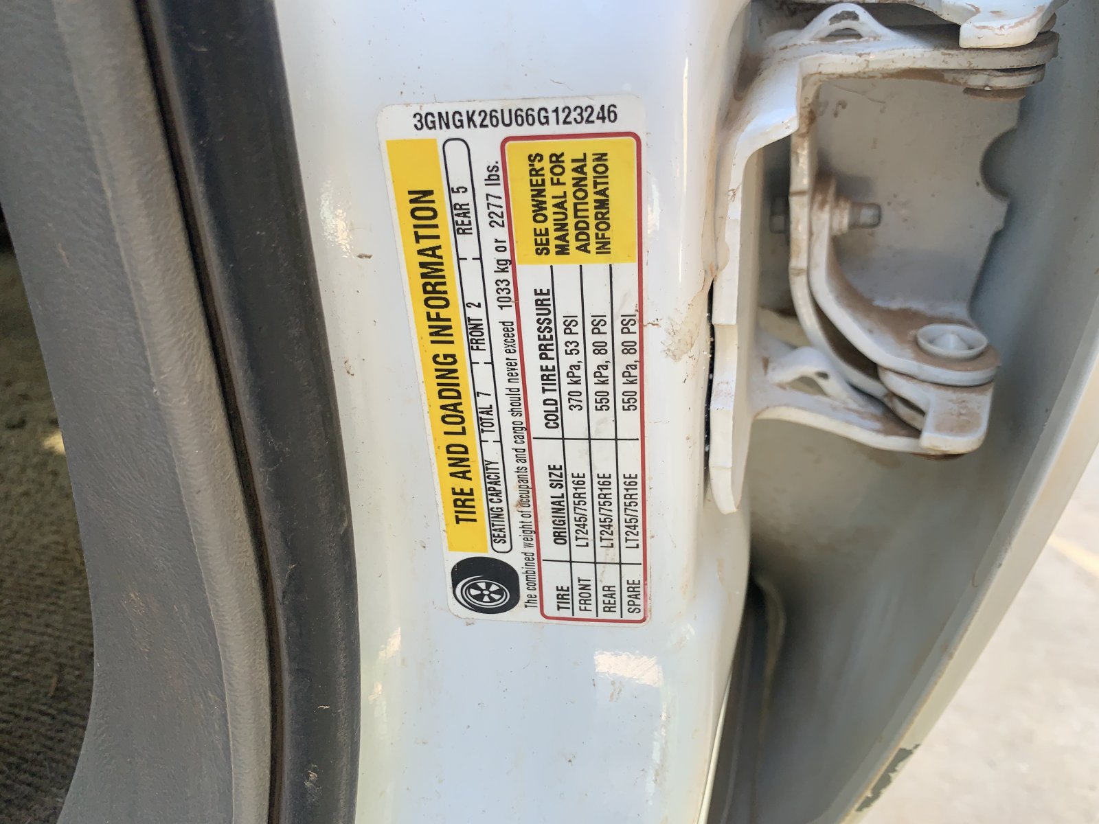

I’ve actually got an 06 suburban 2500 with those extra controls.
Feel free to try my vin
I also have a VCXnano that can do tech2 emulation. It’s a little tricky to set them up and you probably want to use it in a VM (slightly sketchy Chinese software lol) but can’t beat it for $120
