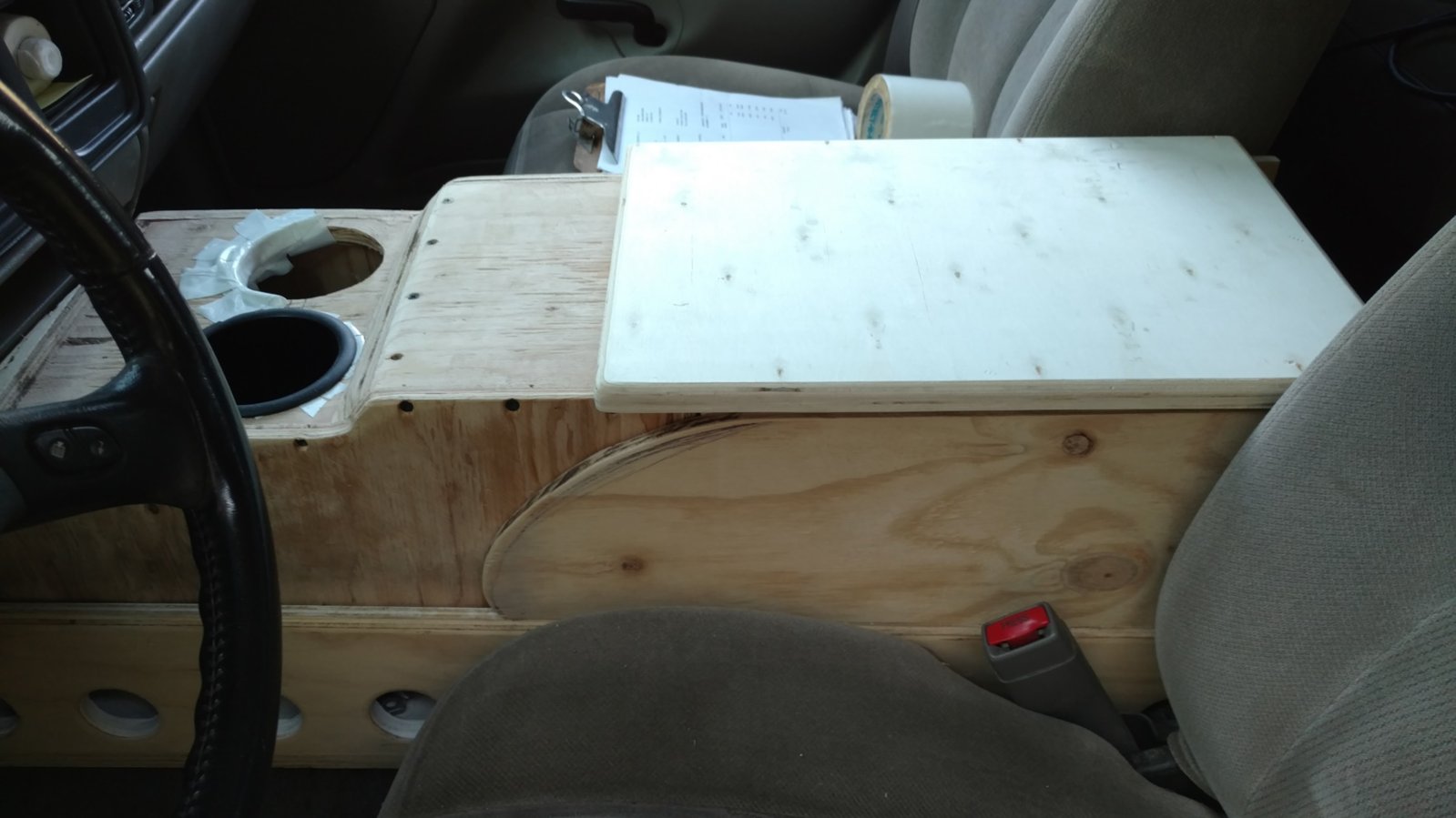

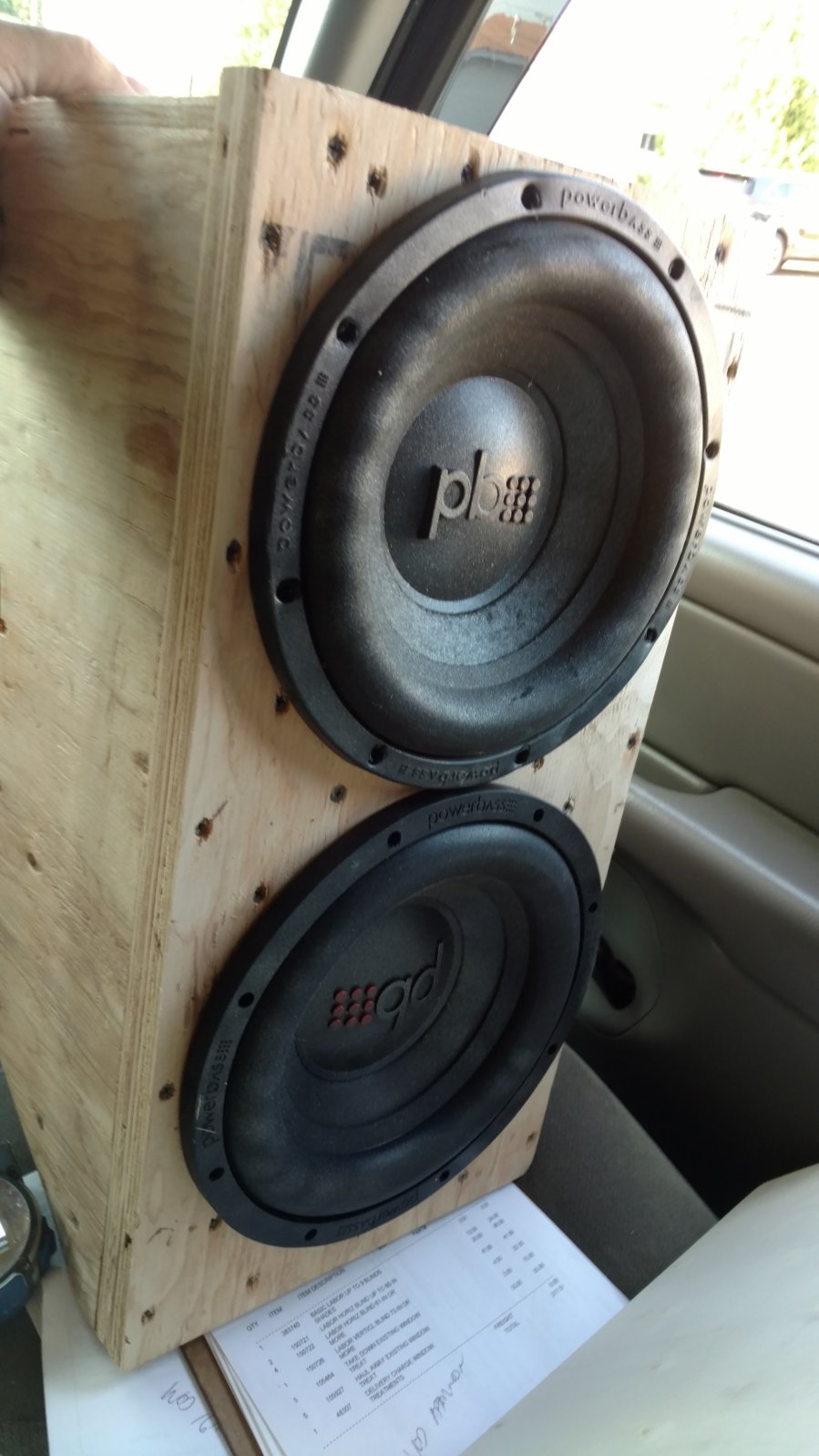

Took out my center jump seat in my XL, made a new center console. Two 10" subs in the front portion, sealed at about 1 cu ft - using them more for midbass (60-150Hz). Upper portion has been covered with carpet, have to remove the entire thing soon to wrap the bottom in vinyl.

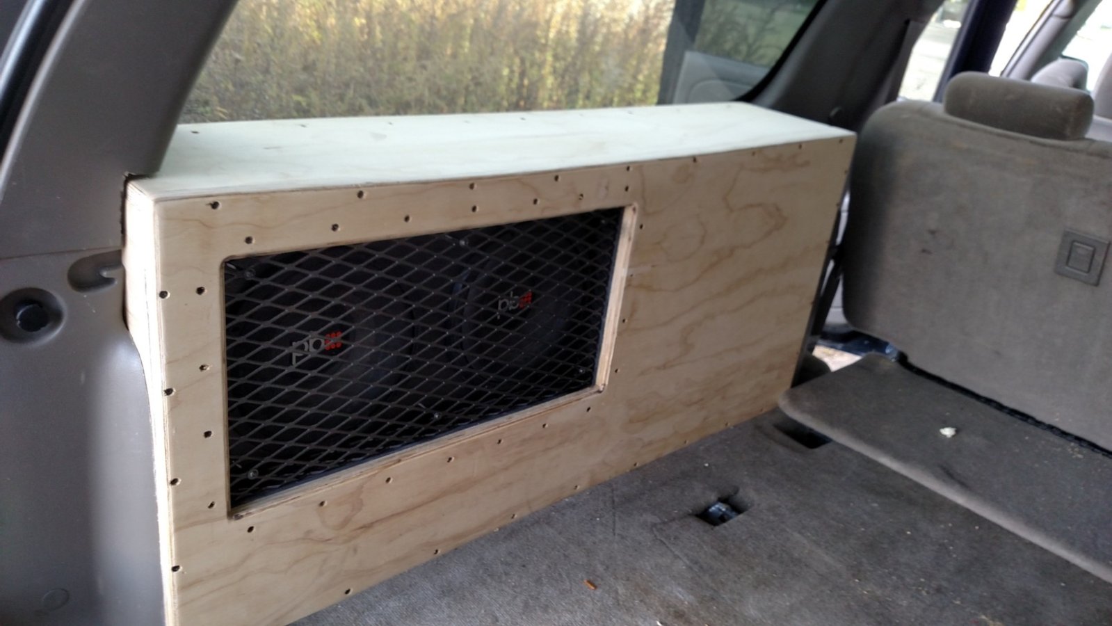

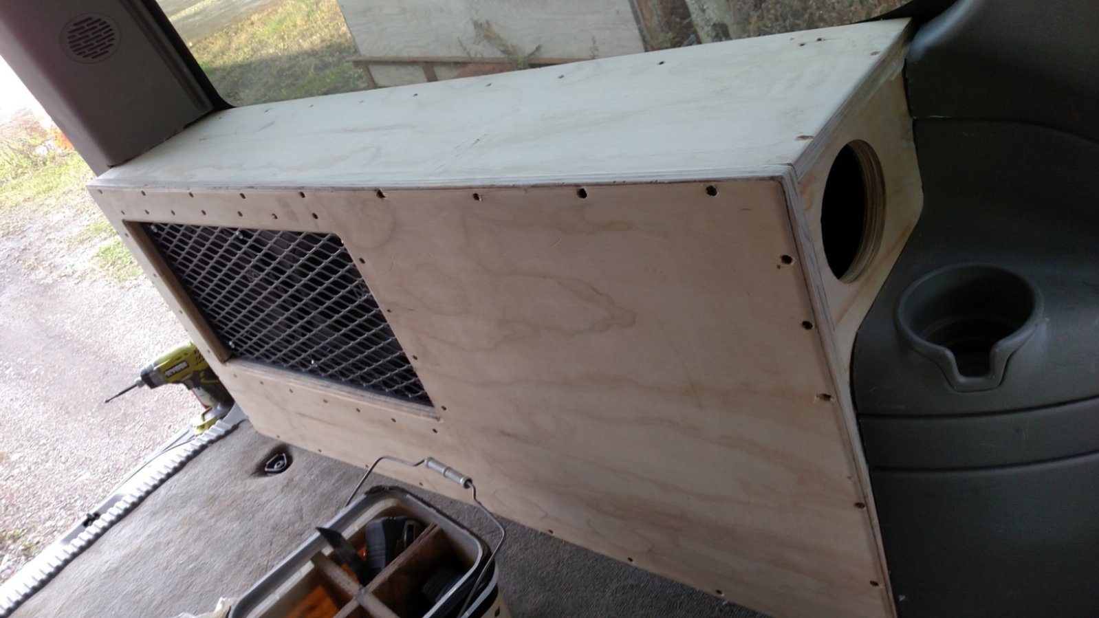

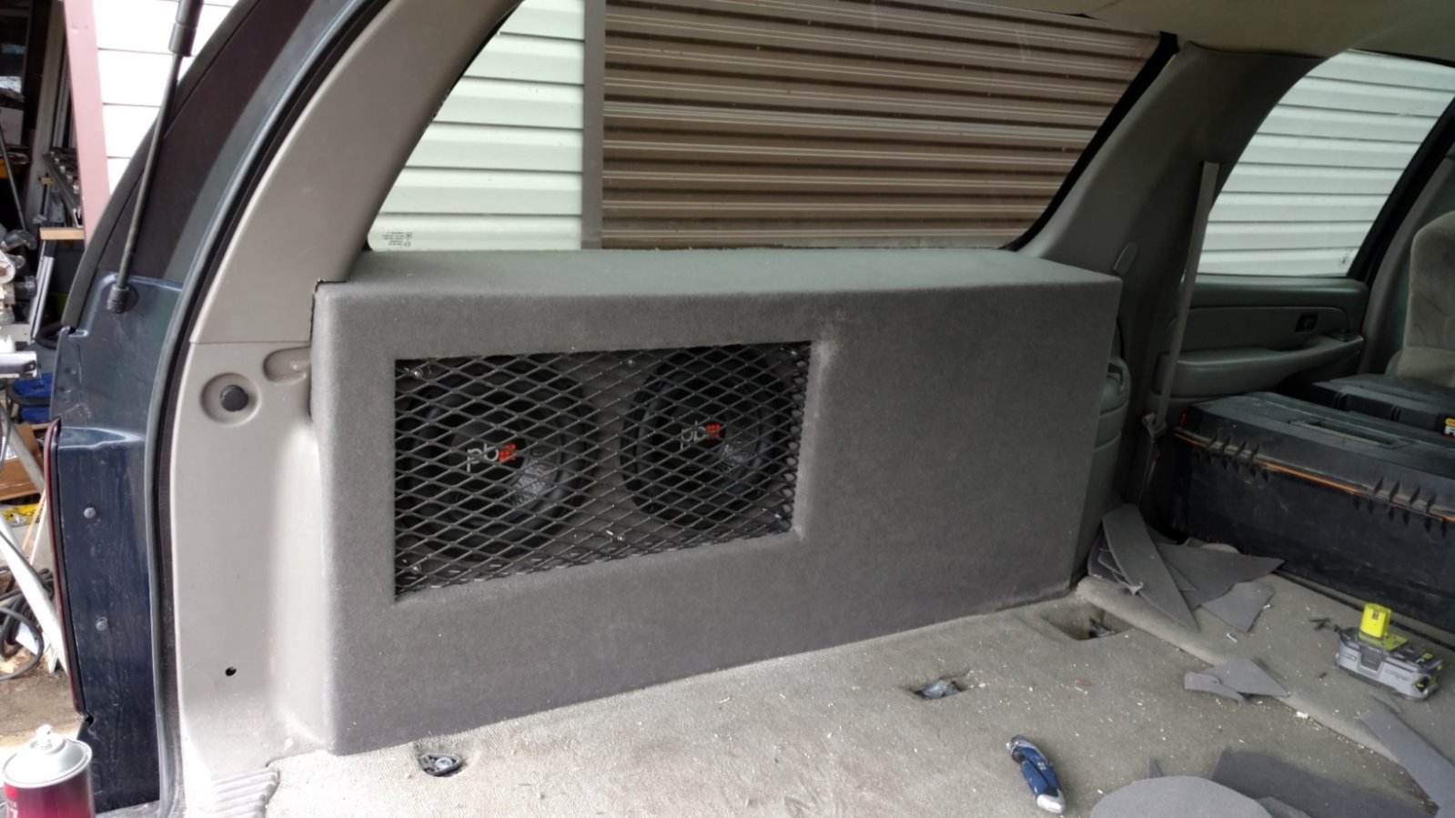

And then I have my other two 10's, fabbed into the rear quarter panel where the stock sub would be. Cut the interior trim panels down, made the box, and carpeted it afterwards. Just about 2.6 cu ft, tuned to about 28Hz - would rather give up a few dB's and have more control over the subs (not using a subsonic filter).
