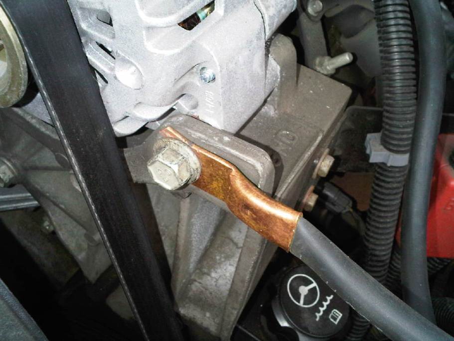

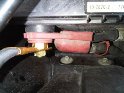

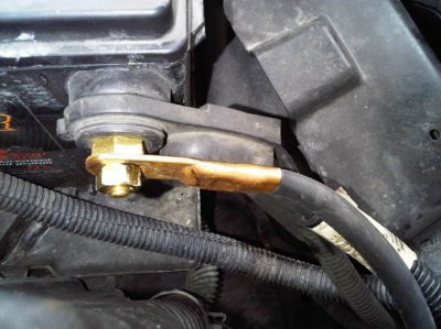

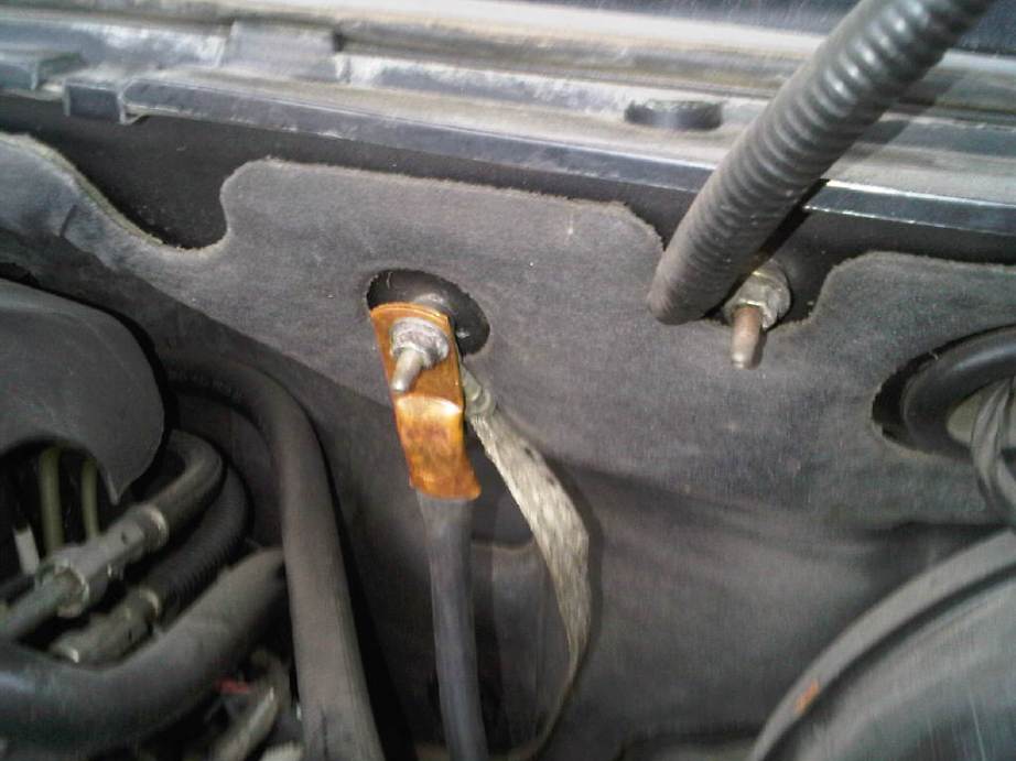

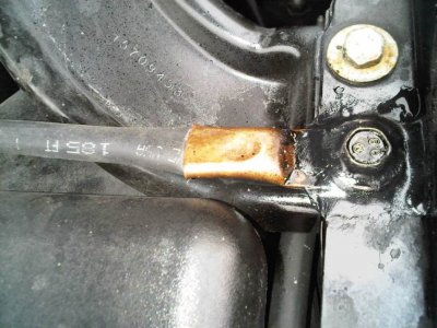

Here's my rendition of the Big 3 installed yesterday. I used 2 guage welding wire and copper end's. It's bumped up my voltage just a tad.
Stereo install to come...

Looks good. Just make sure all the grounds are sanded down. I'd just double check that stock ground thats on the firewall.
