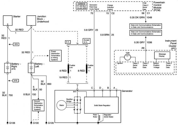

From what I found the 04 model should only have 2 wires going to the alternator Pins B and C then of course the BAT terminal as well. You can see in the schematic what B and C go to. What is the purpose or need for the bulb to drop voltage on the 3rd wire? Brown according the schematic should goto your PCM and that is essentially the signal to the voltmeter. So what is your extra wires hooked too and which terminal is sre they coming from? A or D? @Doubeleive @EfiniMotorsport

When looking at the alternator from the front the left 3 pins have wires. The second pin from the left is the brown wire.

I'll have to see what the other 2 wire colors are when I get home. I don't remember what the production month is or if it would be different on the 03

I don't know if it's an early 04 that has something held over from 03, wiring wise. The alternator has a 4 pin 3 wire plug.

Also have code P1637
CIRCUIT DESCRIPTION
The powertrain control module (PCM) uses the generator turn on signal circuit to control the generator. A high side driver within the PCM allows the PCM to turn the generator ON and OFF. When Generator operation is desired, the PCM sends a 5 volt signal to the voltage regulator via the generator turn on signal circuit. This causes the voltage regulator to begin controlling the generator field circuit. Once the Generator is enabled by the PCM, the voltage regulator controls generator output independently of the PCM. Under certain operating conditions, the PCM can turn Off the generator by turning Off the 5 volt signal on the generator turn on signal circuit. The PCM has fault detection circuitry which monitors the state of the generator turn on signal circuit. If the fault detection circuit senses a voltage other than what is expected, this DTC will set. The voltage regulator also contains fault detection circuitry. If the regulator detects a problem, the regulator will ground the generator turn on signal circuit, pulling the voltage low. This also causes the PCM to set the DTC.
