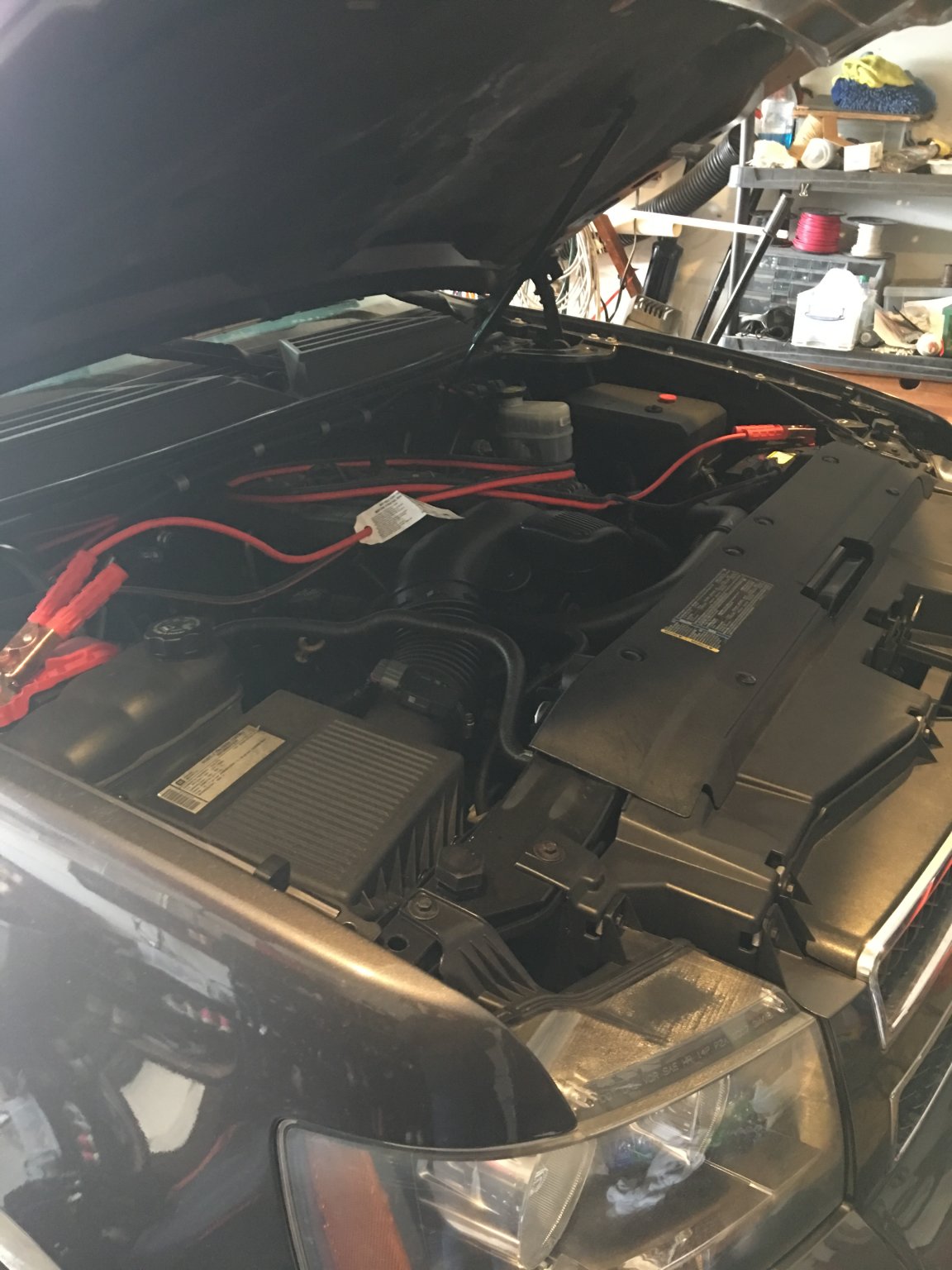

this is how you connect them ...right ?

Looooooooooooool looks good to mee hahahahha

For 2007 to 2014 Tahoe PPV, the OEM dual batteries are connected in parallel, no isolator relay. It should be a simple job.
Started from 2015 PPV, the dual-battery are connected in parallel with an isolator relay. When the engine is not running, only ONE battery supplies electric to all accessories.
That's how our '12 9C1 Caprice is wired. I have a small secondary battery on the passenger side to serve as a jump start source should I ever need one.
