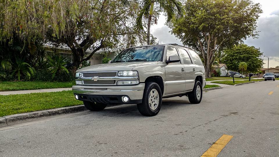

Nothing happened really. Gf hasnr done much but drive it really. For Christmas I got her a pioneer double din. She had a rear main leak so we got that fixed and now ive been trying to look around to see what the best basic 6/7 inch lift will be. Just want one that'll clear some x12s and 31s or 33s easily. Truck needs new shocks for sure so rather just lift it and put new shocks on then.
Untitled by James Pate, on Flickr

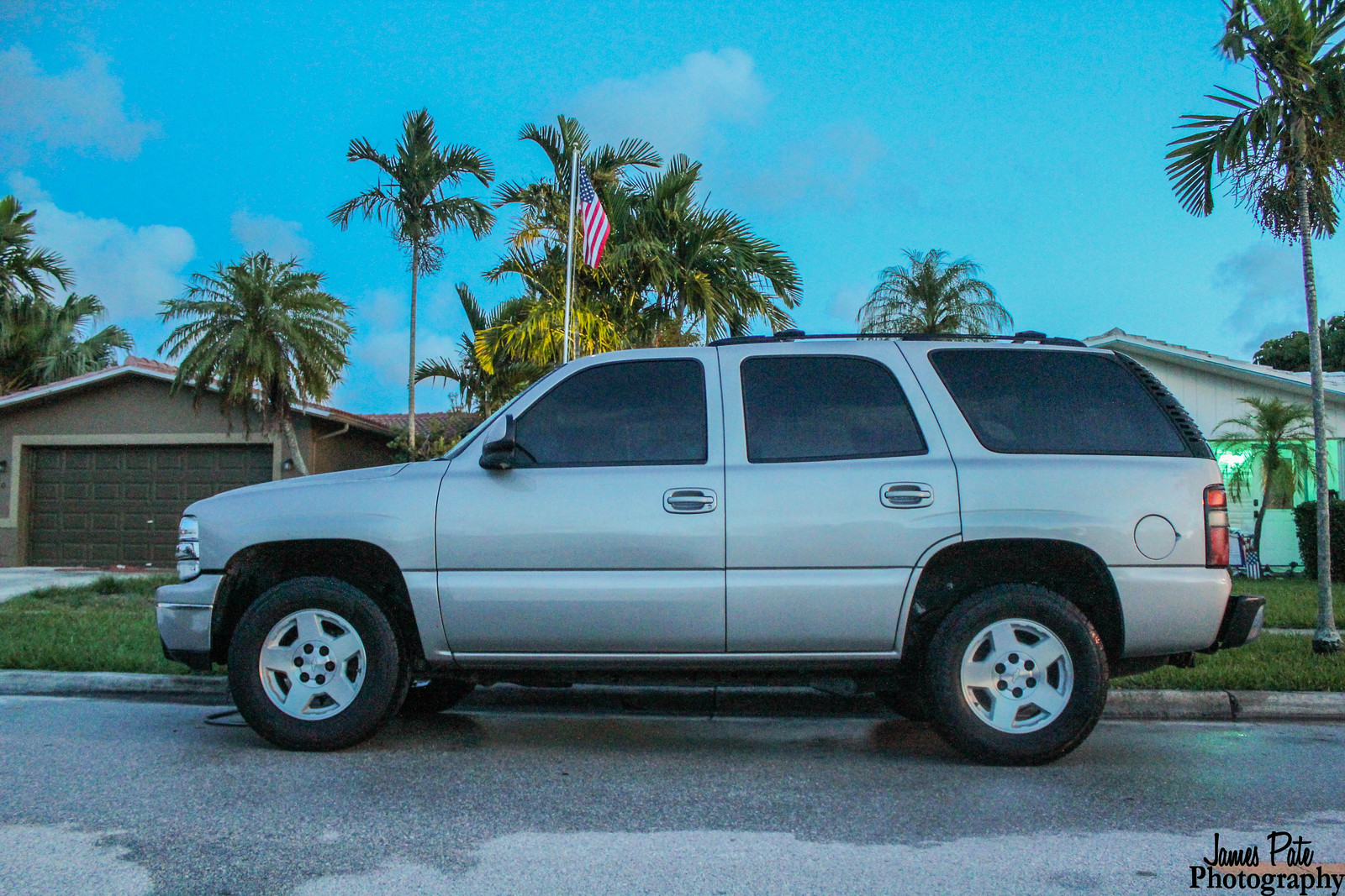

Small update looking at getting all new bilstein shocks but decided to take the money we were going to put towards them and going to get a 6 inch super lift. Also got some 16x12 scorpios that I'll run with adapters and probably end up running 265/75r16 nitto terra grapplers.

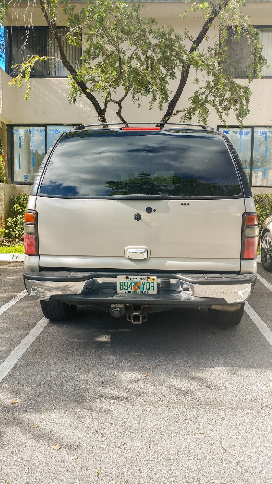

Thanks was rushing on pics cause it was getting dark. Going to try for better ones tomorrow.

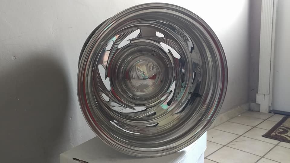

Not sure your plan on wheels buy they make a chrome clad cover for those that actually look super clean.
