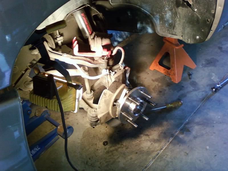

I go to test drive it and i keep hearing a pop and its jerking my truck every time i hear a pop as well a grind, so again im like WTF now. Turns out some how the front hub assembly back cap came off and was exposing the bearings and the dried out and was making the crunching, popping and grinding noise, so after being up till 3 in the morning plus having to wait till the part store opened the next morning then finally taking installing the new one then finally getting to leave to head to a big car show called SICNIK in Gonzales, LA all this crap in one evenning

I have NOOO CLUE! it was the factory hub assembly so i guess it was old??? lol

both my hubs will be changed within the next few weeks. i have read that the hubs on these trucks tend to go bad just like the steering boxes and shafts.

towing was free (AAA) pulley was $16, and hub assembly was $140 i did all the work myself so $156 total
