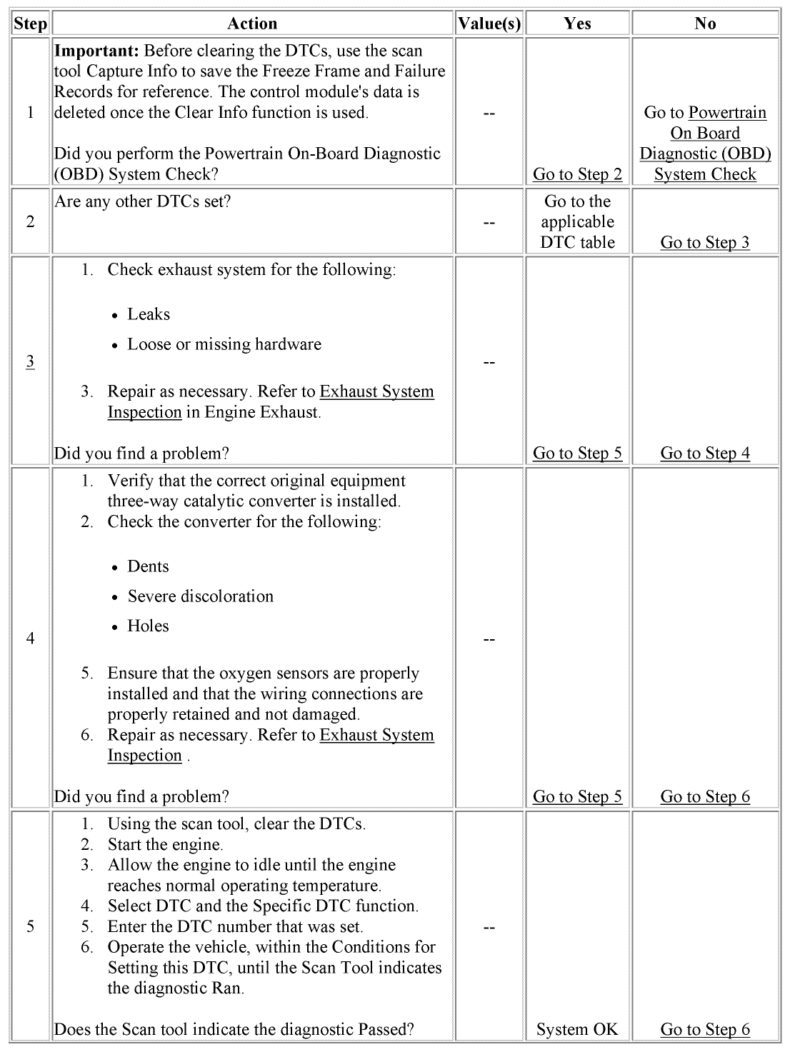

Here is the GM diagnostic table for P0430. I thought it might help but it looks like it was written around a Tech2 (step 5).
