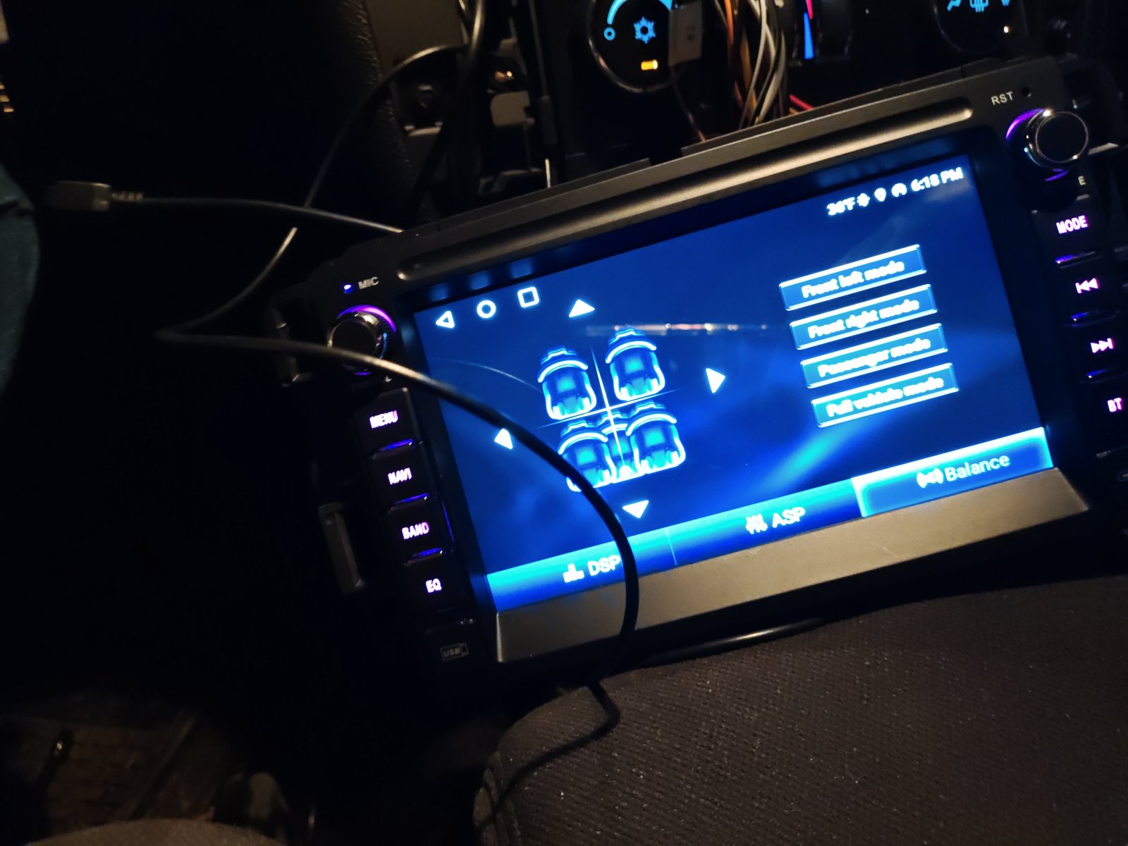

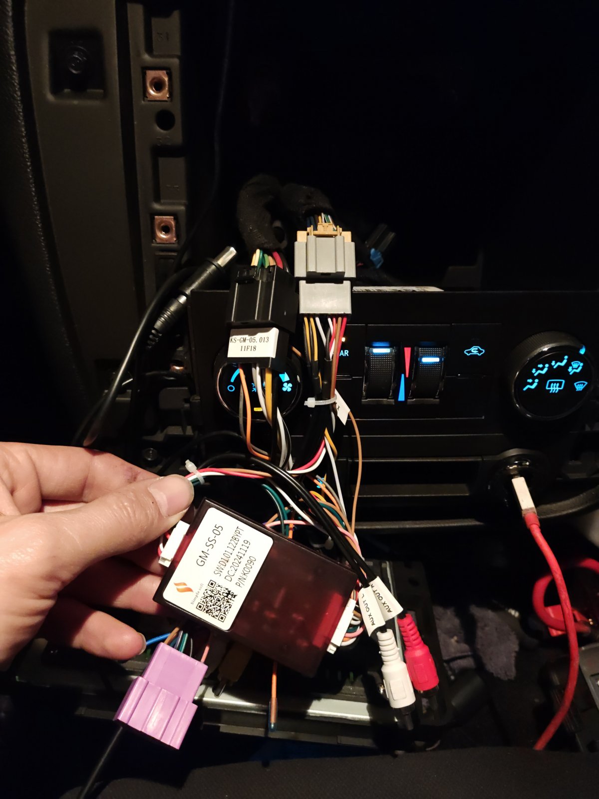

I got a new radio in my 2010 GMC Yukon SLE
And my back speakers are not working at all the only speakers work are the front and I have no clue how to fix this.. anybody know how to help ?
Anyone know what that blu/bull plug is ?

Am I correct in assuming that the rear speakers worked before the change? What interface module did you use to connect the head unit to the truck's wire harness?

Does anyone know if it uses a amp for the back speakers and do I have to run a separate wire to trigger it to get my back to speakers I mean all my front speakers work perfectly but I've seen some videos where it's kinda common for people to have problems with the back after a new radio install

1st step is to take that skyframe adapter and throw it in the garbage and get a proper adapter, then everything might work, might depend on that radio as well
