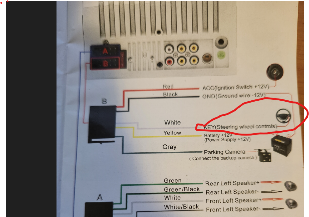

So I may actually be unsure if I have the steering wheel controls from the head unit wired right. In the photo below, the top left tells how to wire the black, red and pink wire. I have that done correctly.
However, in the picture below, the white "KEY(Steering wheel controls)" wire I have connected to the pink wire in pin A1 as well. Is this incorrect? If so, what is the proper wire to connect that too from the car harness?
