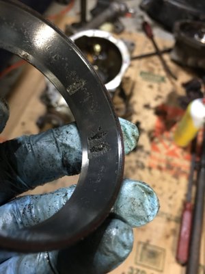

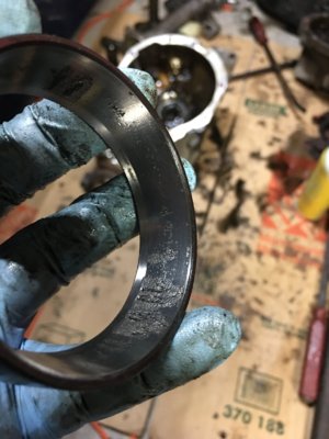

My carrier bearing outer races were toast when I rebuilt my front diff
