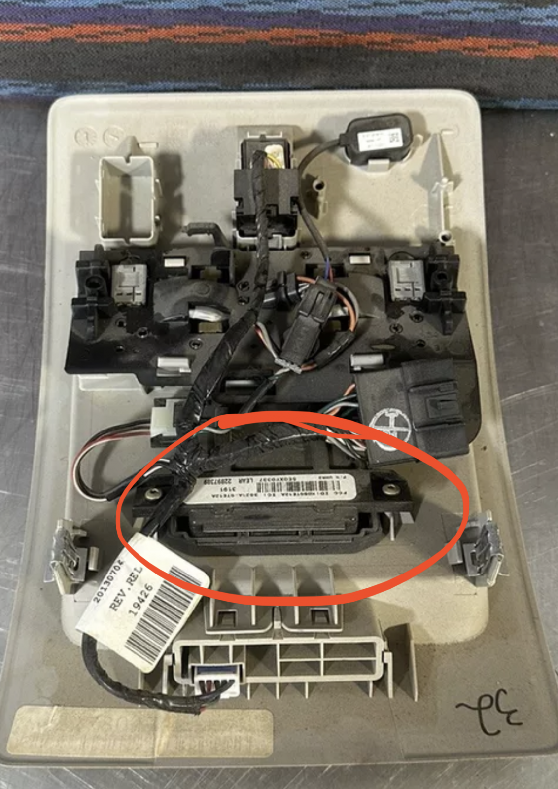

This switches are part of a bigger module. You would have to tear the module apart and see if you can rewrite them to power something else.

I believe I have heard of someone disassembling the unit and placing switches behind the original buttons so you can keep it 100% stock looking..
Or find some good looking switches that can install in the same spot..
I was thinking about moving my ditch light switches to the overhead console as well, but maybe on either side of the liftgate switch.
I don't have a sunroof, so I can use those switch areas..
