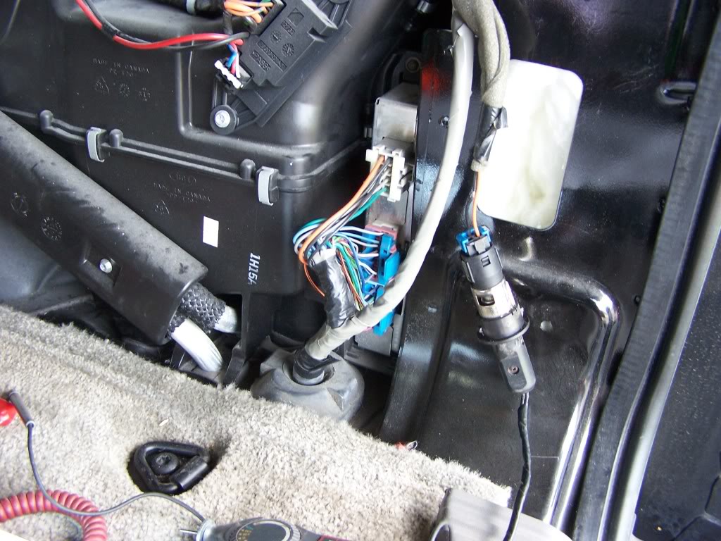

I want to inspect the SCM. Any pics of the exact location? Right now I am picturing the area where there is a rubber plug and a bunch of wires coming into the vehicle. If this was the drivers side, it'd be exactly where the factor sub is.

On the inside of the vehicle, in the rear cargo area, directly across from the sub and/or jack location. Here is what it looks like with the molding removed... You shouldnt have to pull the molding all the way off, just enough to get to the SCM (silver box)
BTW- I have an extra SCM module for sale since my problem turned out to be the harness.
