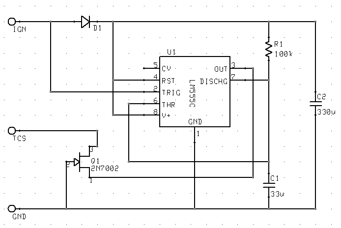

Pretty simple circuit. I designed and built one for the TCS on my 2002 Trans Am so the traction control would be off by default. I just created a delayed pulse circuit to replicate pushing the button right after starting the engine. $100 seems pretty expensive for what is about $2 in parts. It's simple enough that you really don't even need a circuit board, just solder the components to each other. This is what my circuit looked like.
It is only about $5 or so in parts, but for plug’n play and simple installation, it was definitely worth it for me. It looks stock, complete with cloth-taped wire loom. Customer service was great and the YouTube video helped.
