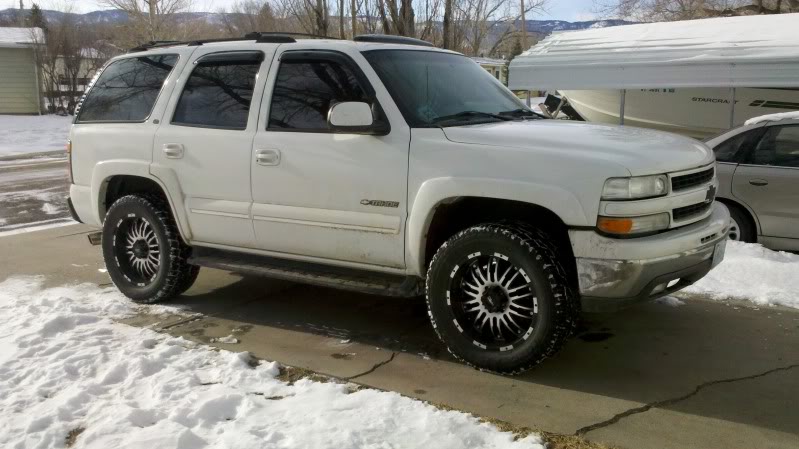

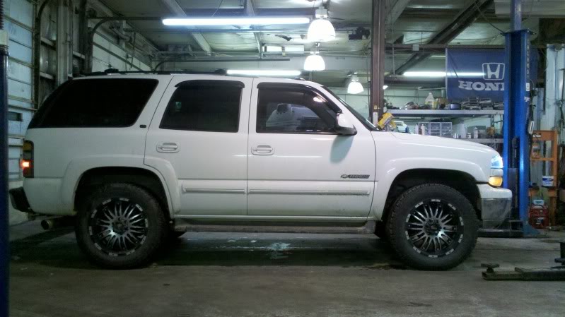

I didn't swap the coils and and used the rcx kit for non z71. Had a 1" coil spacer and key's. Sure it didn't sit as high but still deleted the autoride and replaced with rough country shocks and disabled the system.
Before the lift, with disabled Autoride and cheap Monroe shocks.
