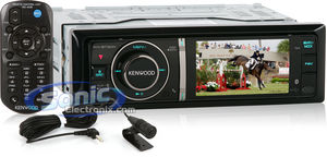

For the head unit, check out the Kenwood eXcelon line, it's one of there best. I have an iPod Touch and it's perfect. I always listen to my iPod so I needed a head unit with easy navigating and this was it. It also has the rear USB input which keeps all the wires hidden and on Friday im gonna wire it so my iPod goes to my glovebox.
Kenwood is high on my list, we'll see what happends on Boxing Day.
This is the Kenwood I'm looking at, if anyone has it, I'm all ears.
http://www.sonicelectronix.com/item_22924_Kenwood+KIV-BT900.html
Not sure which rear speaker location would be best, so if someone has tried both, I'm all ears again. :)

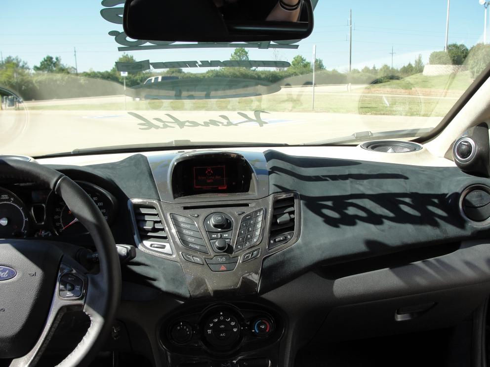

Well the one thing we do obviously agree on is the fact that front staging is paramount to imaging. And YES im glad the op decided on rear doors vs d pillars. And i think we both agree.. he would do better throwing the 2 sets of components he has on craigslist and running a set of Focals or something similar in the front and putting whatever he happened to have access to in the rear doors
But also on a side note....
Something else to consider is we arent talking about true sound (like a horn or a drum) its not analog its digital and with digital comes digital distortion.. something that helps combat this in a car audio setup..is basically.. lower volume.. so the speakers are less stressed and less distorted, so the sound is higher quality.. especially since no one here is running $6000 front door speakers and Macintosh amps.
So if volume was represented on a scale from 1-100, and someone was looking for a listening level of "60". Well without doing a crazy amount of math lets just say distortion was (X%) well adding more speakers increases "sound" and allows you to decrease the volume on amps and headunits, to get to "60" while decreasing distortion percentage exponentially.
Again i AGREE that front staging is paramount. The irony is we are even having an SQ conversation that involves JL highs since they are about the worst sounding highs for the dollar i have heard im my life.
---------- Post added at 02:34 PM ---------- Previous post was at 02:27 PM ----------
In a real SQ car, rarely do you ever see rear/rear speakers.
If the front stage has a great wide presence, low sub is minimal anyway.
I think for an SUV, optimal is spend more on front door speakers , componets with a seperate tweeter higher in the pillar, and a good set of coax, or even another set of components in the rear door.
Subs in the far back. No rea/rear speakers.
I def wasnt arguing FOR putting in rear/rears over rear doors.. i just know we ALL like to crank the volume and having extra "sound" in the car.. means NOT having to crank an ass ton of "noise" into it..
I run almost exclusively Focal and i try to build SQ as a primary goal in everything i do... and in the Jag we had a total of 18 highs/tweets (2 were paper cone 7s) and 3 12s sealed. and honestly.. pure clean heaven in that car.. was listening to it at about 12 of 40 (vol) and it sounding like there were NO speakers.. like the sound was almost coming from inside your head..
Dont get me wrong.. it would play at 40.. and you could dance to it from 300 yards away.. lol.. but i built it to play at 12.. and you to not be able to tell where a single note was coming from or have a single pan or scan , drop off or spike in tone range.
And trace youre right.. the rear sixs were in the arm rest but they were aimed at the windsheild.. and the rear deck were paper 7s faced up against the rear glass and focused to the back of the drive and passenger seats.
