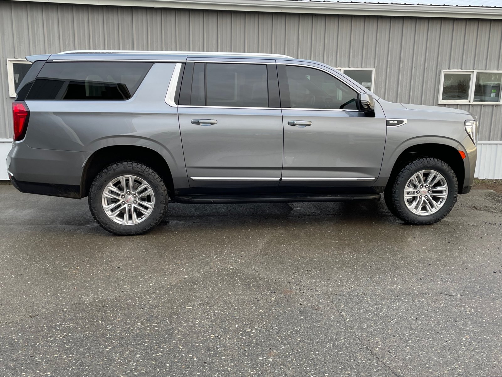

We have a non air ride yukon slt and successfully had the rough country 2" front 1" rear kit installed on it even though the fine print says it does not fit gmc models. I gained 1 3/4" in the front and 1 1/4" in the rear. Final result is not level (3/4" higher in the rear) but I'm happy with the results

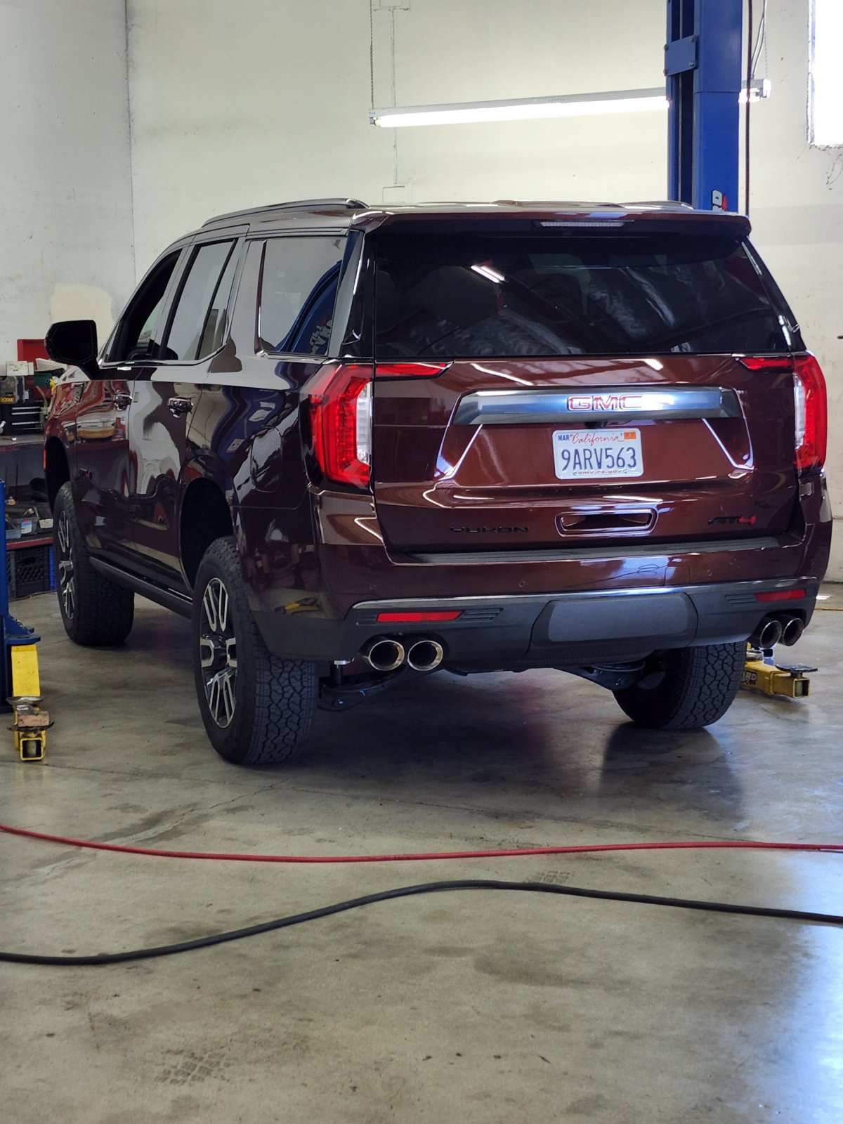

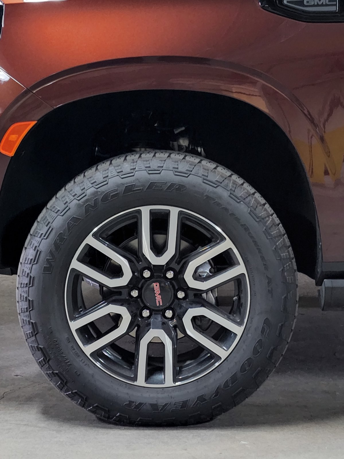

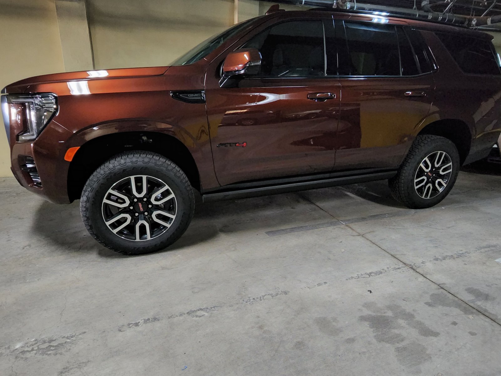

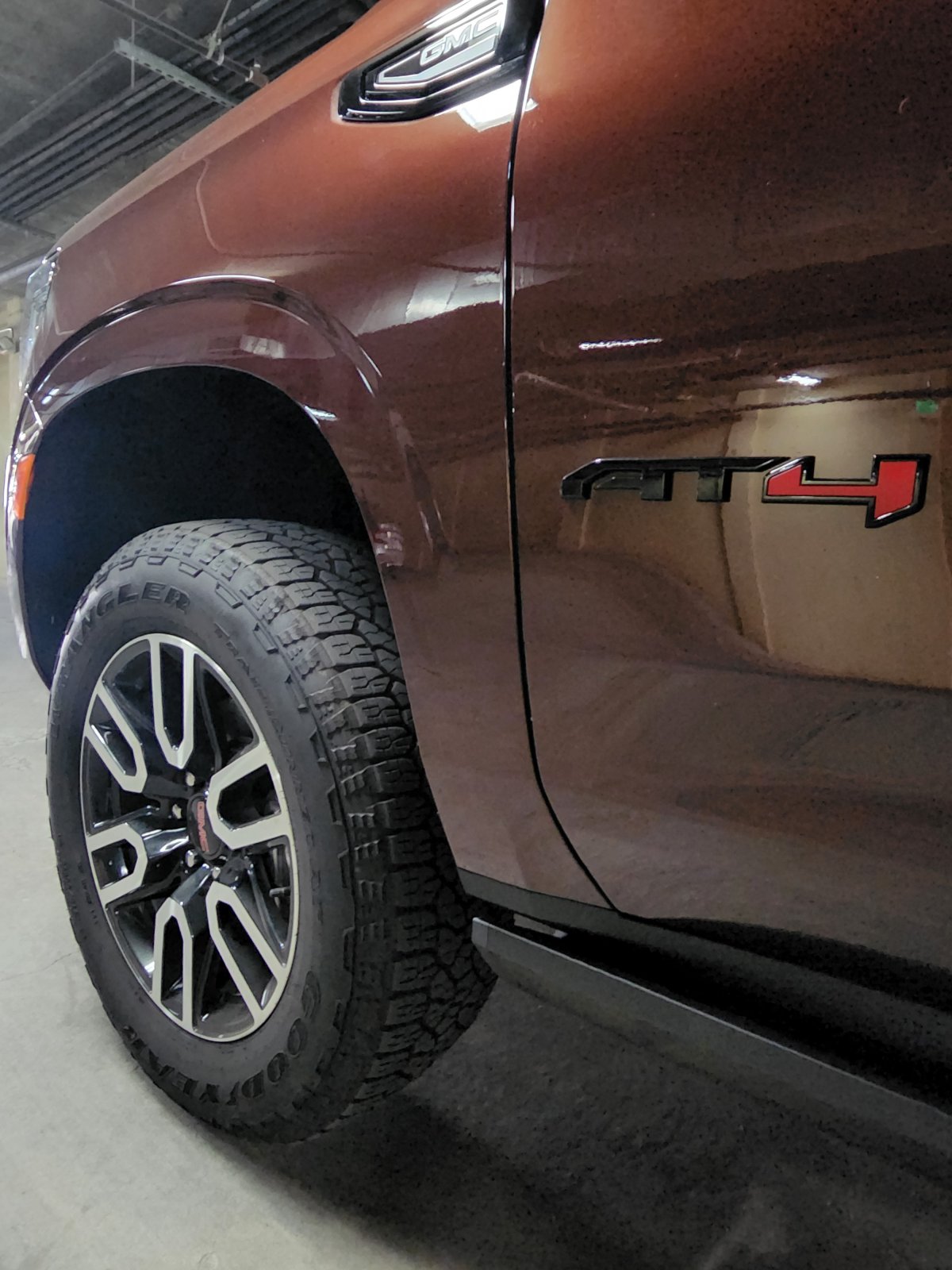

Had my 3" Ready Lift kit installed today. It went smoothly without a hitch (no pun intended), but it does feel a little weird driving just a little bit higher. All of my mirrors had to be readjusted to compensate for the additional height, and that extra 3 inches getting in and out takes some getting use to. It barely clears my garage by one inch.
Overall the kit will serve its purpose for why I added it, so that's all that matters.

Has anyone found a lift/leveling kit for the Yukon AT4?
Ready Lift now has a 3” lift for the AT4 to accommodate the Magnetic Ride.
thill466
Apr 20, 2023
27
Looking at this same kit for my wife's 22 at4 since none of the levels seem to state they're compatible with MRC on a 22 and up. Do you have any photo's of the cv angles with the 3 inch lift on? Thats my only concern without dropping the diff that i may be replacing CV's every 30k miles.

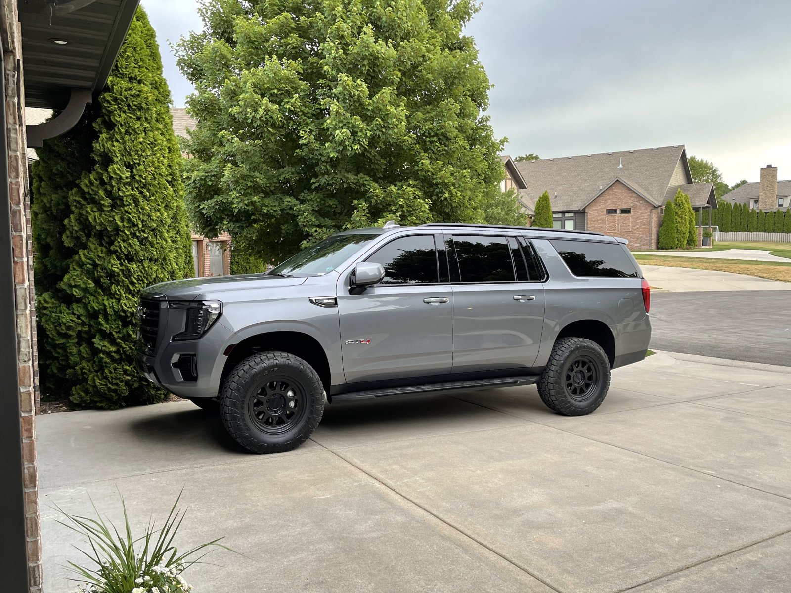

Very surprised more people haven't jumped on this Readylift SST 3" kit. I really want to see an AT4 Yukon with stock 20's on 35x12.50's with this. And no wheel spacers. Anyone ever seen an example of how that setup came out?
Al559
Jan 10, 2023
I think the lift rides great. At least as good as any other I’ve had over the last 26yrs of driving.
I know this is an old post but sanman28 what size is your tire and wheel combo? Do your tires rub on any pinch welds or plastics at all? And how has it been working out since you installed the 3 inch kit? Beautiful truck btw
