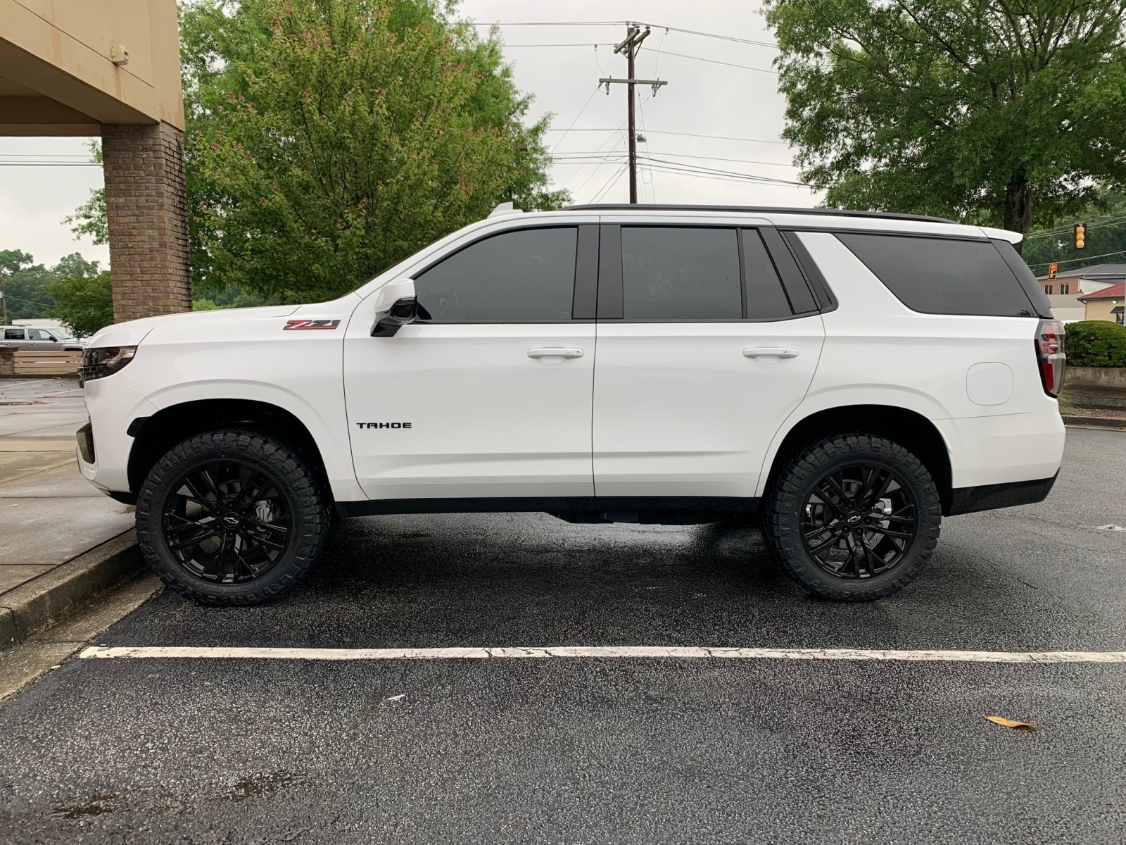

Just put this on my Z71. Its a good set up and also adds spacers to the back so not nose high. Not sure why it is not listed for GMC but I would give them a call and ask.
https://www.roughcountry.com/chevy-leveling-lift-kit-11200.html?find=2021-chevy-tahoe-4wd-742158
Hi - I just put a deposit on an XL AT4 which is in transit to the dealership. Someone else cancelled their order and I took advantage. Also just joined the forum.
I haven’t noticed from the photos that the AT4 front is lower than the rear like a pickup truck. Is it? Or is the “leveling” kit really just to raise the truck more? Thanks.
I agree. The new gm suv’s in general look pretty damn level to me.
My Z71 had about 3/4 to 1” of rake. I am running 34.5” dia tires so needed a bit more lift to clear
Rough country says this 2” lift doesn’t fit the z71. Did you have any issues on your z71. I just purchased a suburban z71 4x4 and I want another 2” with oem replica rims 24x10 just like yours. I love your setup!!

Just ordered AT4 XL non air ride. Has anybody leveled or lifted these yet?
We have a non air ride yukon slt and successfully had the rough country 2" front 1" rear kit installed on it even though the fine print says it does not fit gmc models. I gained 1 3/4" in the front and 1 1/4" in the rear. Final result is not level (3/4" higher in the rear) but I'm happy with the results
That looks great and what I’m going for. Absent air ride, I don’t think any of these trucks have different suspension components. The MRC probably have different shocks….but I bet the install the same and with extension brackets should work the same so long as not stretched out more.
