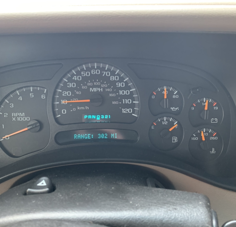

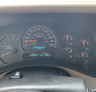

36psi I was getting 302 miles a tank since October of last year.

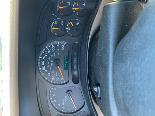

Bumped it up to 42psi a week ago and ran almost an entire tank of gas before refilling. Now I’m seeing the normal range of 360-380 per tank
