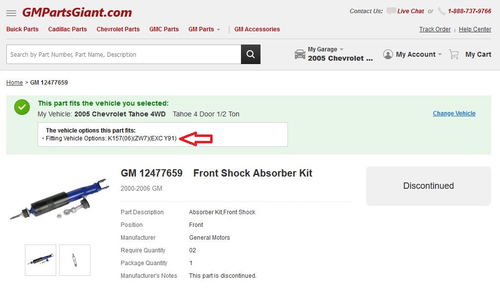

To add: here's a lookup you can do yourself for parts for your truck. Just be sure to read the details on the part to verify the RPO code fitment. While these shocks are discontinued, you may be able to use the part number from other sellers to find them if you're bent on OE only.
