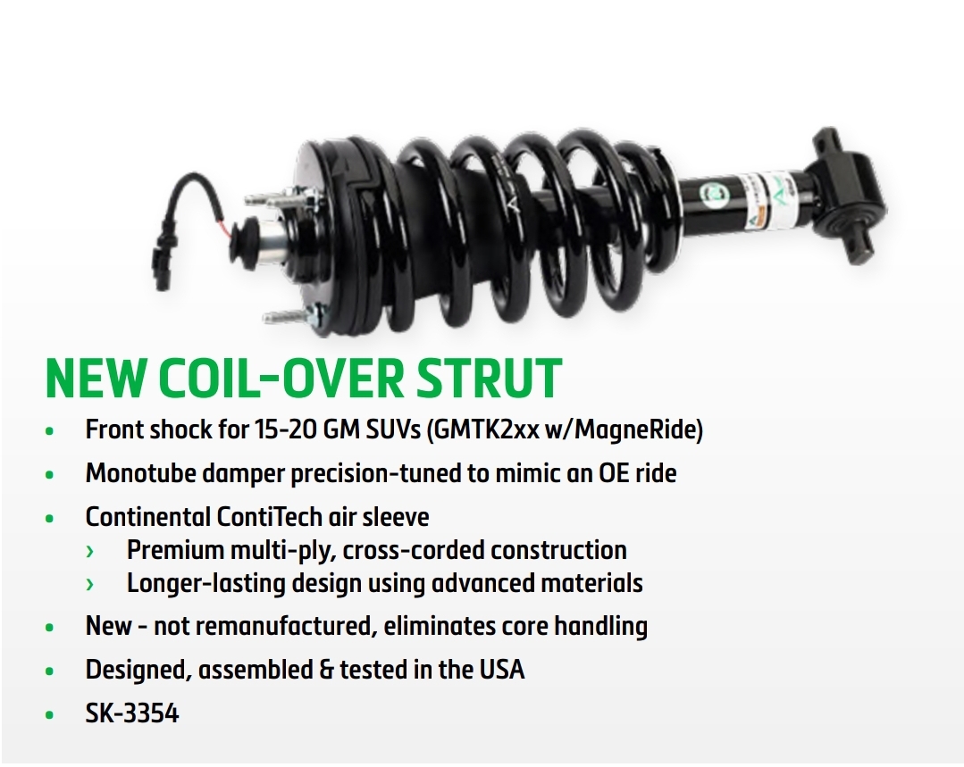

After more research on the arnott 3354 I've confirmed it is passive not active.

My thoughts so far are the arnott sk3354 is a great product.
O.E. build quality without the O.E. technology.
Im leaning towards the acdelco O.E.
My reasoning is with the 22" wheels and a normal passive shock it's going to have the ride quality of any other suv that someone put aftermarket 22" wheels on. (not that great).
