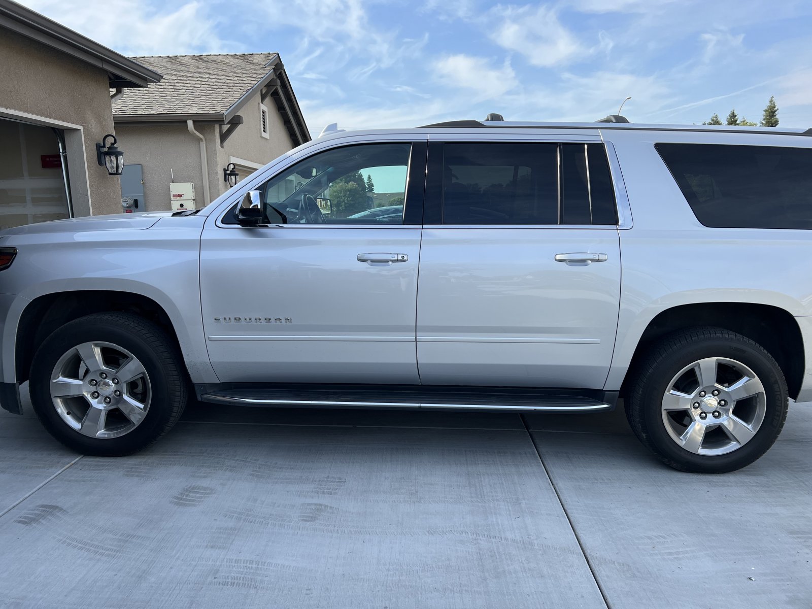

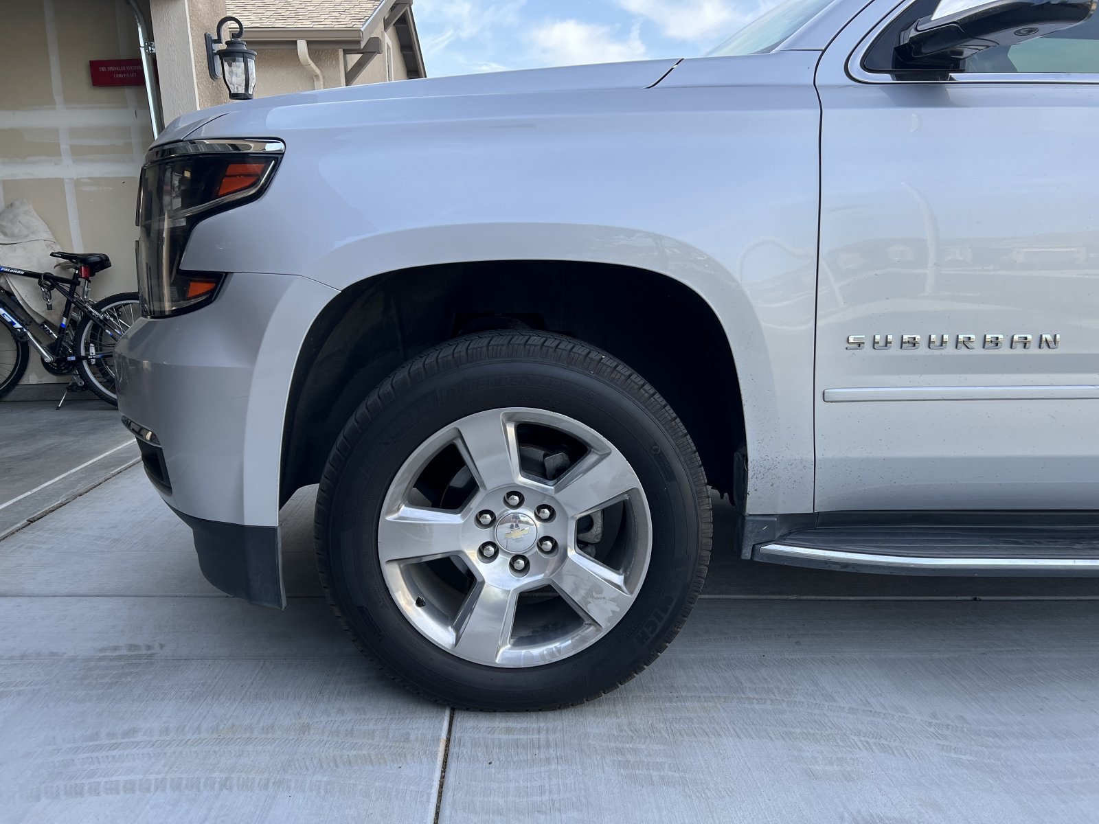

Finally got the Arnott SK 4261 that was recommended by Arnott Customer Service.
2018 Chevy Suburban Premier 4WD.
Took it back to stock height. Bottom edge of fenders is at 37 1/4 inches. I was surprised that both sides measured the same.
