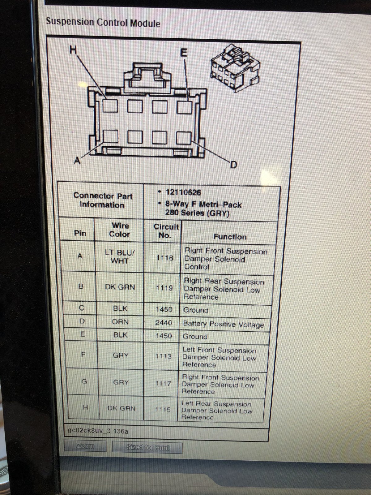

Found the controller. Thx. Now does anyone know Which one is pin D and pin E on the gray connector. And pin B-8 on pink connector. Those are the 3 wires I need to splice into
26,624
52,732
Here’s the grey connector. D is the orange wire, E is the black wire.

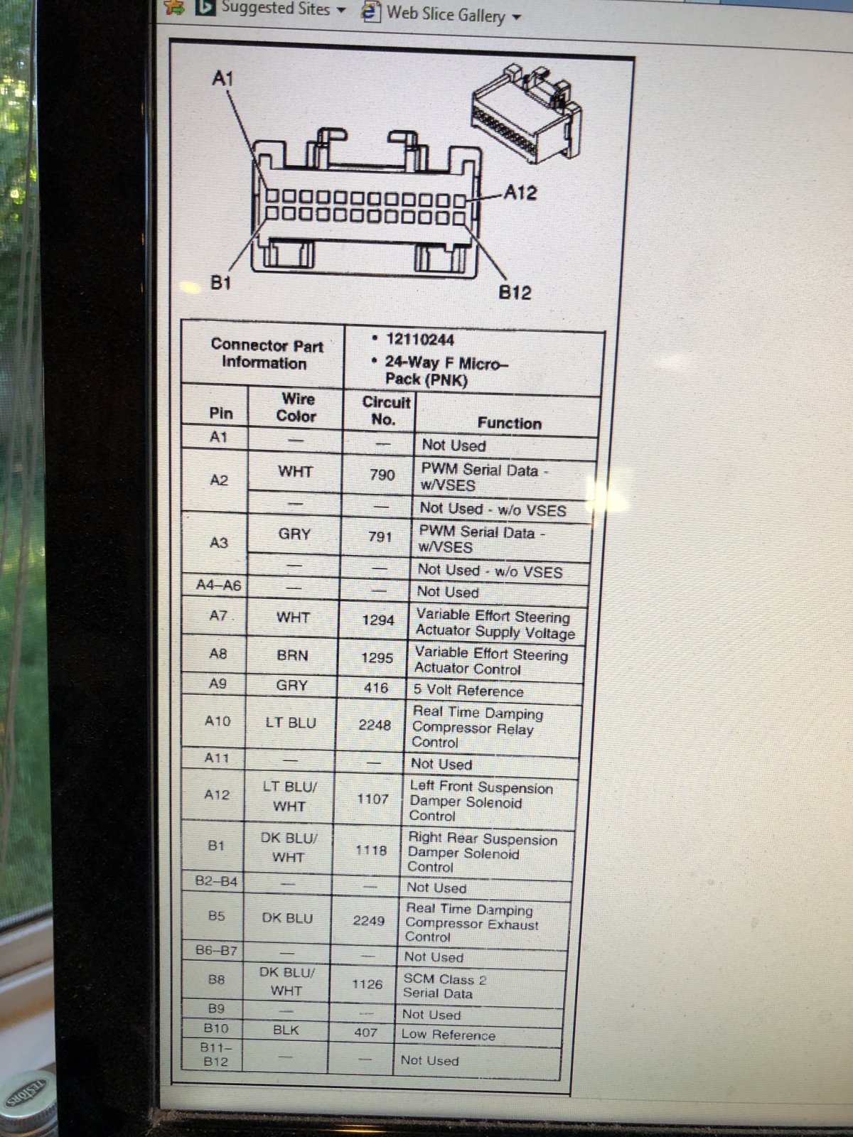

Instructions from arnott says B-8 pin but there is no b-8 pin being used on my pink connector.strange. Only pins used on B side are 1,3,4,5,6.
1-lite blue/white stripe
3-lite blue
4-gray
5-brown
6-white
26,624
52,732
3-lite blue
4-gray
5-brown
6-white
You’re looking at the connector from the wrong end. I believe you’re looking at it from the rear where the wires exit. If you look at it from the front of the connector it will make sense. That’s what the picture in the diagram shows- at the upper right is the 3 dimensional picture showing the correct orientation of how you’re supposed to be looking at it, then below is the picture showing PIN numbers. I imagined you looking at the back side and you’re looking at it upside down and backwards because then A12 is what you think is B1 ( lt blu/wht) and what you think is B3 is actually A9 (grey which can look like lite blue) etc. Try again, looking at the front of the connector and oriented like the picture.
