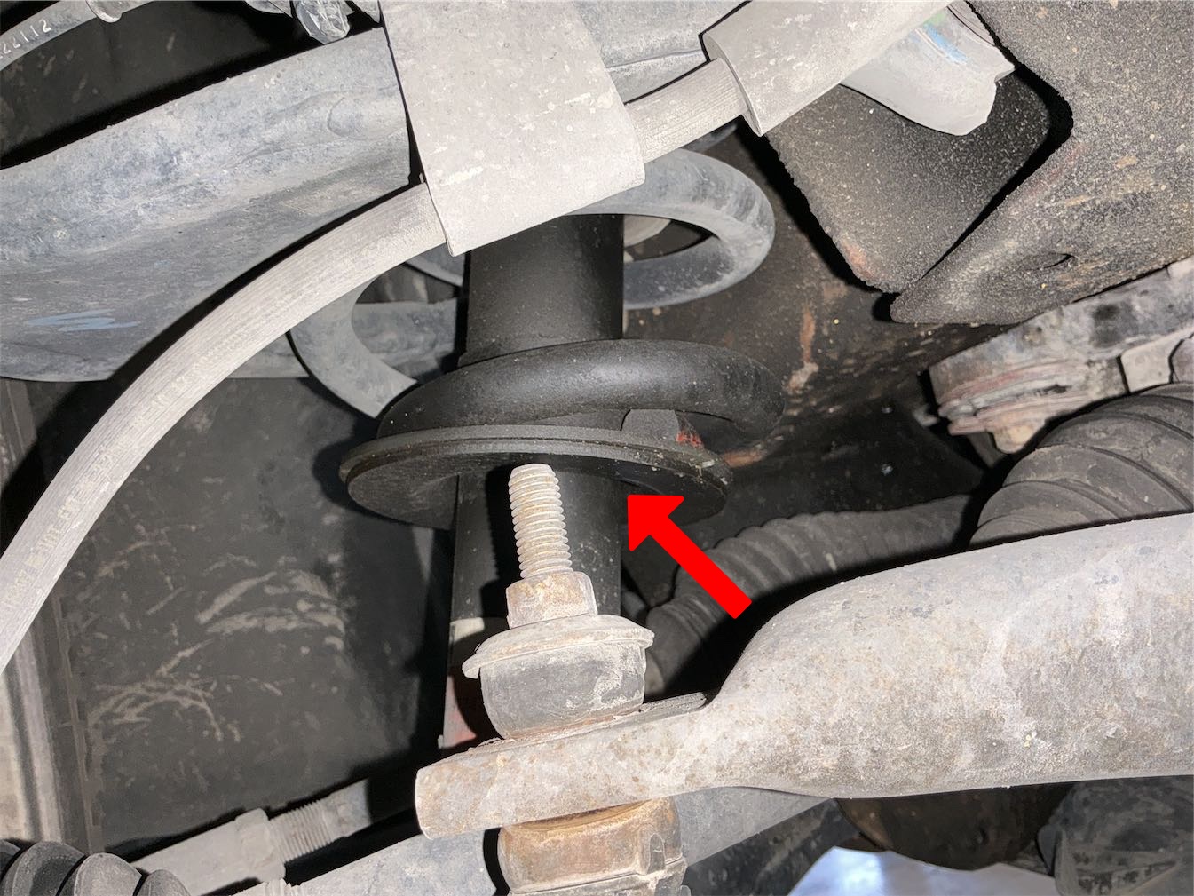

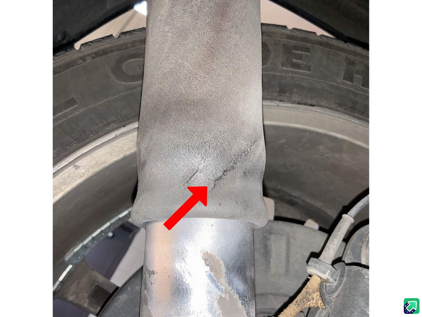

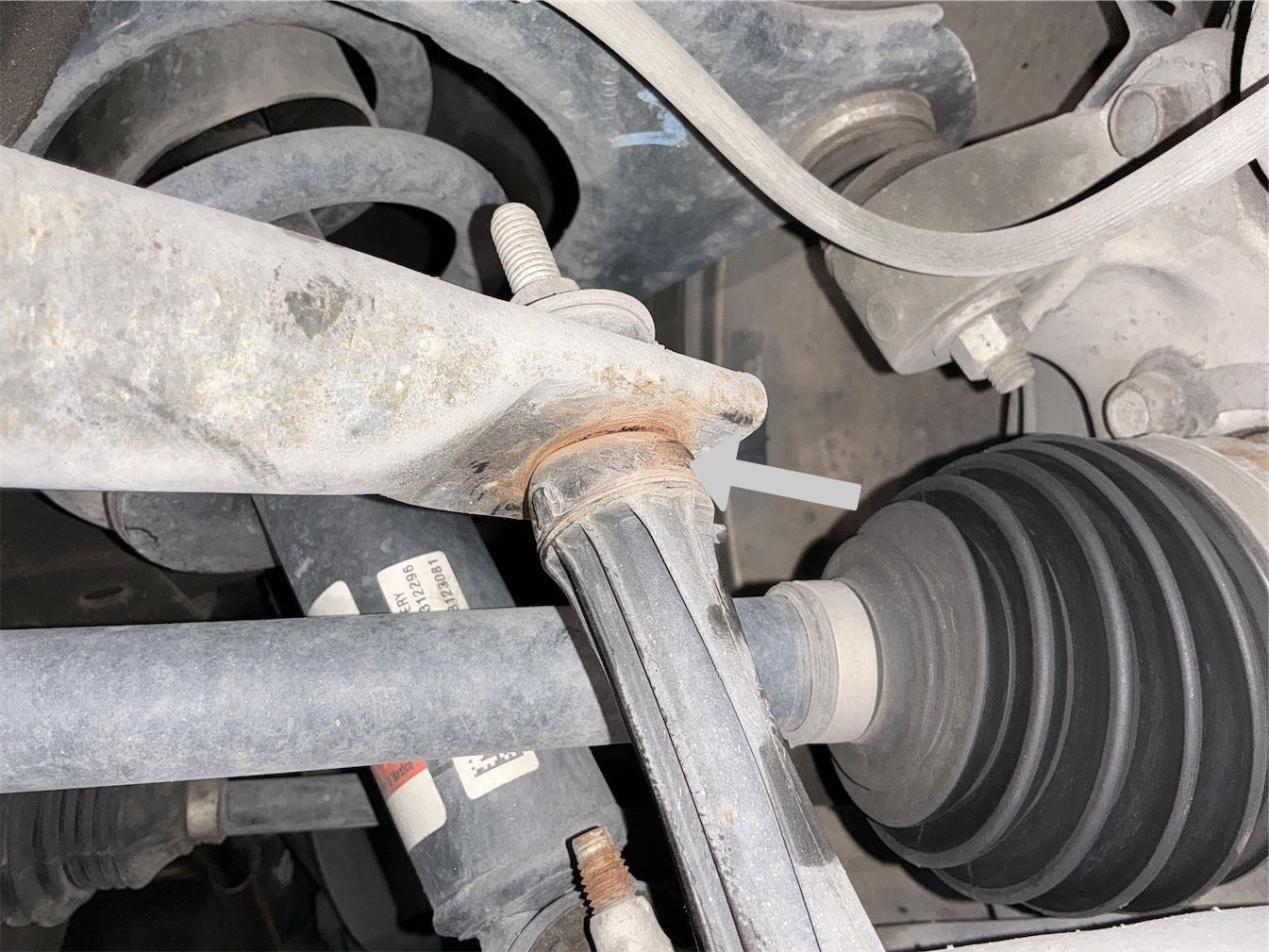

Recently returned from the repair shop and they sent me a courtesy report from their inspection. The repair shop states that the front suspension components are severely in need of immediate replacement. I'm not sure if I'm seeing what they're seeing though. They stated the front strut and rear shocks are bound up and leaking. The lower control arm and sway bar links need replacement as well. The only thing I am seeing that probably needs immediate replacement is the rear air shocks since there's obvious cracking of the membrane, but even with that the SUV rides fine for now. I looked around for magnetic fluid and couldn't find any and went under the car today and there wasn't any play in the suspension components.
Are these as bad as they are saying? Obviously the quote for them to do these repairs is significant, as the parts alone are a few thousand.
30,576
48,070
rear shocks are shot, end links are worn but could be replaced if so desired,
front strut looks like it has a leak.
I don't know why you would be looking for "magnetic fluid" the strut is not serviceable, cannot be re-filled or etc.
your looking at around $1500 or less in parts total if you are looking to DIY
shops always have a parts markup and lots of labor, you could do all of it yourself in half a saturday, you would just need to rent the spring compressor or take the struts to a shop with one and that would probably cost $50 and then you just R&R.
a few tools and a jack and you are good to go.
Ah, I've seen some pictures of cheap struts in the past that were leaking fluid bad (Dorman brand).
I'll get ordering from Rock Auto and set side some time this weekend! Do you think it's a good idea to replace the rear shock air compressor while I am back there? I've heard those can help smooth out the ride when brand new as well.
I'm going to order a set of springs as well for price for mind. Might as well since I'll have it all taken apart.
Thank you for the insight.
