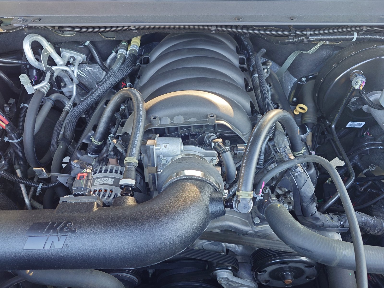

So, I haven't reinstalled the new AOS, one thing at a time, here, but, I did want to address something that's not entirely visible from the pics - vacuum leak.
The intake came with new hoses and connections for the valve breathers, but, they're not sealed, at least, not well. The hoses come off pretty easily, which means, when we're talking physics, air will choose the path of least resistance - in this case, a loose hose connection.
I ordered some spring clamps, Hillman 59741, 15/16ths spring clamp. They're not gray, but rather real close to ODG, which, luckily is also my jam, and only a minor concern because this is top engine, visible stuff.
Applied four of the twelve clamps (for which I think I paid about $12) and started up. Idle smoothed down seemingly quicker.. Took it for a little romp.. Throttle response and intake noise sounds.. More correct.
I'll put this one in the W column.
Probably wait until next weekend, just for the sake of, "science," before adding the AOS..
