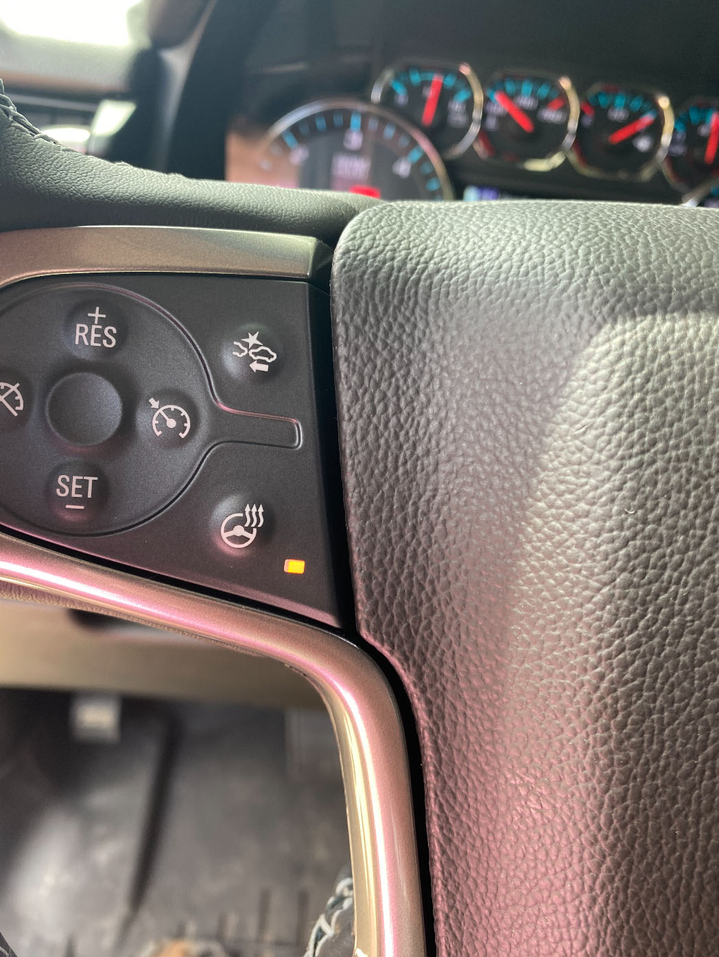

Success! Plug n play on my non-lux LT. If you have a 15-17, make sure you get version 1 clock spring. My 18 needed version 2. Of course I ordered wrong one first, and spent 2 hours trying to fit a square plug in round hole. Once I got the right part, I did the whole thing in 30 min. I originally had trouble with the airbag (thinking it may go off), but I had it out in 5 minutes this time. Also, original clockspring goes way up into dash and over top to plug; easier to just cut it and reroute new one. Mmmmm warm...

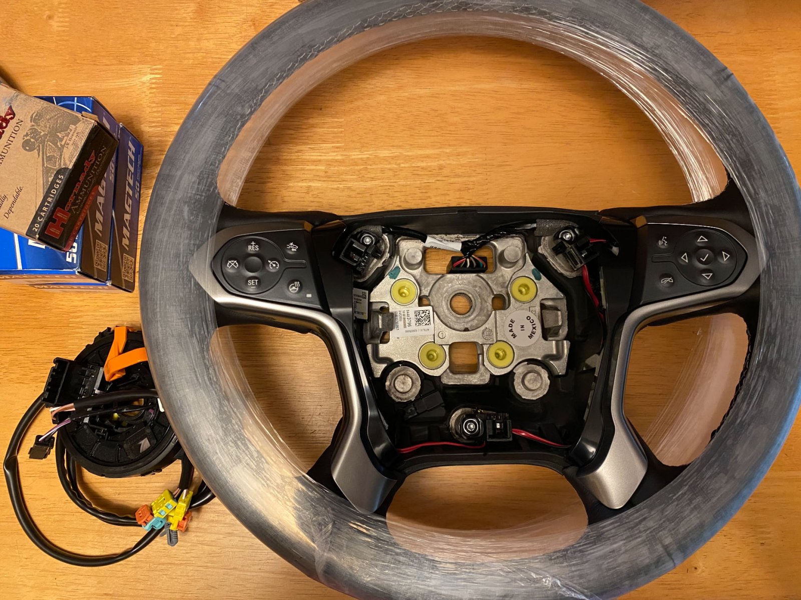

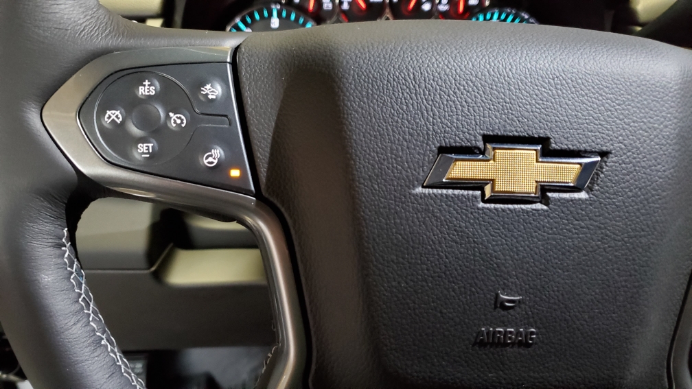

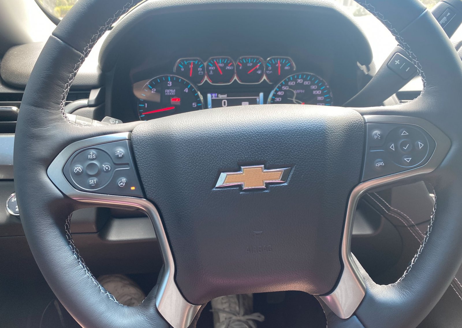

Everything arrived last night from GMPartsStore
Installed this morning. Took about 45mins when following along with the video of the "Tinkering Fox" guy doing it on his Sierra.
Pulling the knee guard back enough to get to all the wires (specifically removing the old clock spring) was the hardest part. I have big hands so it's tough to get in there, but I made it work.
Here are some pics.
I will add, I was very happy and felt satisfied when I saw the little orange light come on haha and once it felt warm I was happy the conversion was complete!
Also, a fresh new leather wheel after 50k miles is sure nice.
