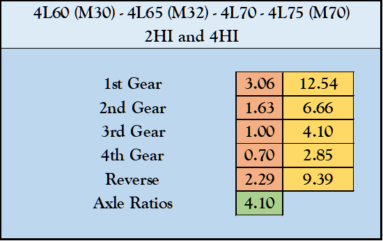

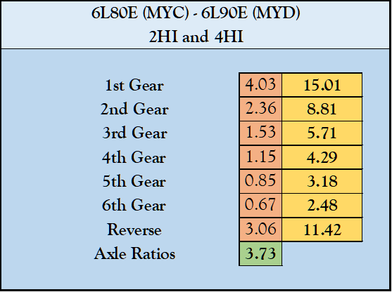

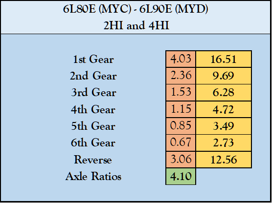

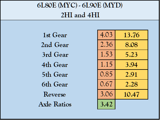

@B-train Consider the difference between your Dad's Silverado and a 2009+ Silverado equipped as shown.
Now here are the effective ratios for each gear with the ones Sparky is considering:

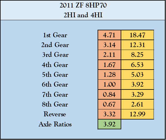

Now also consider this, there's a young man sweet on one of my daughters who comes around with a Ram 1500. He's been victorious in several 0-60 runs at the street drags. The 3.73 geared Sierra on 35s gets him off the line but he quickly runs her down. The motor's in each are similar power wise so I endeavored to find out why and here is what I discovered:
Look at that first gear ratio! In order to compete with that gear wise we'd have to go with 4.56 gears. We installed the BlackBear tune that Justin sent over yesterday and when my daughter got back from an impromptu drive she was all smiles and said it went "zoom, zoom" like never before! Fun stuff!
View attachment 383962View attachment 383963
View attachment 383964View attachment 383965
