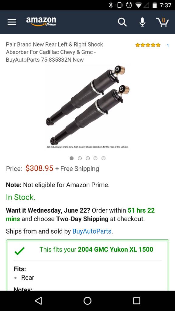

Anyone try these?
Merc1973
Sep 16, 2016
351
322
Maryland
What makes them passive?
Sent from my Nexus 6 using Tapatalk
There is NO electronic dampening like the factory Delphi shocks. It's just a resistor that the plug goes into. It is probably a twin tube shock with constant valving.
So it still utilizes the air system but not electronic dampening?
