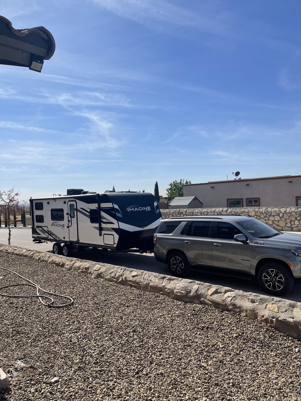

I just purchased a 2022 Grand Deaign 23BHE. The next day, I hooked it up to the back of my 2021 Tahoe Z71 and towed it 10 hours to the Grand Canyon. I have a blue ox sway pro hitch.
Trailer weighs 5300 dry, so with all of our things it was around 5800 pounds. Didn’t put water or bring drinks, just clothes and toiletries.
Towed like a champ. Lots of people would be weary of the weight, but not I. If the numbers bump, tow it. I will however think about adding airbag suspension at a later date. My Z71 didn’t have the air bag option. Slim pickings!
Anyways, here’s my rig! Happy trails
