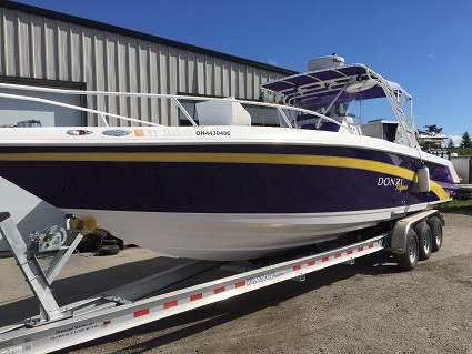

When I mean heavy, I mean like 9000 lbs. I know its over the tow rating, don't need lectures.
I just need peoples experience with towing a heavy load with a Denali XL either 4wd or AWD. I know power is not the issue its brakes and suspension.
Just towed my 35 Donzi ZF 39 miles with my Duramax. It does fine, I'm hoping a Denali XL can handle it.

What year Denali? Most are AWD. Can’t speak to that heavy but I’d think the hitch set up is critical. Is this going to happen often? Hills? If often a weight disturbing hitch and another trans cooler may be in order. My boat only weighs half that.
