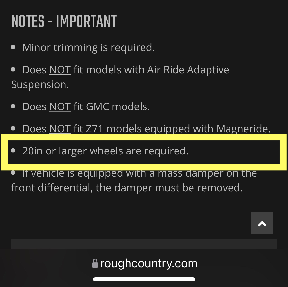

Rough county list it on their 3.5” kit. This is from their website… @sanman28
No wonder…I was looking at the 2”. Either way it would only be a spacing issue. Not too concerned……and FWIW, RC has been wrong or misguided on nearly everything on these new SUV’s.

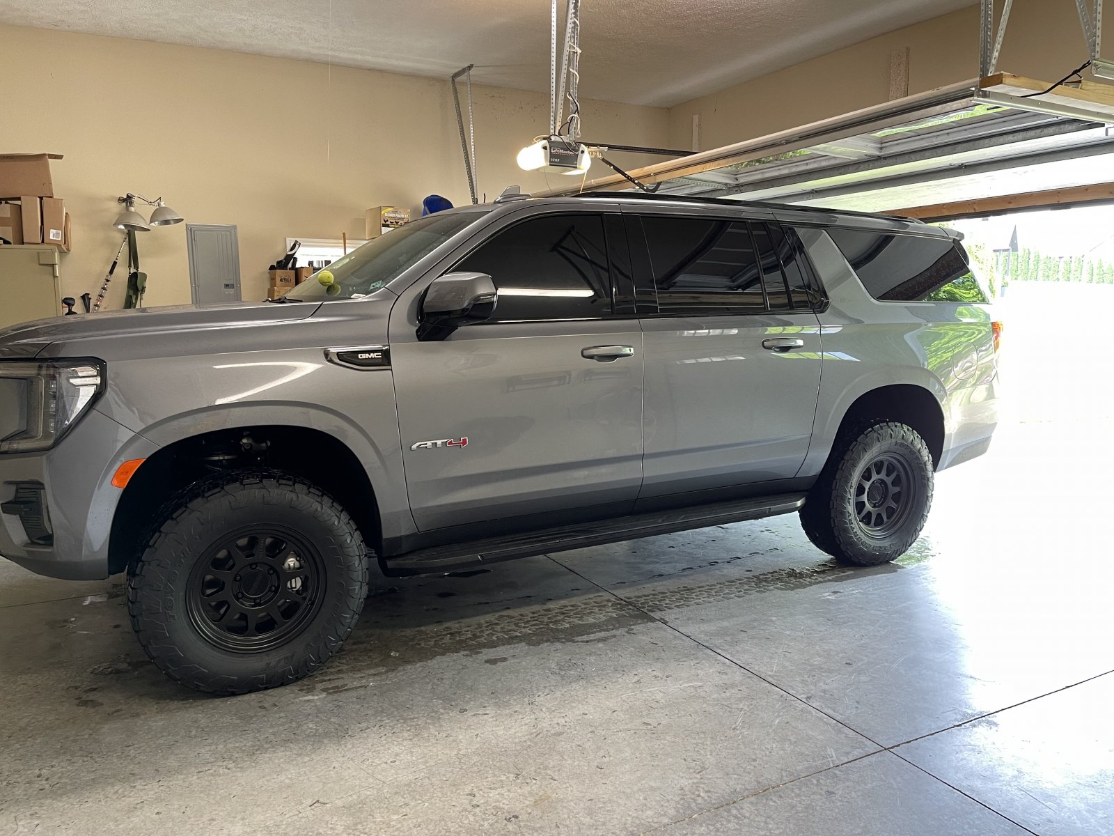

Took delivery today. Also ordered 18” method 316’s. They are 18 offset. 3.5“ ready lift and 305/65/18 toyo at III’s
Looking forward to seeing this! Should look amazing!

Thanks. Hope so. Just dont want it to look too large or redneck. I am VERY disappointed that the factory GMC Sierra AT4 18" wheels have such an undesirable offset/backspace. I was going to use those, but im not going to f*ck with 1" spacers and all that crap.
