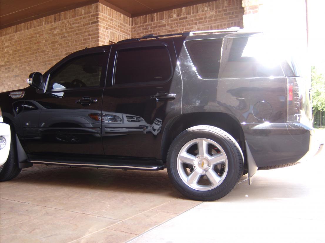

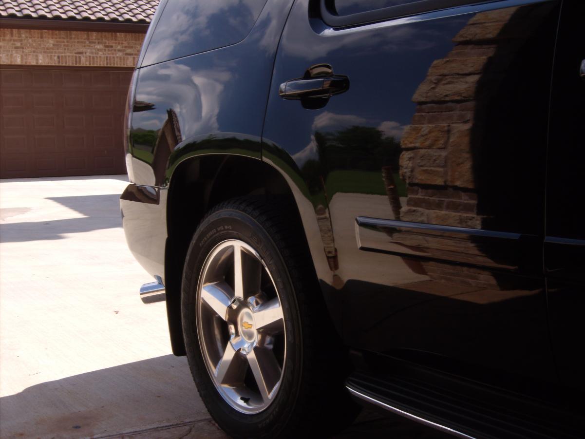

Here yall go, pics with just rear lowered on about 3.5" coils....
Thanks. So, you didn't lower the front at all? And did you, in fact, get 3.5" of drop in the rear, or did you get less (or more)? How is the ride?
Anymore full side shots? Thanks!
Modded
That Guy
May 3, 2009
6,942
109
Hey, the front is not lowered yet but will be as of probably tomorrow. The rear Pedders drop is meant to lower the rear about 3.25", but w/o spring isolators I think I'm pulling about a 3.5" rear drop.
The ride is good, feels just about stock smoothness wise!
