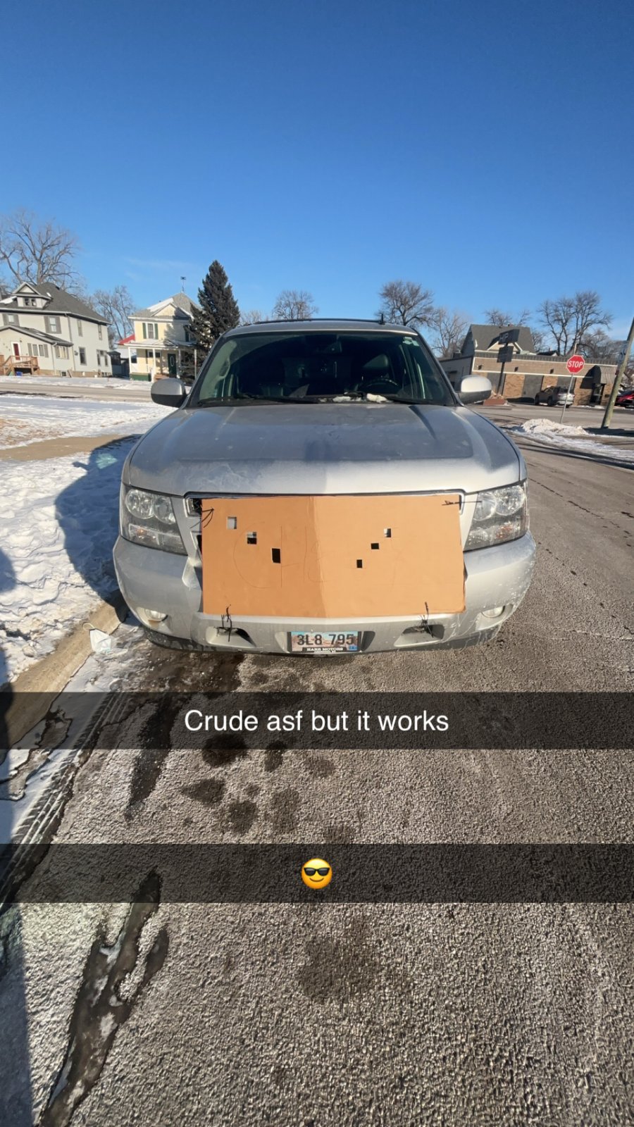

-25°F today.

I've done that in various vehicles but put the cardboard -- with a larger hole cut out -- behind the grill and in front of the radiator. Had a Corolla that wouldn't heat up in winter coming down from the foothills; apparently the engine wasn't working hard enough on the downhill (first 10 miles of my commute). Other than that it was on a few different cars in the middle of a Northern Illinois winter.

A lot of the new Tahoe/Yukons have shutters just behind the grill to cut the air flow. More for gas mileage than warm up but should help that too I'd think.

Don’t think mine does. I can see straight into the radiator.

I tried but the area where I’d put it in is sealed off. Completely. And the fans are blocking the back area as well

It's normal to hit temps like that here and have never had to do that.
But whatatever works cause you don't want to be messing with stuff when it's that cold.

Yes, I've done similar, but not with my Tahoe here in Georgia. It was with my '57 Chevy, '86 BMW 535i, and '87 AMC Eagle when I was stationed in Spokane, WA and Minot, ND. I used cardboard in front of the a/c condenser in the BMW, and used a really thin mattress pad in the AMC and the Chevy. Some guys I knew, plus the motor pool Suburbans had commercially-available grill blocks with snap closed/open flaps, and you used to be able to get plastic grille block inserts.
Something to consider to keep heated air from escaping the engine compartment when the truck is shut off is to put painter's tape over the gap between the hood & fenders. It'll make a slight, but noticeable difference (or maybe it was wishful thinking when it "worked" for me).
A number of vehicles have had these for years, for both airflow and gas mileage & emissions. They'll shut completely when the engine is off, thus keeping the engine hotter for longer, reducing the time it takes to get back up to operating temperature upon restart. This counts a smidgen for CAFE and EPA testing, even though you might not notice a difference yourself.

I can see it for a diesel engine, but no reason you should have to do that with a gasser. Something's wrong if it's not getting up to operating temperature. I've had my 2500 as cold as -25° F, and she got up to normal engine temp just like any other time. Now, granted, it took longer, and when I first cranked up the heat, the temp needle dropped quite a bit.

It does. It just doesn’t in my little drive to work

Was also curious if anyone knows if my ride has those grill shutters or if they’re on the radiator? I’ve never heard of such a thing. And has anyone had issues with them malfunctioning?
