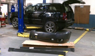

I tried googling as well as trying to dig up old threads but ive came up with roadblocks and dead links. Does anyone have any real life pics and not computer generated pictures of any installed? also how does the grille fitment look? can you use the oem grille inserts or do you have to use their speed grille mesh inserts?

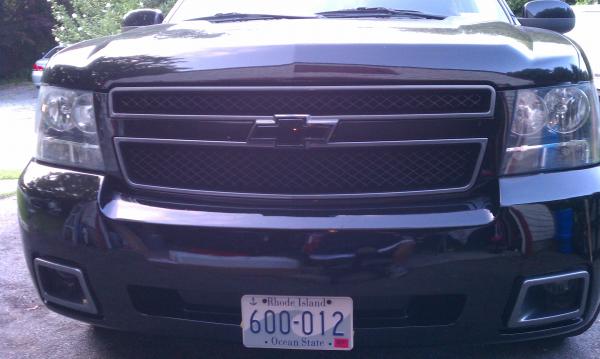

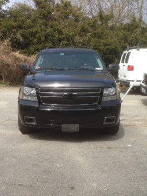

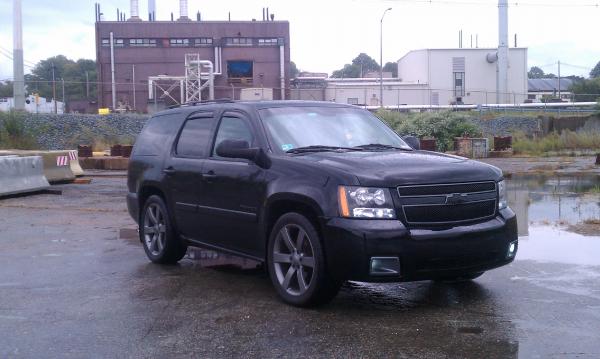

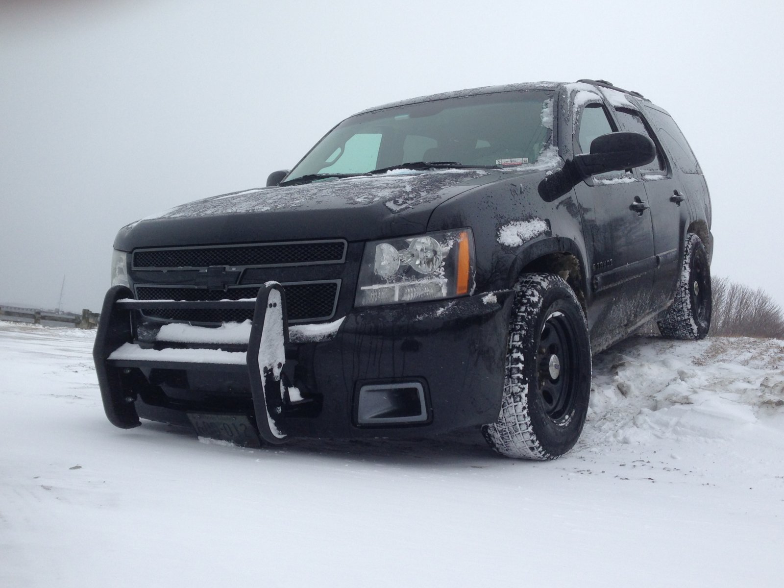

View attachment 206242 View attachment 206243
Yes and yes. The bumper cover sits over the lower portion of the bumper. It’s 3m tapped multiple sections and use screws in the wheel wells. It’s all primed. You have to paint the cover. I had my painter paint the cover and had him paint the fog light slots gray. You don’t have to use the inserts. They slide over the oem grill and it’s recommended that you zip tie them in the corners for added security. The lower screen you have to drill holes so you can zip tie the screen into place. I’ll dig up more photos from my album. I also had the SS skirts too at one point which are also 3m taped and you use tap screws to secure them.

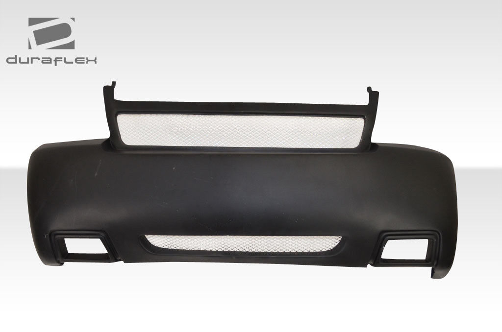

@sumo thank you! i had found your threads but all of the photo links were broken. What brand was your bumper? only ones im finding are Duraflex and it looks like a whole replacement. I really like how yours fit better.

My buddy ordered Duraflex bumper for his s10 and it was shit.. he sold it and bought the street scene one and its urethane and won’t break. Came in a box folder in half and unfolded.. he was like WTF
