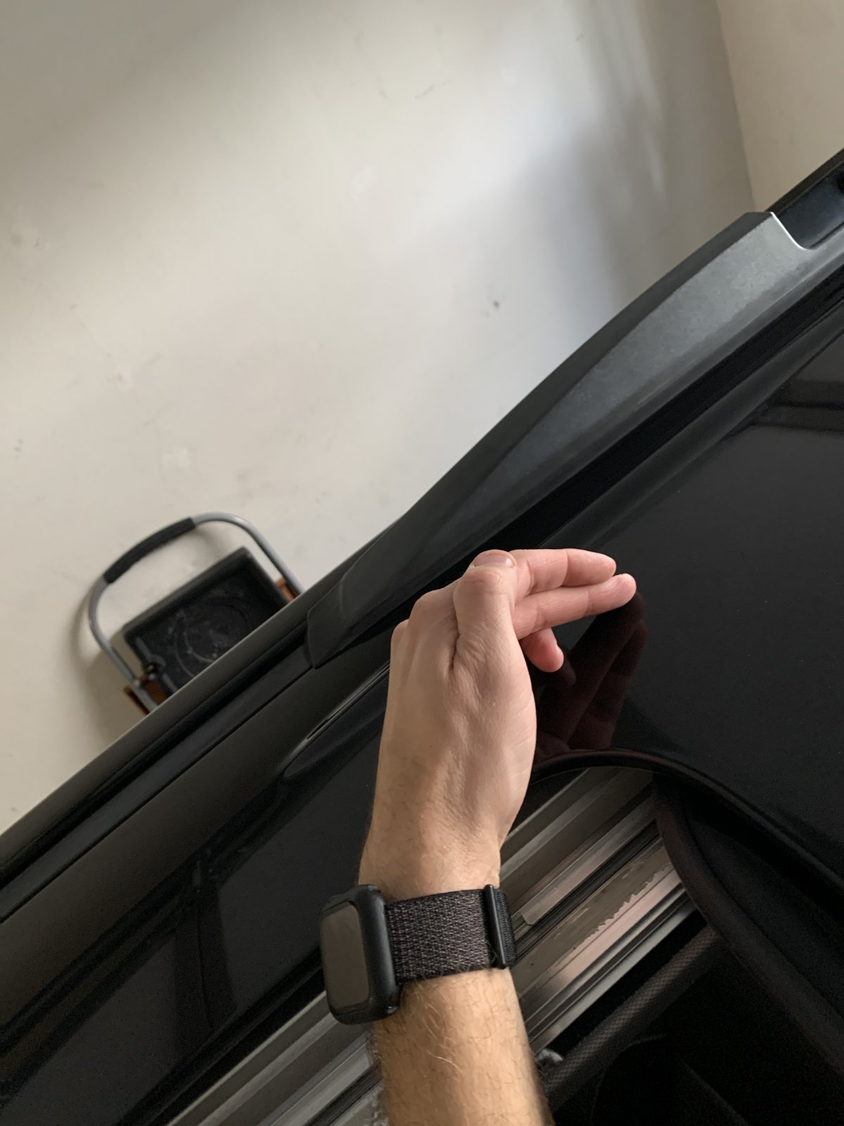

I have been using this setup for several months but would rather have a real feedline from the roof. Since I am a one man show and don't know anywhere to go to have it done, I decided dropping the whole headliner would be a real PITA for me, and have been thinking a NMO could go here? It's the rear side of the sunroof opening. Theirs room for me to stick my tiny hand and install a NMO there.
Watcha think?

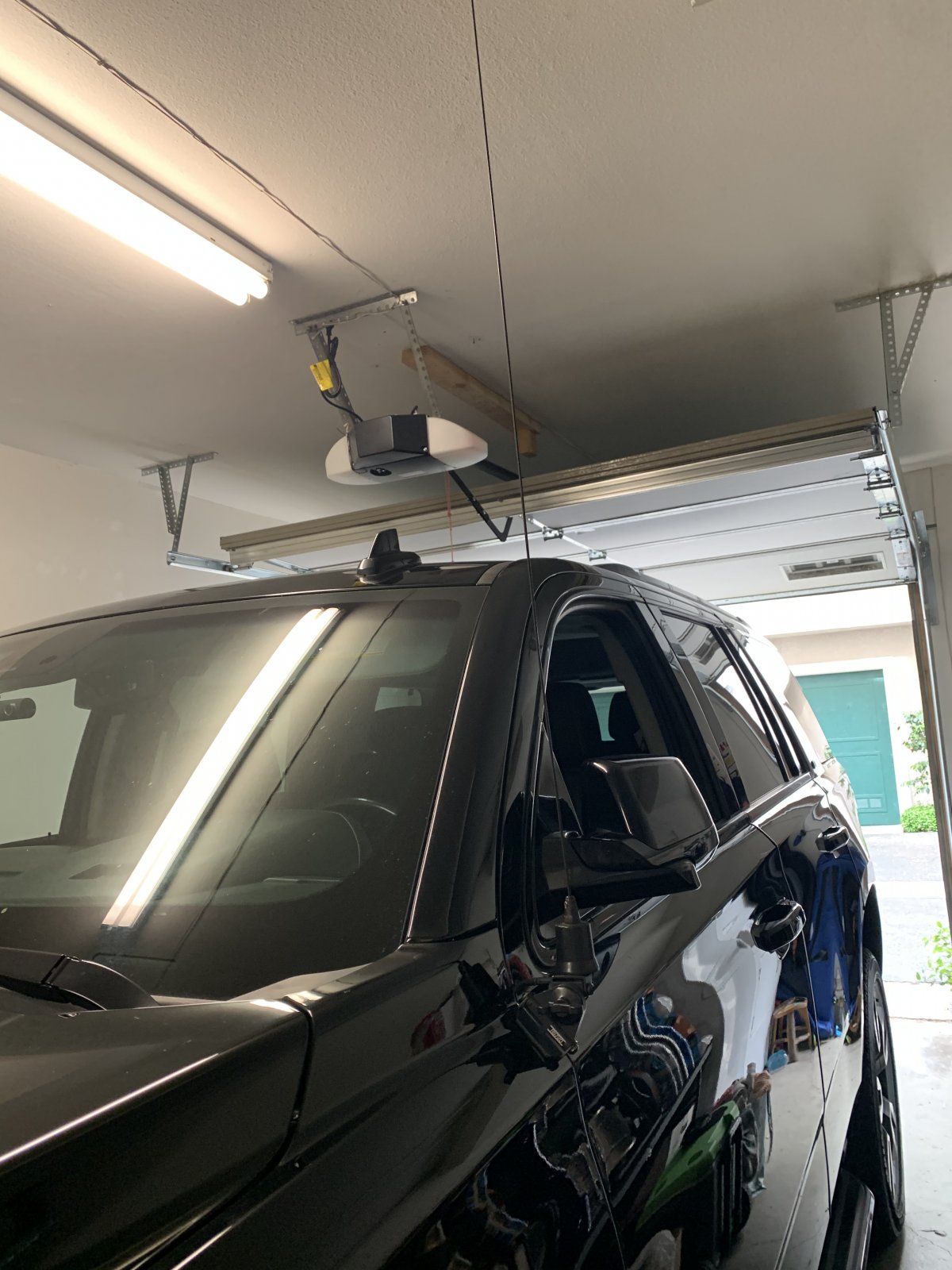

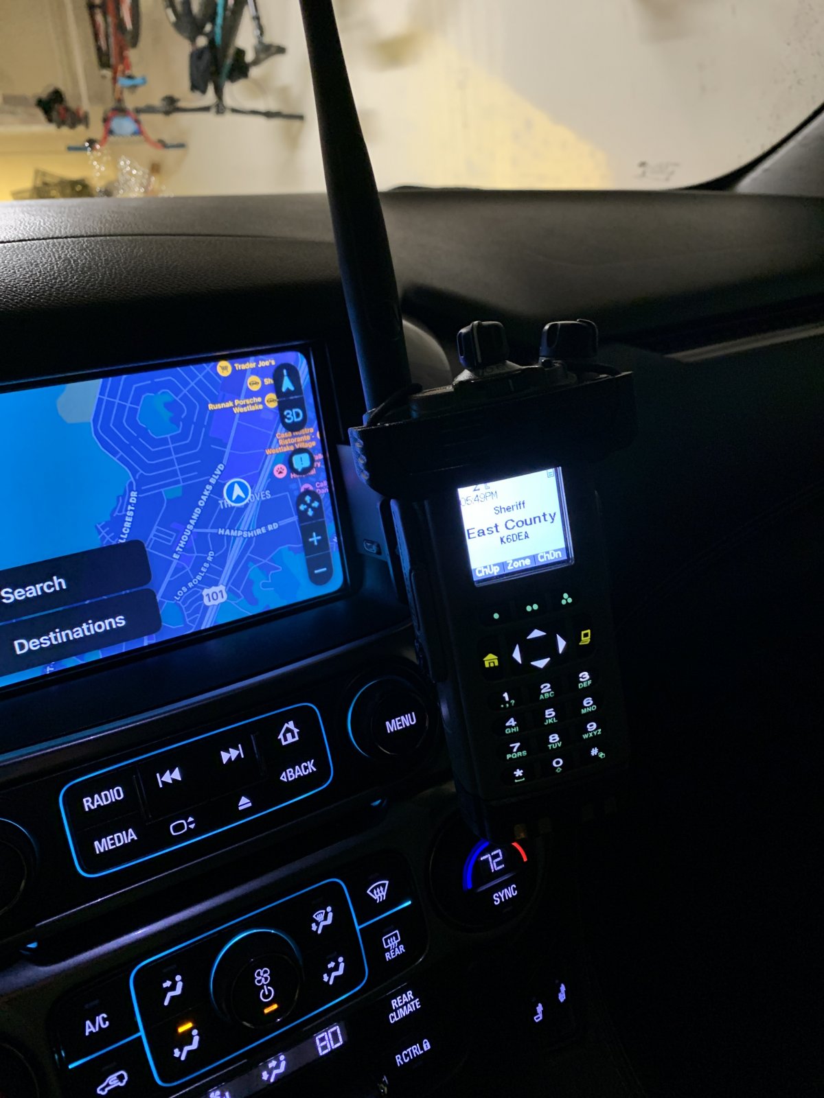

This is what I have right now:

So you are thinking to have the coax enter the cabin at the edge of the sunroof trim, and run it over to a pillar, with it visible? That is certainly easier than dropping the headliner.

pretty much what I plan to do is, remove passenger sun visor, "oh shit" handle pull down that quarter of the headliner down and mount the NMO between sun roof and passenger window.
BTW I have a 18 Tahoe and the backdoor / hatch, I assume it's aluminum but with a continuity meter it is not what I would want to have a antenna mounted to.
My current radios are a XTL5K T Band and a APX8000 HT
I recommend to buy the proclipusa stuff for the truck vs holes everywhere lol

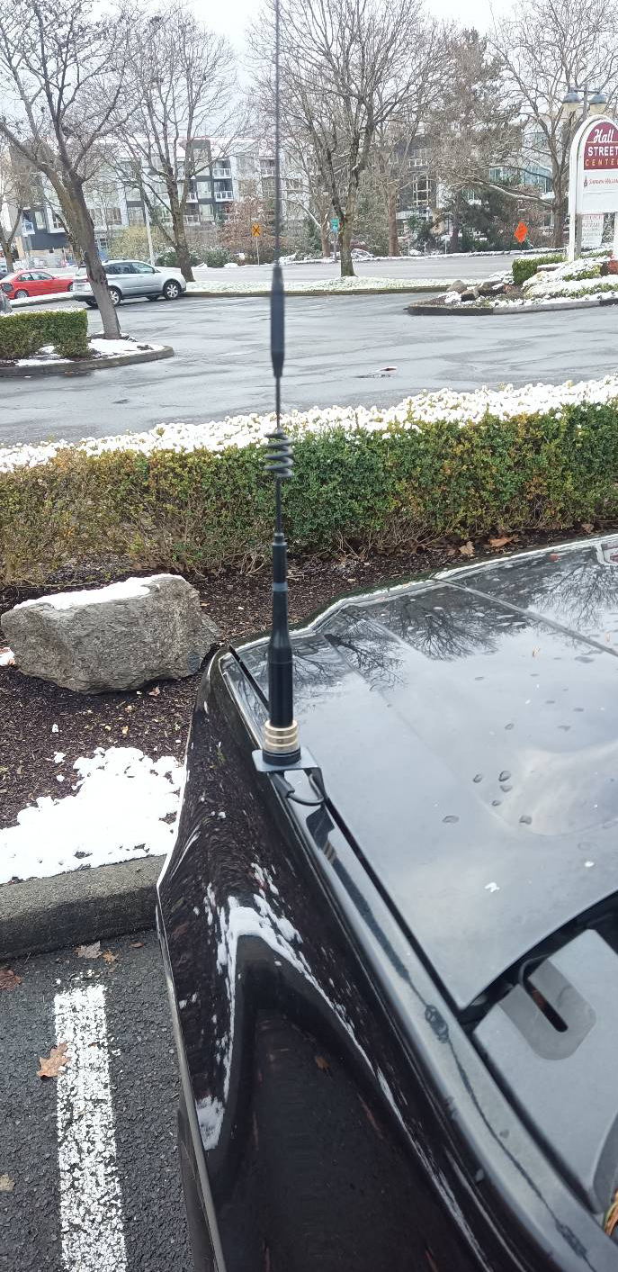

I still haven't had time to drop the headliner and install a nmo. I did do a half asleep purchase on Amazon for a fender mount lol my only gripe is that it mounts way towards the front end of the truck and not closer to the firewall where there is a hole from the factory
May I ask how you ran the coax into the cab from the fender mount ?

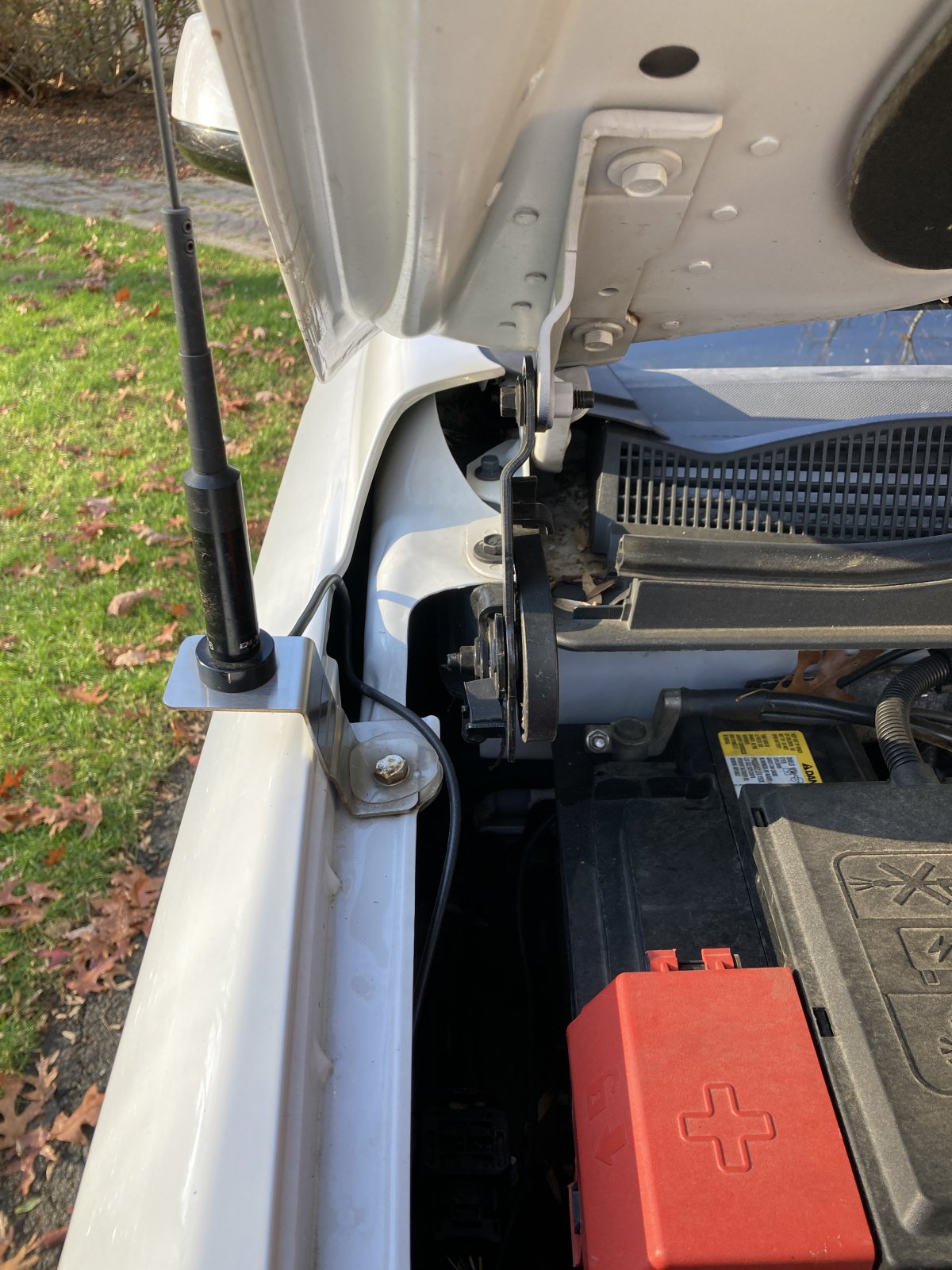

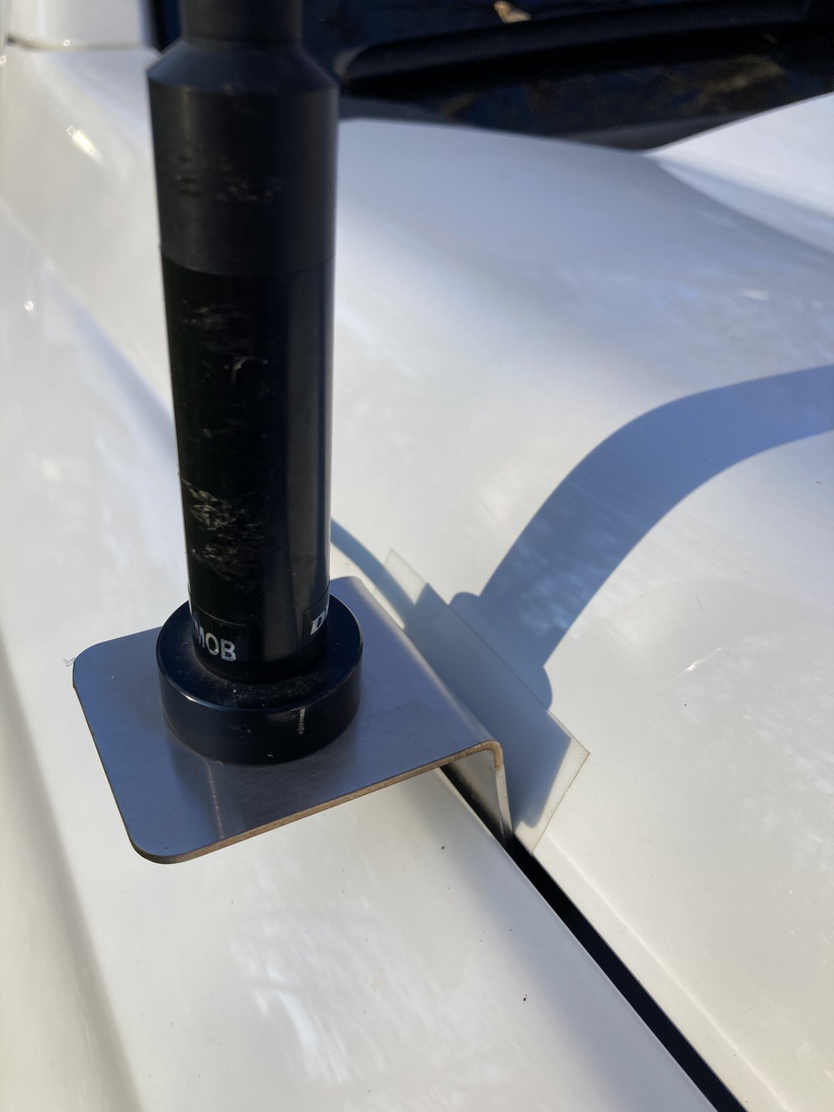

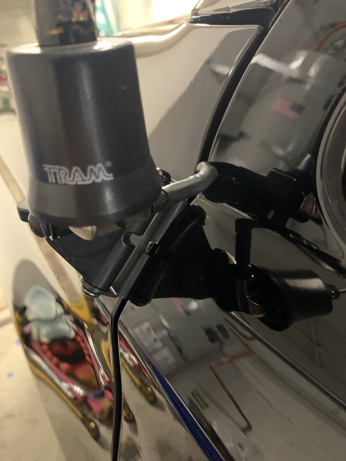

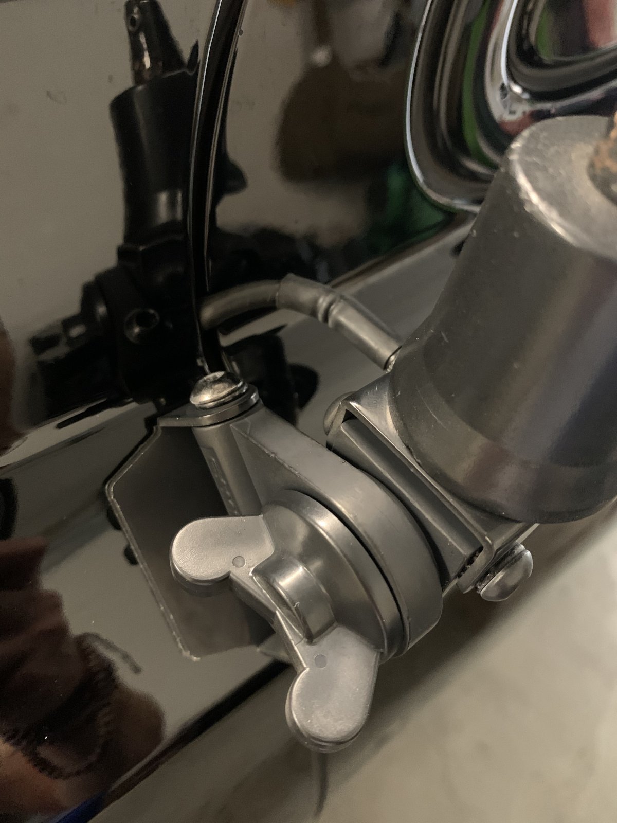

This is how my 2018 Yukon XL is configured. The mount is a Comet CV2ANTNCG (https://www.dxengineering.com/parts/cma-cv2antncg). I already had several of the Larsen NMO mounts. I do want to add a ground strap to the mount.
I have cut a few sections of clear PPF to protect the paint where the mount could potentially rub. Performance has been satisfactory. I'm too often traveling with a Yakima-branded photon torpedo on the roof to have a roof-mounted antenna, though I'd much prefer that. I do have power directly fed to the radio from the internal drivers-side fusebox.
Happy to answer any questions about it. 73!

I didn't want to put it so much in my field of view. It didn't seem out of the ordinary to put it where I did. It continues to operate just fine, in my experience. My VNA approves of it.

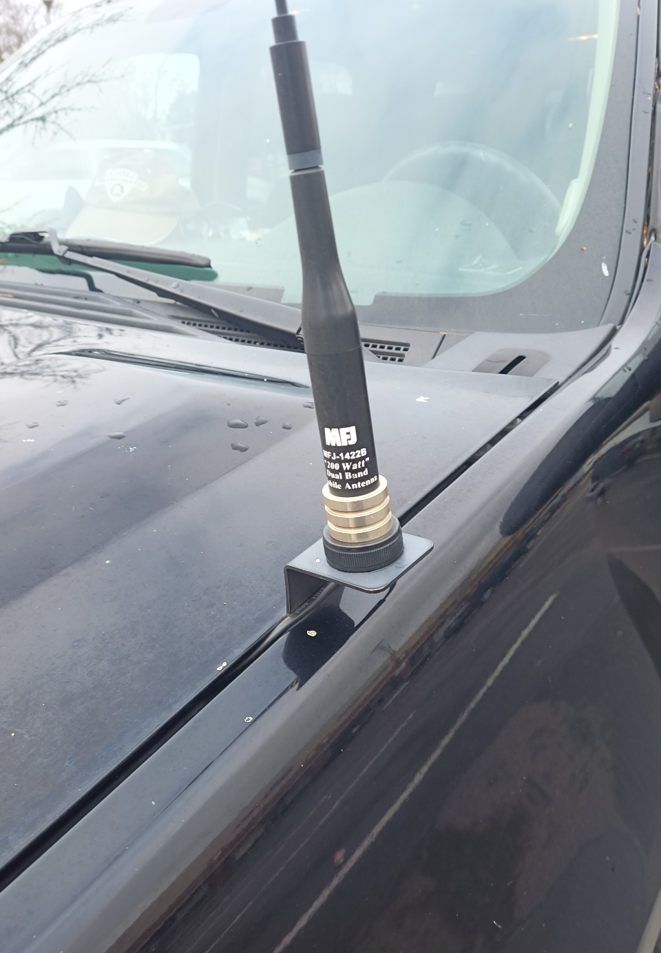

I put mine on the drivers side mostly because of the shorter coax run. It's not that much shorter really but I don't see why it can't go on either side. Just personal preference. The fender is a better bet for a decent antenna though. Number one, you can get a fairly full sized dual band on there. (mine is an MFJ-1422). Number two, anything beyond a stubby on the roof will likely hit things. I have two NMO Mounts up top and had a 16" Tram up there. One day it took a hit in parking garage and slightly bent the roof a bit. That's when I went fender mount. Now I just have a stubby up top for GMRS.
