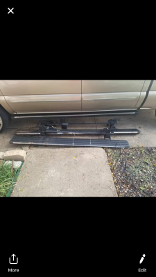

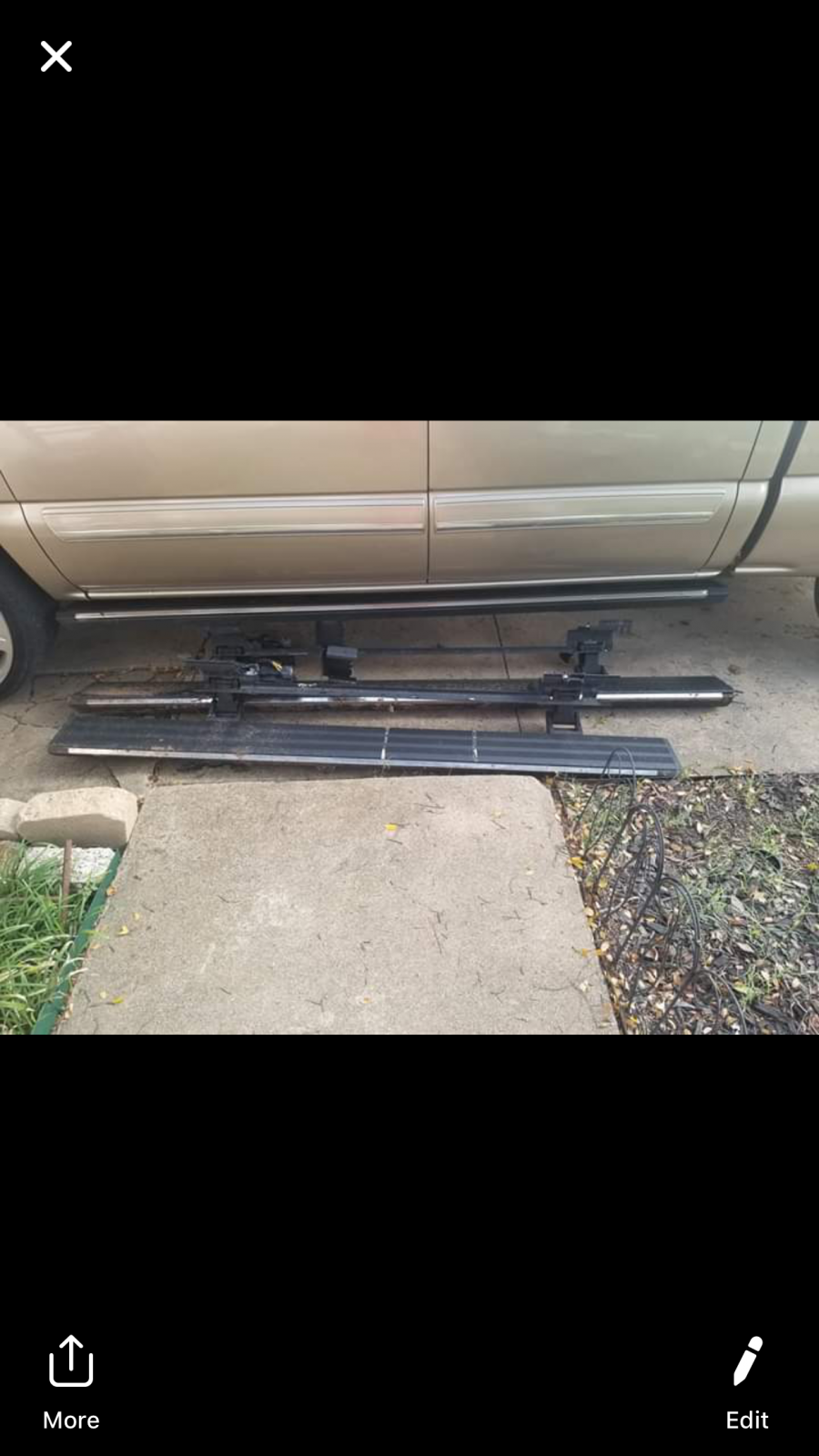

can suburban or XL electric running boards be trimmed down to fit a Yukon or Tahoe without issue?
33,344
51,834
Have a pic of one of those boards? If these are the boards I'm thinking of--yes. The brackets underneath are adjustable and the plastic end caps come off--so you can cut, adjust and reapply those plastic end caps.
33,344
51,834
Kind of hard to tell exactly from the pic. Looks to be some stainless trim along the sides of the running board? But...I'm pretty sure they can be trimmed to size.
