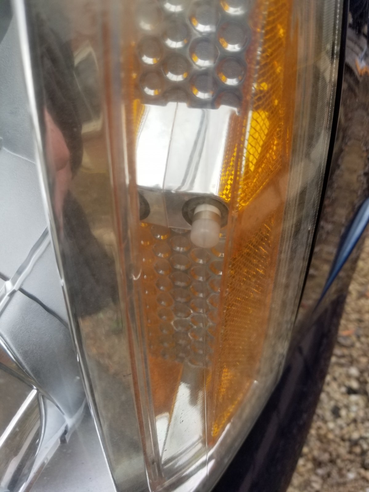

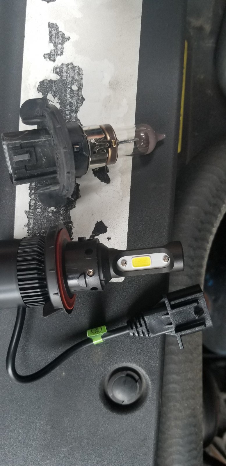

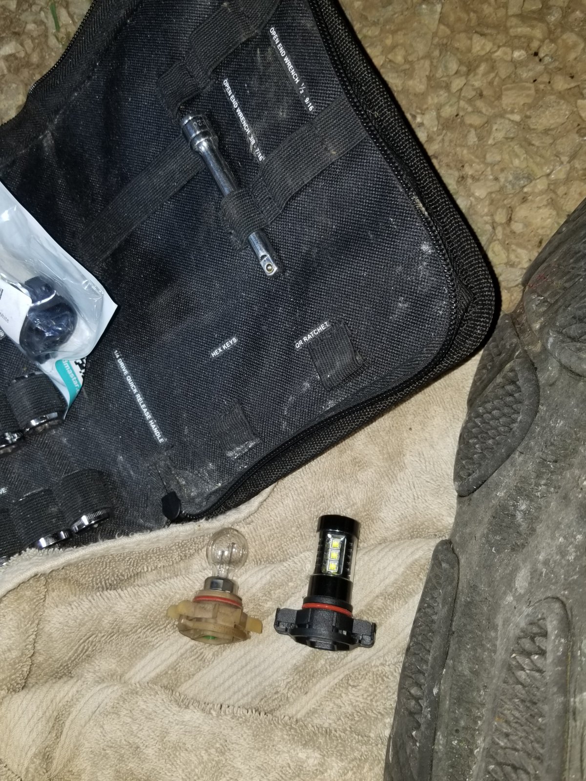

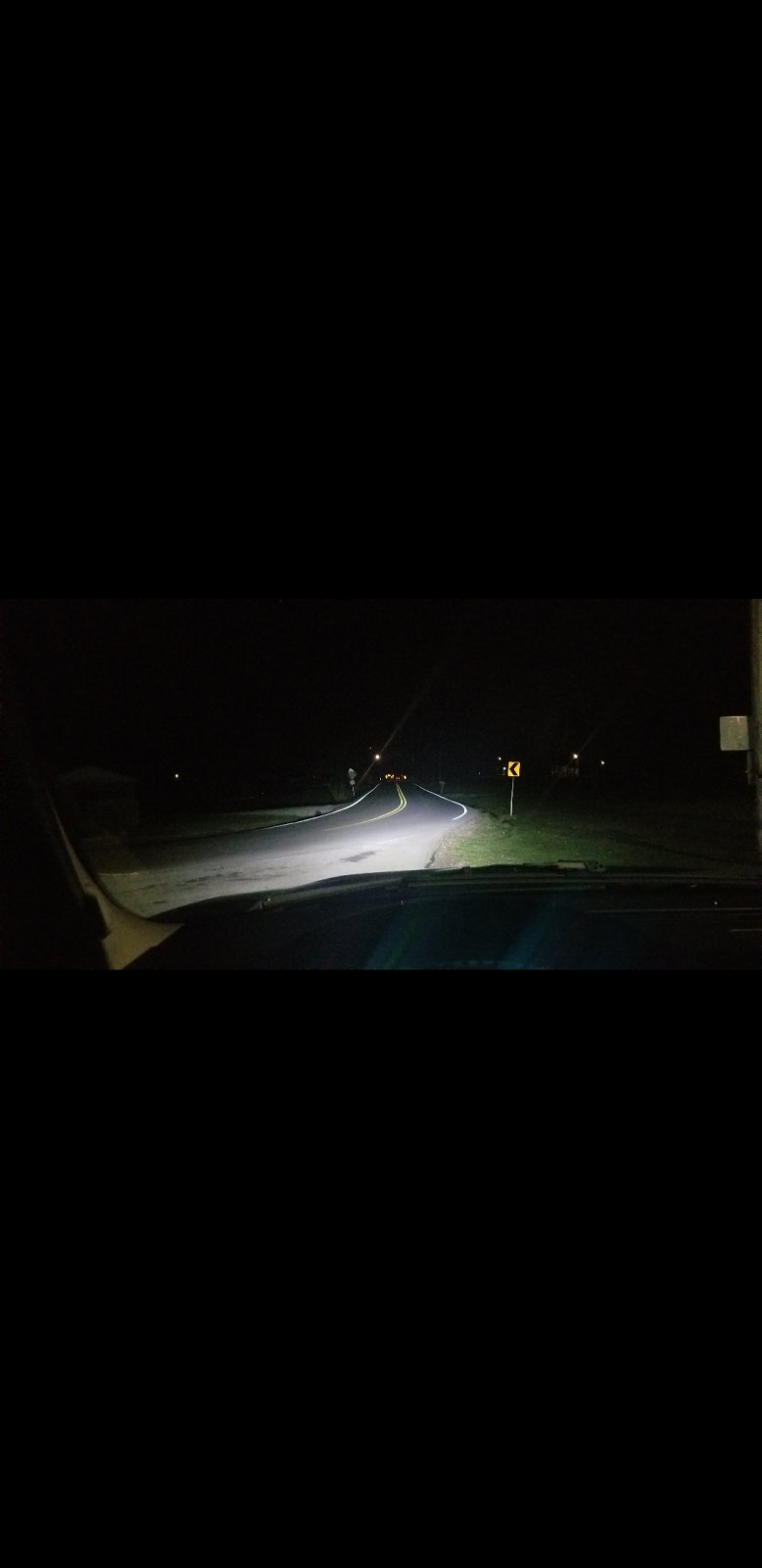

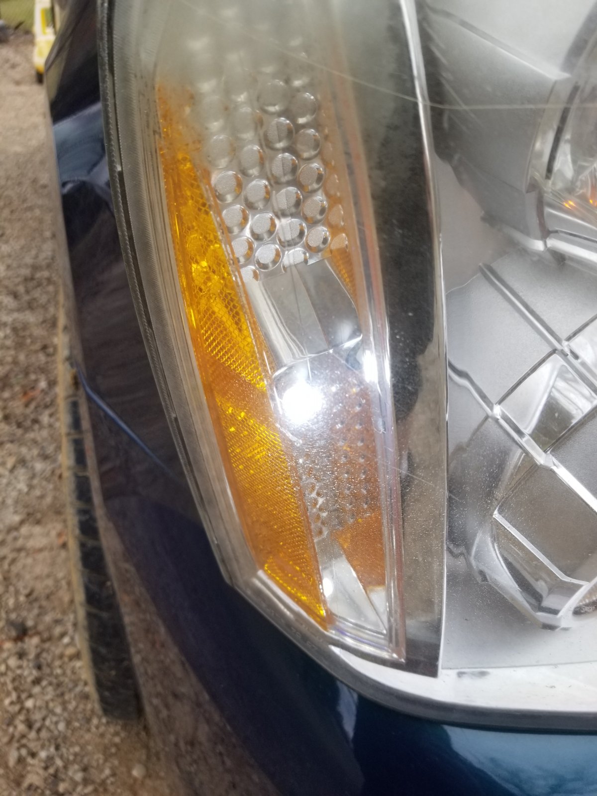

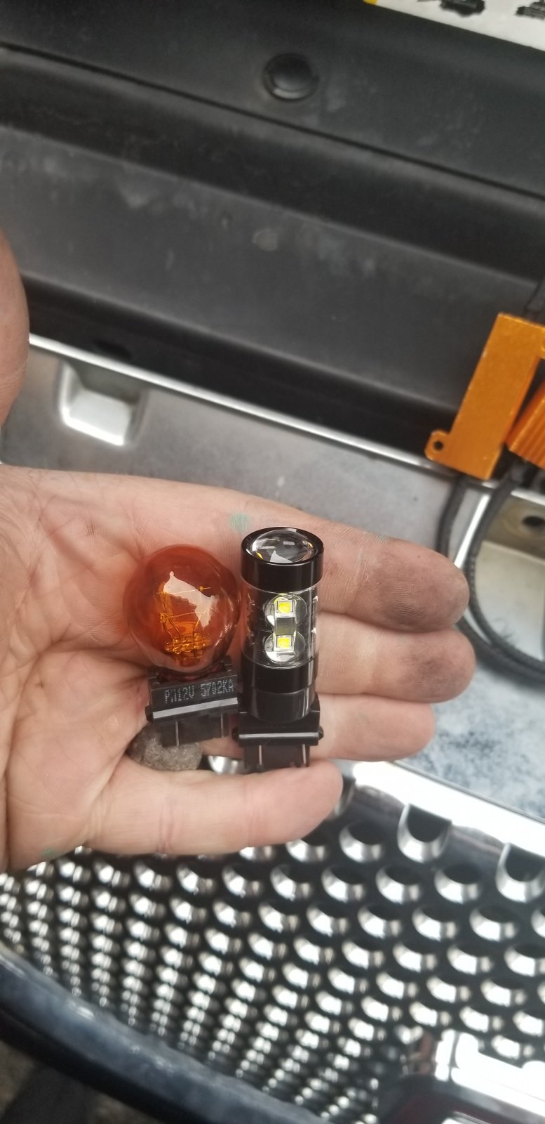

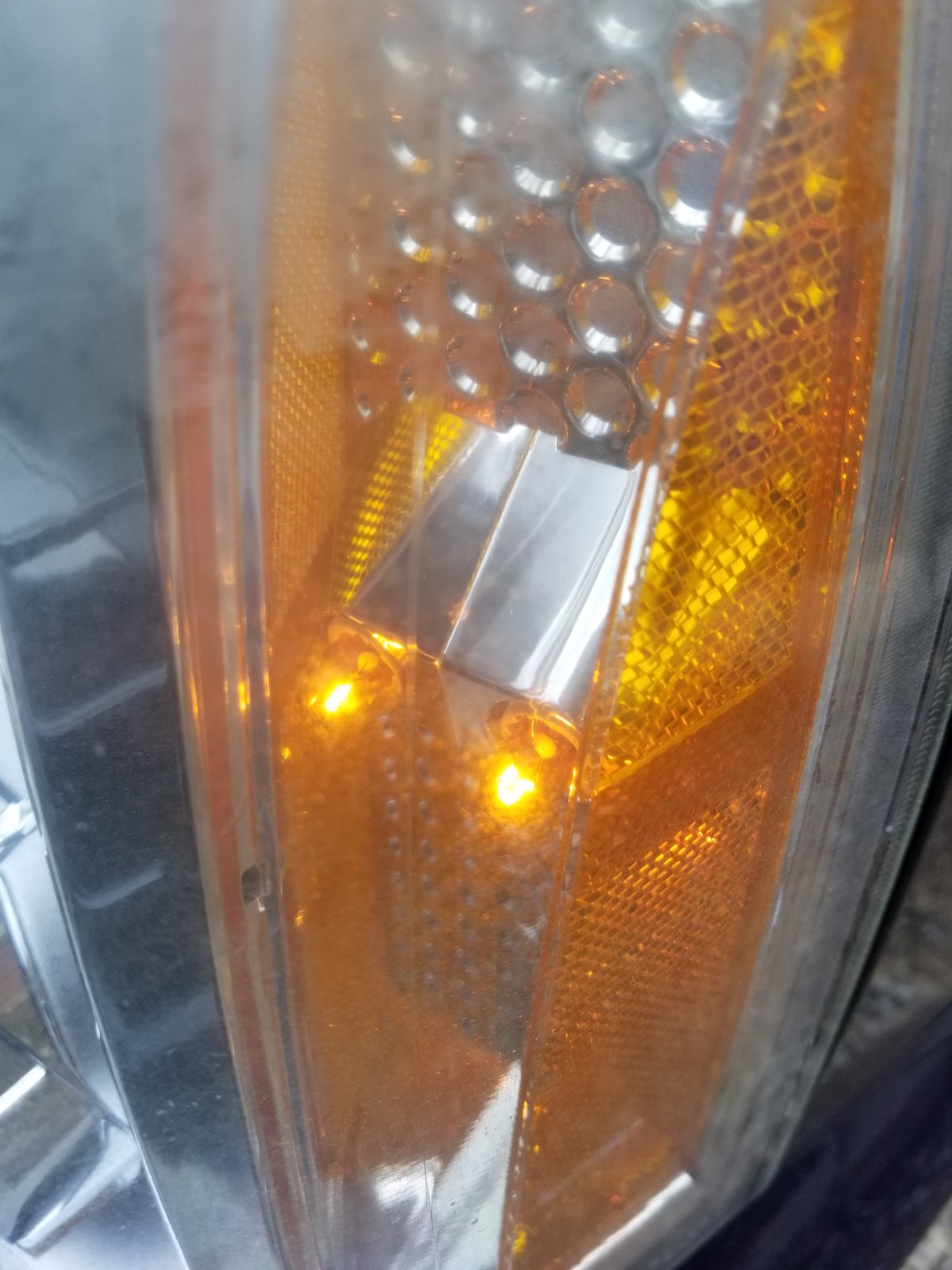

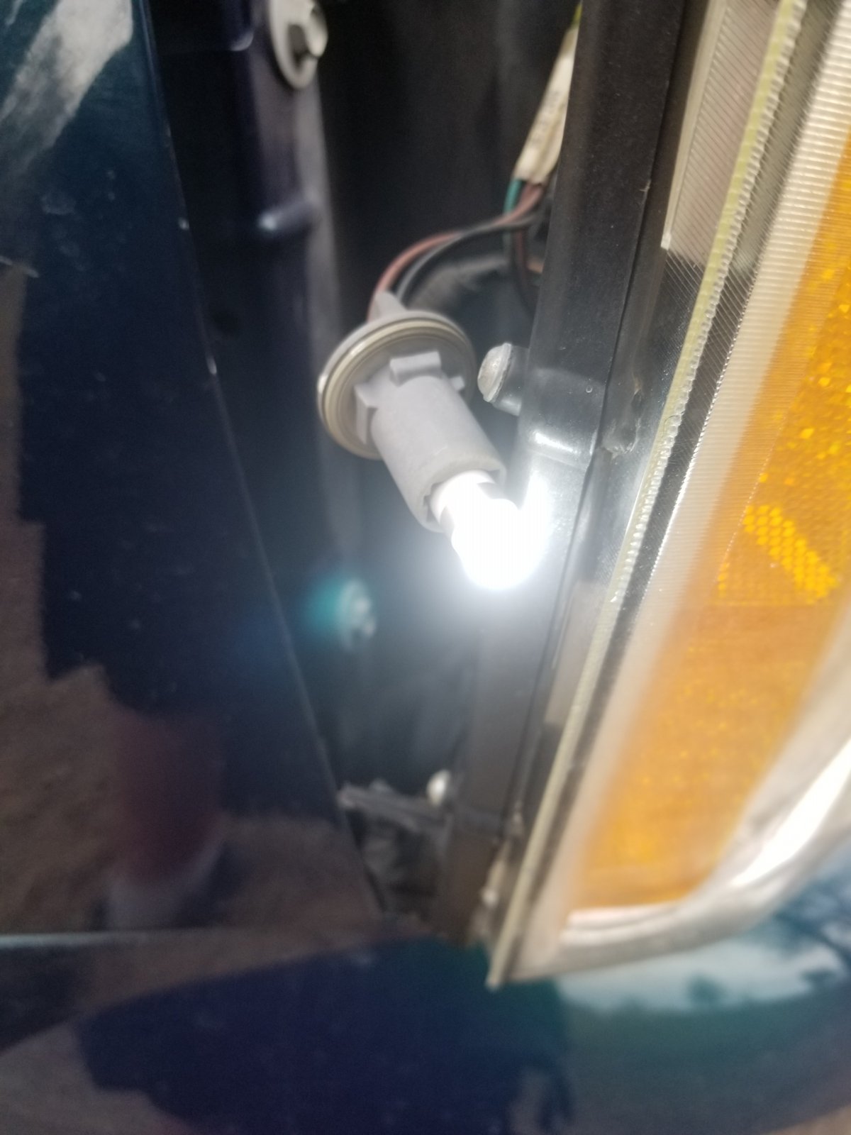

I purchase JDM led headlight and installed them with no problem no cutting, no modification I also got fogs, (should of got the headlight 1s)has any1 tried those) turn signals, and side markers
B4
After
Yes every1 will hate me but my front windshield is nano tinted.

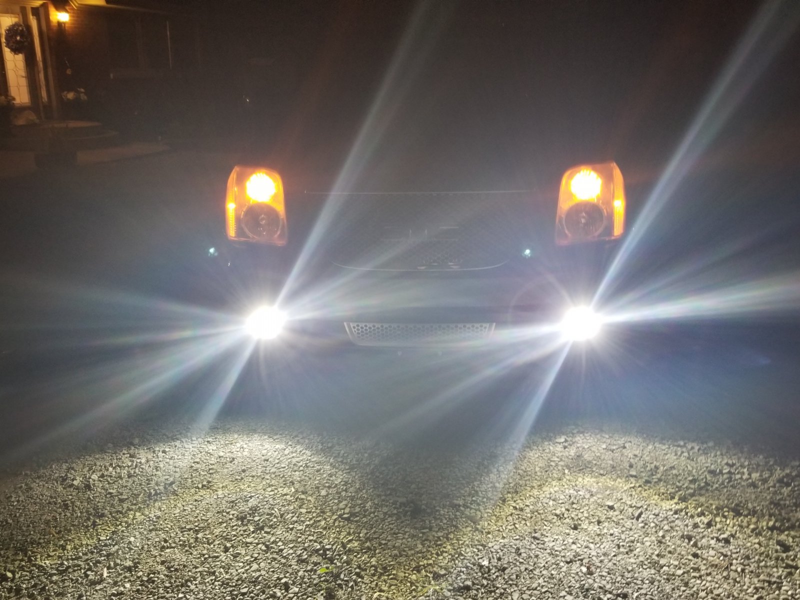

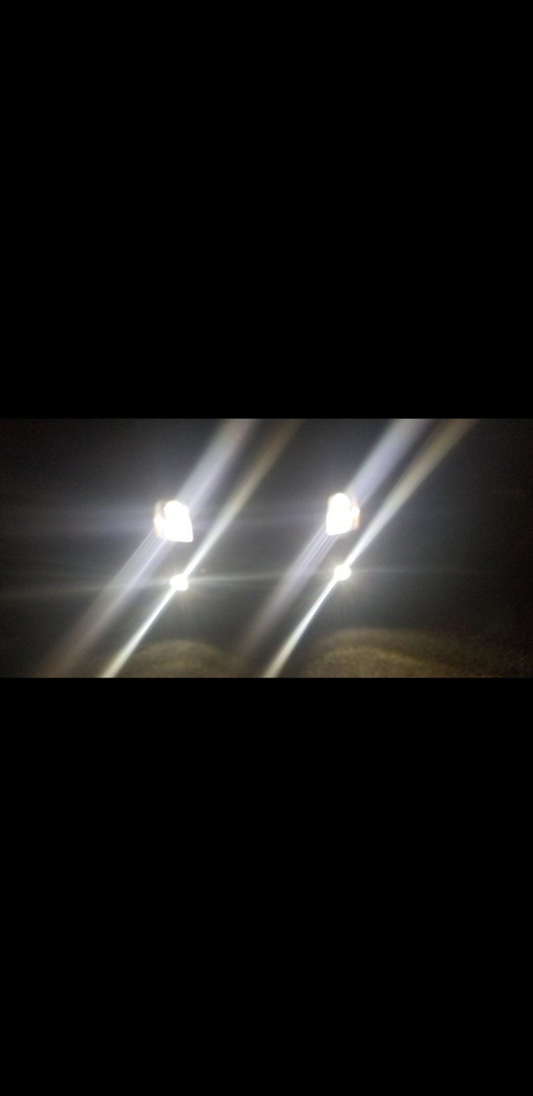

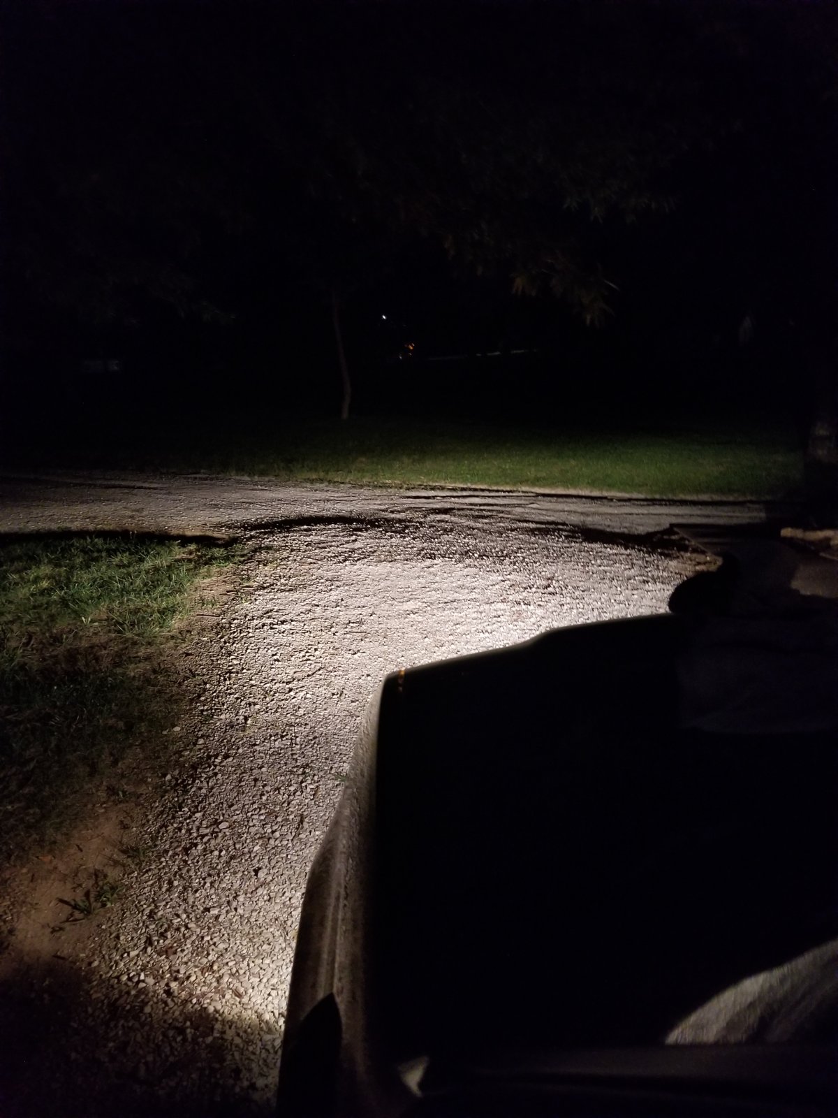

Fogs could be better
Has any1 have the other 1s that look like headlights for fogs
Just fogs, needs to be better

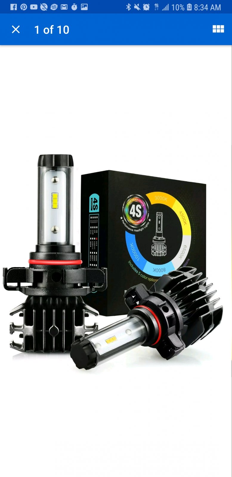

These r the fog headlights I'm talking about. Any1 know these fit and work

My bad on the price of the fog lights in my thread, as my actual cost at the time was $60 (I just corrected that thread). It looks like the price of this specific fog light is now $69.
From that corrected thread for the fog lights: For the fog lights, which were the 5202 incandescent spec, I used the following: JDM Astar LED Number 2G 5202 5201 Fog Light CSP (white is the only available color) ($60 per set of 2) (Note that I had to slightly cut down a protrusion on the plastic bumper housing behind the fog light lens assembly with a hacksaw blade to fit the LED into place, but the modification is completely invisible and took about 2 minutes each to accomplish.)

So do they go far out like normal headlights, cuz I bought the less expensive 1s, they r actually fog lights they only go so far like 10 or less infront of truck

Yes, the LED fog lights to project out in front of the truck for a short distance, but being fog lights, their primary purpose is to provide good illumination and visibility in the short distance in front of the truck.
