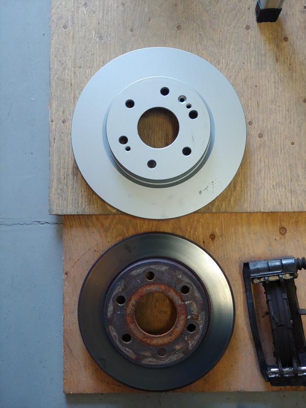

- Raybestos Element3 coated rotor 582458FZN (13.5") x2

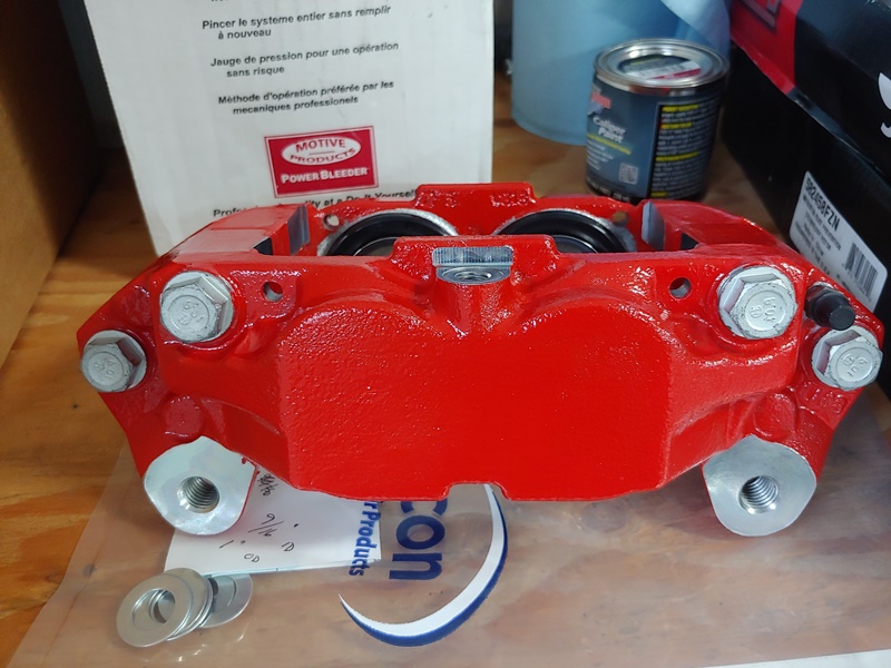

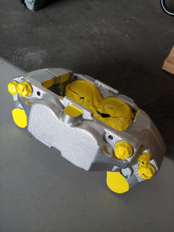

First step was to scuff the new calipers and then paint them with 2 coats of POR15 red caliper paint :D ... total vanity move on my part, but I like the look of the Chevy Performance Brembo brake kit, especially on a black truck.

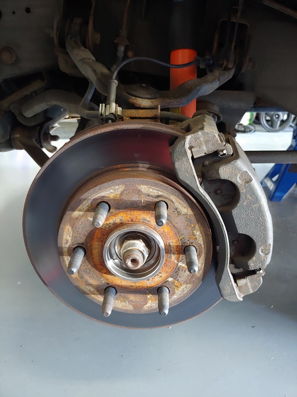

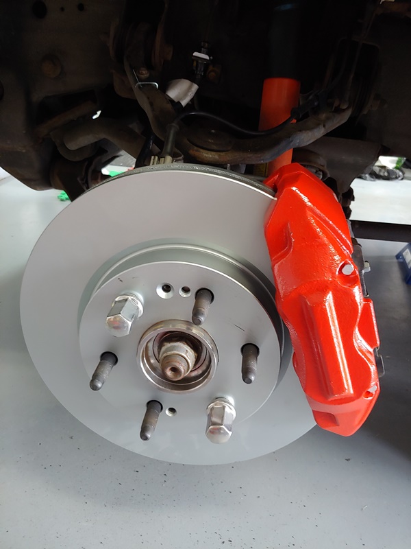

Next step was the removal of the old components and installation of the new. My truck came with updated GM wheels ... previous owner installed 18" wheels from a 2014 Silverado ... this impacts how many spacers I can run on the calipers before the caliper rubs the inside edge of the wheel. I experimented with a number of thicknesses ... 3mm of spacers was the best option to centre the caliper on the rotor, but that resulted in a very slight rub between caliper and wheel. I ended up going with only one 2mm thick spacer at each bolt mounting hole. I think the pads should be self-centering seeing as how there are independent pistons pushing on both sides of the rotor ... I can't notice any rubbing noise while driving, so looks to be okay.
After parts install, I removed all the old brake fluid from the reservoir, installed fresh DOT3 synthetic fluid and bled the whole system using the Motive Products power brake bleeder tool.
