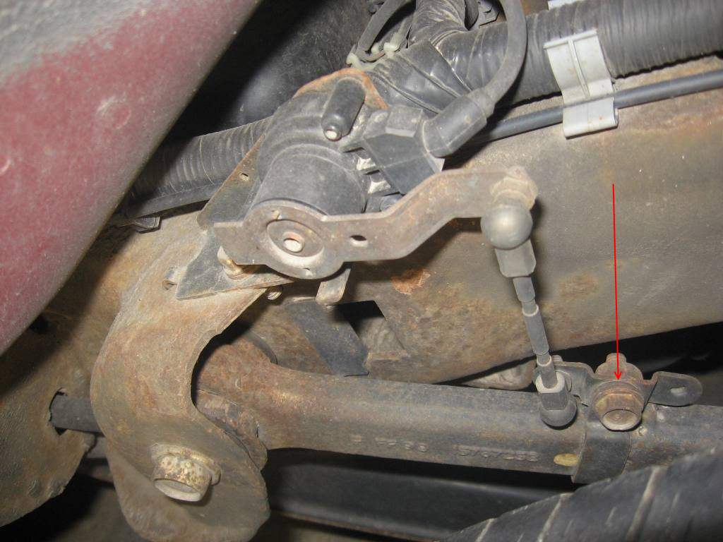

I'm not 100% sure but logically I think if you put regular shock extenders on the rear autoride shocks and then make some little brackets to effectively extend the links on the ride height sensors then everything will continue to operate as normal just 2" higher (or 1.5" or whatever your spacers, extensions and custom brackets work out to). Because it's further up the control arm trigonometry dictates you don't need quite the same length as your spacer. You'd have to figure that out. i.e. For a 2" spacer you might only need a 1.5" adjustment or extender on your ride height sensor arm.
Look for the device in the attached picture on your rear control arms. There appears to be some adjustment in those links but I'm not sure if it will be enough.
If not you could get something like a length of 1/8x1" bar steel from home depot you could unbolt the lower bolt where the red arrow is and just make a piece of the steel with an appropriately sized hole in each end. Make the bottom part long enough so that it butts up against the control arm when bolted in place so that it can't rotate and then reattach the rest of the factory bracket to the top hole of the extension bracket that you made.
In the end you'll be making the system's new neutral point at the desired higher height and it *should* operate as it does now just 1.5-2" higher.

sorry to tag onto this post. i've been searching for some answers and you guys are on one of the topics i'm looking for. i've read it can be done but can't find how to do it....adjust the autoride links in the rear. i'm completely stock now (2013 LTZ) and trying to get the rear slightly lower. i would love 1" but not sure i want to change springs etc. my question is, it appears you can possibly slide the lower bracket piece of the autoride link and if you were to move it towards the rear of the vehicle it would essentially shorten the sensor and acheive a lower ride height (slightly). I tested it and kept the seats out of the back and ran it very low on gas. then i filled it up, installed the seats and that alone brought my back end down about 1/2"....of course, autoride/autolevel brought it back up. how can i make it to where it doesn't bring it back up?

i'm wondering if anyone has slid the clamp or whatever it is that attaches the bottom end link to the suspension further to the rear to effectively shorten the travel distance and hopefully lower the ride height. again, even if i could get 1/2"-3/4" that would make me grin a little. i'm thinking this can be done and has to be why other ltz's ride at different heights. i've seen some that look almost level and i've asked if they did anything and the owner (typcially a soccer mom in my parts) looks at me like i'm crazy.

looking at the picture attached above, i wonder if you could put the lower end in the hole on the opposite side of the bracket?

can you not cut the pcs..unthread...or rethread it once shorter?

It looks like there is some adjustment on those links. Pull one end off and see if you can screw the ball socket in some more. If that works it would be reversible if you didn't like the results.
It might wear your springs a bit more over the course of 10s of thousands of miles to have more load transferred to them but I doubt it would be a very measurable reduction in lifespan.
If they're not adjustable go to the junkyard and pull the ride height sensor linkages off and cut those down then just swap them in.
