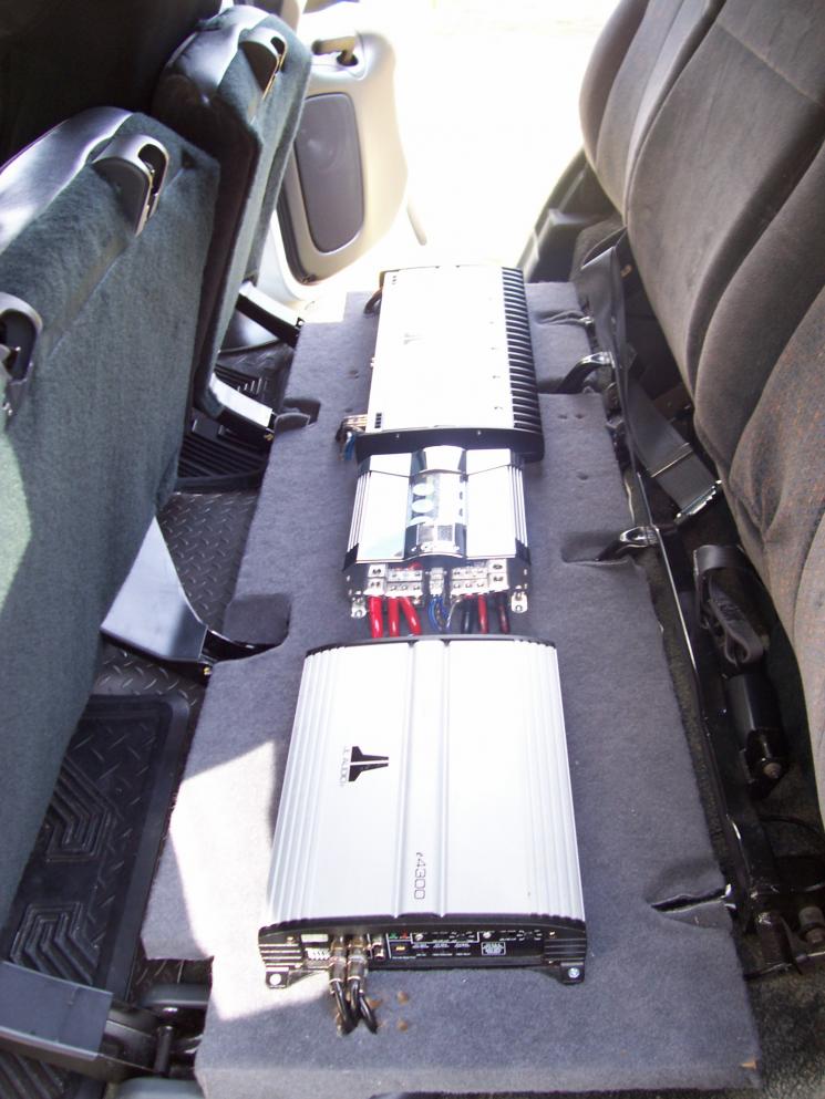

This where and how I did mine!

Thats how i have mine as well. I used two pieces of 1/2 mdf stacked on top of eachother on left and right sides of the amp. Put it on the driver side so i can still fold down one of the seats and let it sit all the way down. The first piece was screwed into the floor with a lot of caution cause the gas tank was right under it, and i wasnt sure how close the tank was to the floor board. Then the amp was screwed into the bottom piece through the 2nd piece.

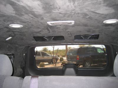

I flush mounted mine in the headliner.....heat is not an issue... I ducted the rear air conditioner to blow on the amps under the headliner......absolutely no loss of useful storage space!

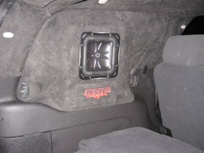

.. here are my subs! I have 1 8" L7 Kicker mounted in hand layed Fibergalass enclosures that were molded into the rear 1/4 windows.....I bought my SUV for space, so why waste it on mounting audio

Sweet, Is that 3/4 MDF board? And did you just screw it into the floor or did you use bolts to the seat frame?
Yes its 3/4 MFD, and I used angle brackets screwed to the frame,didn't want holes in the floor board. Plus Matt is right didn't wanna take a chance with the gas tank being so close to the floor board.
