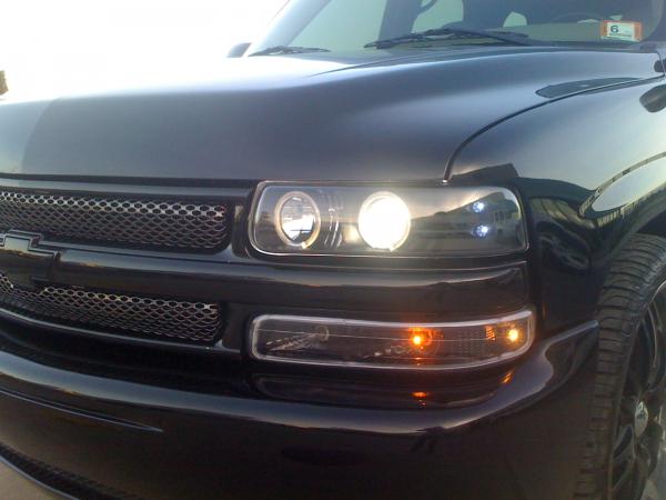

So, I have recently updated the front of my 04' Hoe. She now has DEPO Projectors, Hi/Lo DDM HID's, and Clear Bumper lights(ebay). I am very happy with the way things look....other than the amber running lights.
So,my here is my question. Can, I clip, snip or mod anything that allows the blinkers to still work(and flash amber) with the lights being on full time.
Also, what to the sidemarker lights do? I have never seen them on.
Any help would be greatly appreciated.
BB

JD, nope, I am still confused. I have some amber bulbs (3157) and new 4114's for the DRL. I also have new sidemarkers, although I did not put those in yet. I guess my confusion comes from WHEN/WHICH lights activates. Perhaps you all could help me fill in this list.
Highs - obvious
Lows - obvious
DRL - inner most bulb in the bumper light right? This should come on on Auto/in Drive/during daylight?
Blinker - always on? Flashes when blinking?
Sidemarker - ?? like you said it flashes alternatively with the blinker. Not sure mine does :-(
I am col with all except having an amber light glowing all the time....unless of course I have to.
BB

Ok now I see what your saying but it seems you have some wiring issues. The amber should not be on all the time and the sides work together with the flashers.
DRL either 3157 or 4114 only on in auto daytime when car is in drive
Blinker only on when turn signal is on
Yup I think the wiring is the problem or check the bulbs and fuses
Good luck

Highs - obvious
Lows - obvious
Blinker - no such thing
Sidemarker - doesn;t have one
BB
from inside out
drl - discussed above
parking / turn bulb: comes on with parking lights. A second filament lights up to provide turn indicator.
corner marker bulb:
a: Comes on with park lights as a parking light.
b: when park lights are on, flashes alternate to turnsignal
c: when park lights are off, flashes same time as turnsignal
So unless you have amber DRLs or a PO tied the DRL to the park circuit on the front signals, I have no idea why you would be seeing amber except at night.
Personally, I run an amber 4157/3157 as a DRL (and as turn of course).
I didn;t like the weak sauce yellowy light from white bulbs. the amber both looks cleaner, and looks different enough to still attract notice from jaded commuters. When I flip to high beams with the Hi 8 I get all amber across the indicator.
For the record:
It is a-ok/ legal to have amber DRLs (vettes do), & ok to have white parking lights, but it is NOT ok to have white illuminating turn indicators.
since turn and parking bulbs are combined on our Tahoes, you need to run amber parking lights.

Ambers put in proper place. Side-markers changed out....and yes they now work! Almost there. Amber/Blinkers stay solid when on....still a mystery. Ohwell, looks good for now.
I am digging the cleaner than OEM front end. Will snap some pics tonight. 4 Hi is the shizzy.
To HID the fogs or not to HID the fogs, that is the question????
