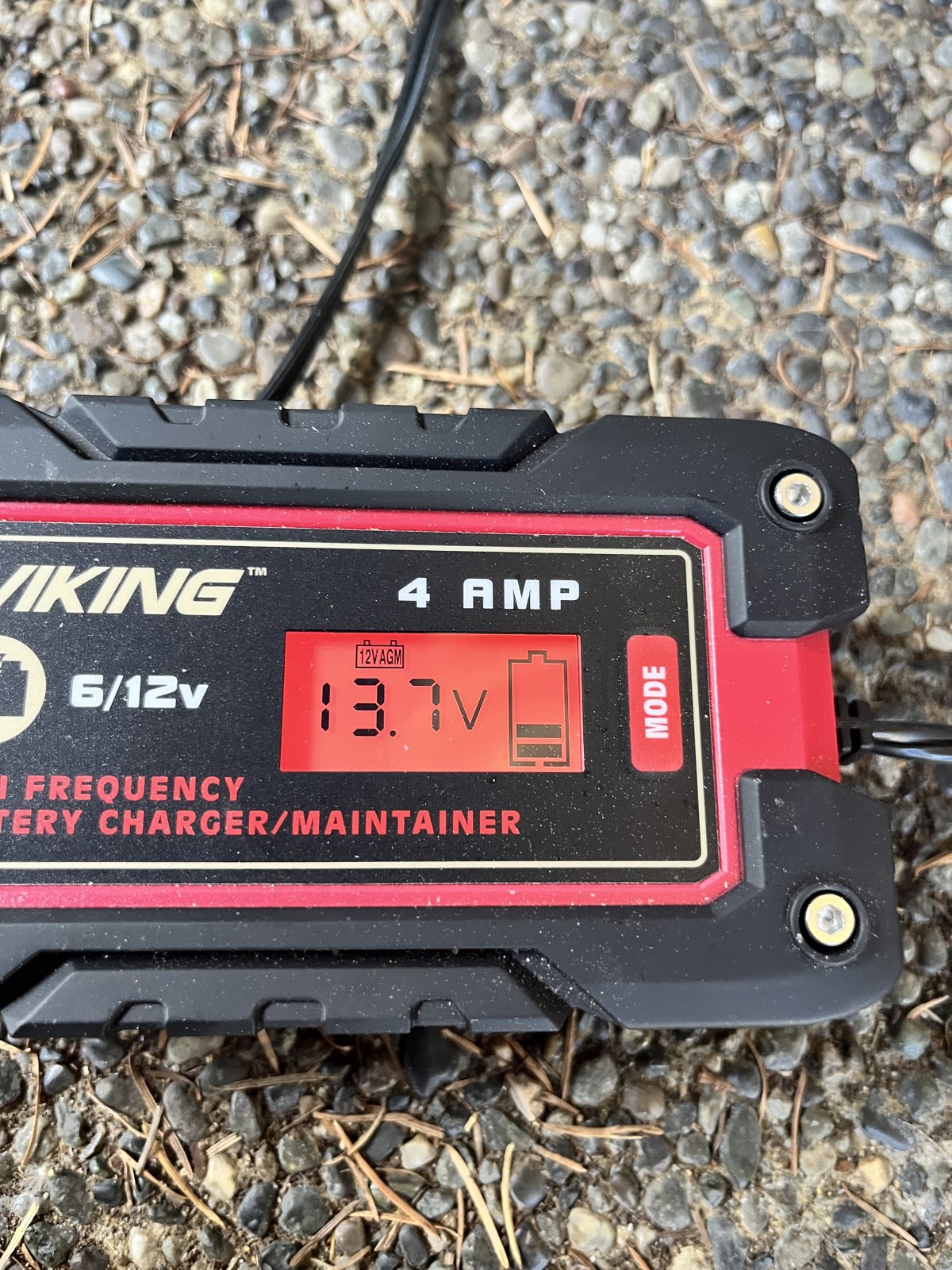

Ok, about 6 months ago, I replace the battery in my 2015 Yukon SLT.
I changed it because I was having issues with the infotainment system, plus it was the original one.
We have been having issues again, so I am looking at it today.
I checked the battery voltage and it was 12.3v.
So I hooked my 4 amp battery charger to see what would happen.
It jumped to 13.6 and the indicator showed the battery was half charged.
I am fairly decent at understanding electrical, so on leaning towards the alternator not charging properly, I don’t have a tester.
My wife drives it daily, and it hasn’t failed to start since I replaced the battery.
Anyone else run into this?

If you powered up (110v) your charger when the voltage went up, that's the charging voltage. But if your charger reads voltage without AC, then I don't know what to say.
Short trips don't allow for the charging system to completely fill the battery, so if your wife's trips aren't long enough to get things charged up after starting, you might want to consider taking longer drives.
