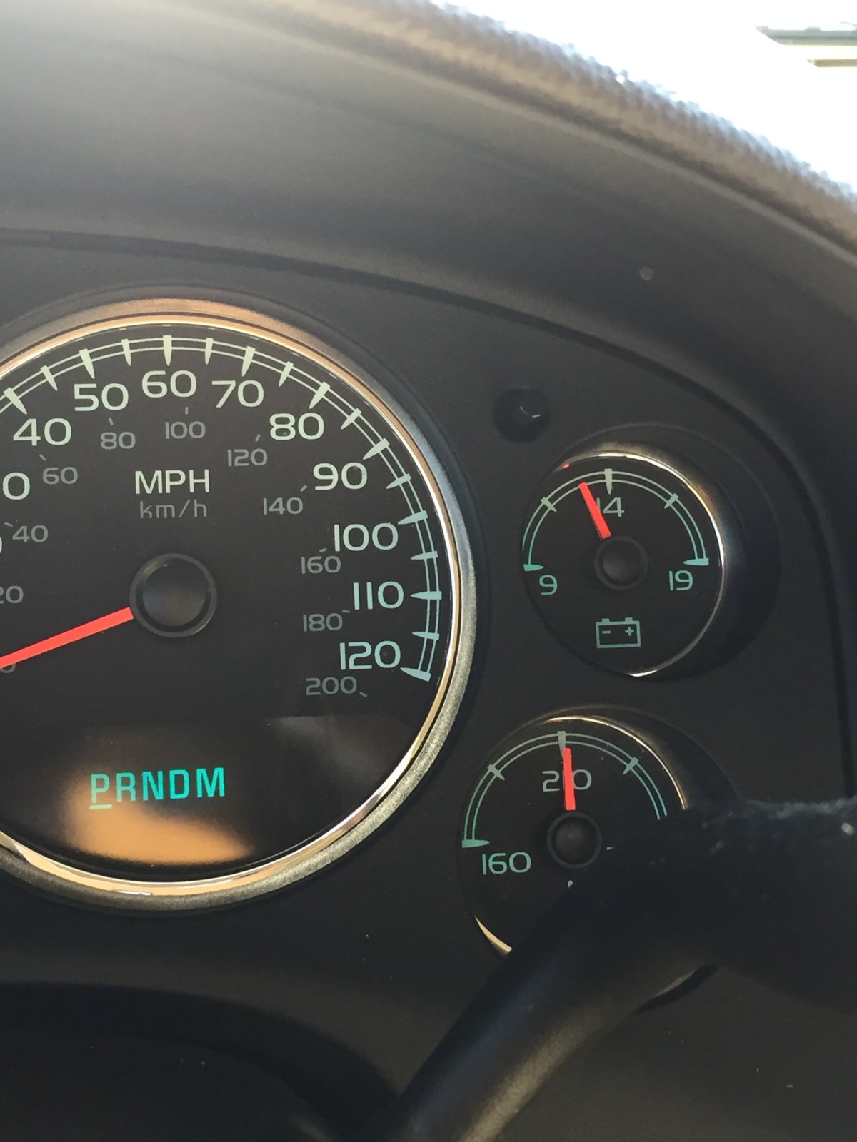

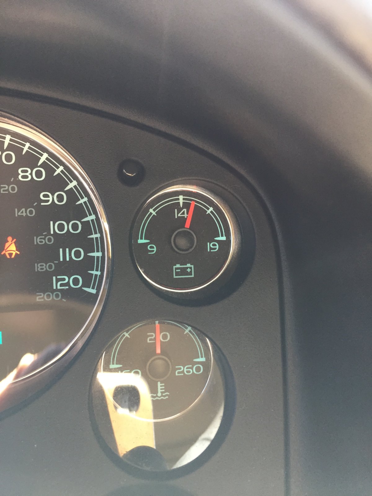

Hey everyone, before I drop some money on parts to chase this problem I thought I would see if anyone has seen this issue or some suggestions. My thought at this point is to swap Alt. Prob started about a year ago very intermittent where the ammeter would show a discharge while driving but when you turned off the key and restarted problem went away, now its here all the time. Putting a meter across battery I get 12.6v Start vehicle and get 14.+ which drops down to normal within a few minutes. Once you start driving the voltage on dash drops. I have measured volts while running and it is discharging and I am getting 12.85v while charging which I thought should be 13.1 min. I had a couple different auto places check and got a response that battery had 1/4 life so I took battery and swapped for new 42 mo Delco at dealer. Still having same issue. I cant see spending a hundred or more at dealer if I can put that towards new Alt. This is a orig Alt in a 08 Denali with 82000 miles. Any diagnostics I might be missing or suggestions would be appreciated. Thanks for any help

Its normal for these trucks. Its called rvc. Regulated voltage control... basically shuts alt off when cruising but turns it back on when needed. Its to save gas... i know sounds crazy but its true. Look it up. If you have a tow haul button, leave it tow mode and it turns it off. Or, on your neg battery cable is a small electronic current sensor and if you disconnect it you should keep a more steady voltage.

I have heard that but first time I have seen it in 3 yrs. With 100 deg heat and around town driving I didnt think it would be conserving but maybe overworking.

ya mine does it as well even with two AGM batteries, don't like it but whatever......GM

So does your guage look like mine? I wont be so worried if I knew someone else looked the same. Also I would like to see some pics of your dual battery setup. I have been wanting to do a dual battery with isolator for mine.

yes my volt meter will vary, I have the stock 2 battery setup just like the ppv's, all you need is the battery holder which is the same as the on the nbs's and the battery cable and then it's cheaper to make your own ground(s)

I've owned mine since new. Now has 225K on it. It has always done that and I've never liked it but that's the way it was designed. Like the AFM, it's another attempt to hit those EPA mpg numbers. Don't worry about it. It's normal.

In the first place it is a "volt meter" Not an Ammeter,. It does not show charge or discharging, just how high the voltage is. The battery requires different voltage depending mostly on how low the battery is when you are reading it. In cold surroundings it needs to be higher than in warm ambient also when you used a big gulp of power like right after a start it will give a higher voltage to recharge the battery fast and soon goes to a maintain voltage. All this compliments of the computer. Gives longer life to the battery and slightly better mileage, in other words don't worry, be happy, it is very normal.
