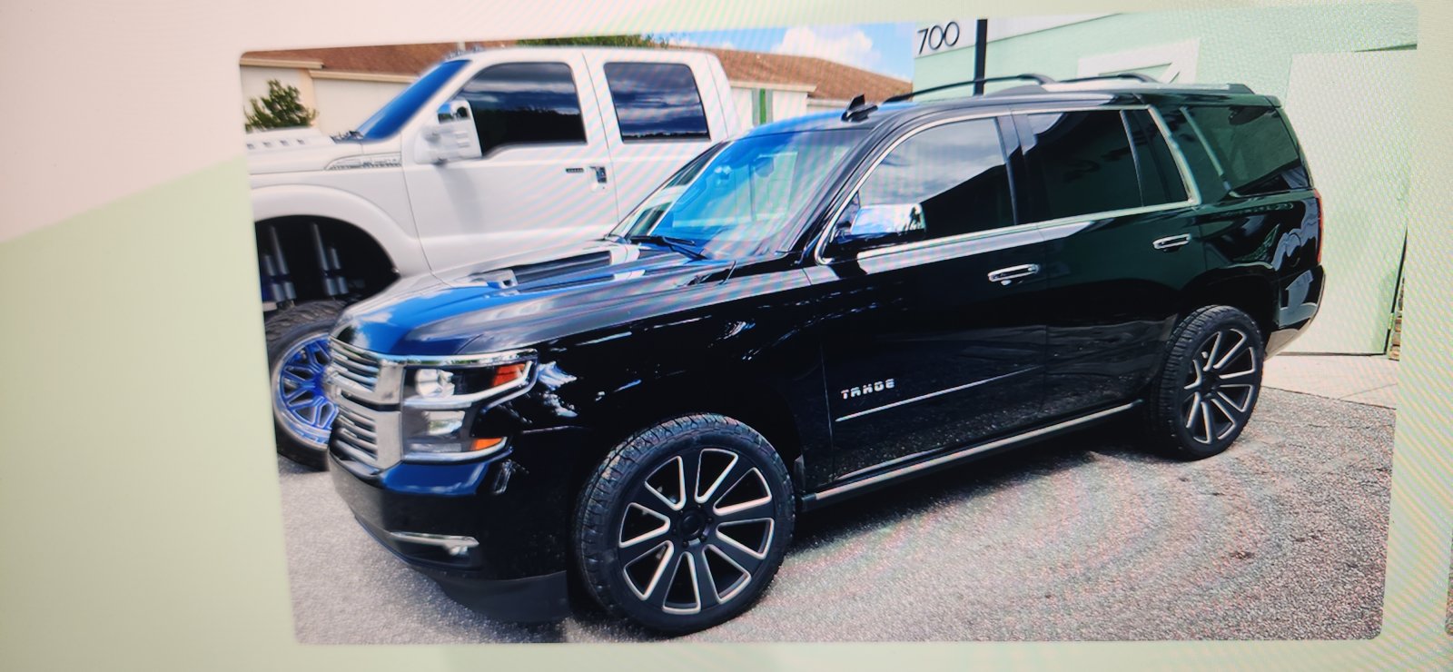

Contact " FARMBOY Custom Co." in West Palm Beach. (561) 795-2165. Chris will answer the phone.
( I get my work done there... they know their stuff)

I just have the 1.75-2" lift via Bilsteins, not some crazy 8" mall-crawler build. Would his info still be applicable?
